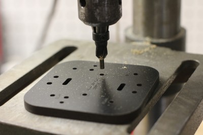

<strike>Last night</strike>Friday night I started building. I had two friends help me peel all the tape off the melamine and press in the nylon locknuts. That part went pretty fast.
I am going to experiment with some small departures from the official instructions. I.e., I'm going to do it wrong. (-: Or maybe I'll find some things that make it easier for the next guys.
To start with, I used a drill press and countersink bit to countersink all the holes instead of snapping the melamine disk out. One of my tape pulling friends suggested turning the drill bit upside down. That way, the smooth shaft goes into the existing hole and does not remove any more material. Here's the countersink stub.
Upside down drill bit does not bore.
I set the drill press's end stop so that the countersink stops at the correct depth. Here are two photos of the countersunk hole.
Freshly countersunk.

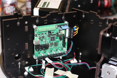

I decided to mount the RAMBo early on. As soon as I finished the first tri-support assembly, I put the RAMBo onto it.
Why do it that way?
It's easier to screw in. Don't have to reach in through the door.
I can trim the motor wires to match the actual distance to the headers on the RAMBo. I'll leave about two inches of slack in each. That's cleaner than leaving big coils of extra wire. I'll also trim the power supply wires with maybe 6 inches of slack.
Why was this a bad idea?
Risk of static discharge or damage during construction. My board is hanging out there in a construction zone. As soon as the table is on, it will be better protected, though.
Any other reasons I should not have done this?

I think originally, seemecnc intended for us to countersink the holes the traditional way with a bit/drill and the rings were just an idication of where countersinks were required. Then they realized popping out the rings worked ok, so they eliminated the requirement of buying a countersink bit. Of course if you have the drill and bit handy, its probably easier to do it "right".

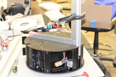

The last thing I did last night was to erect the tower. I happened onto a really slick way to align the uprights. I clamped them to a square. The square is sitting inside the T-slot. The clamp is forcing the upright against the square. Gravity is holding the square flat against the table. Therefore, the upright is square to the table (within the accuracy of the square). I have to push on it to move it to a non-square position, and it comes right back.
Auto-square mode
Auto-square mode
There are still two degrees of freedom, though. There's the height of the upright and how far from the table's center it is.
I adjusted the height with the flat blade screwdriver you see in the photo. The screwdriver acts as a lever with a big mechanical advantage. I could push down the handle and shift the post up with resolution less than the thickness of the etched alignment line. (I hadn't figured this out when I shot the photo, so the post is just resting on the screwdriver there.) Once the height was right, I squeezed the clamp, the square dropped down to the table, I unsqueezed the clamp, and the clamp forced the post into square orientation.
Then the square was holding the post up, and I could release the screwdriver. I pressed the post toward the center of the table as far as it would go with thumb and snugged the screws. It took a few iterations to work out this technique, but I readjusted all three posts once I had it.
Then I followed the procedure in geneb's manual to measure the top height. Except... I used the Birmingham Substantial Alloy Calliper (BSAC). I just couldn't bear the thought of butchering an innocent yardstick. I also wasn't sure I'd cut the yardstick accurately enough.
I put the first Idler Mount on and aligned it. Then I inserted the BSAC and adjusted it so the table and idler mount were both touching the outside of its jaws. I locked the jaw at that position. After that, I used the BSAC just like the manual says to callously exploit the victim yardstick.
No yardsticks were harmed.
Then I used the BSAC to measure the distance between all three tower pairs, both at the bottom and at the top. I got readings of 381.10 to 301.30 mm at all points. I repeated them, and they were the same. I identified the post that needed to be adjusted, loosened it and slid it out about 375 milli-titches. Then I re-measured. No difference. So I called it good. One of my towers is about the thickness of a bee's wing too close. I doubt I'll be able to make the CheapSkates that uniform.

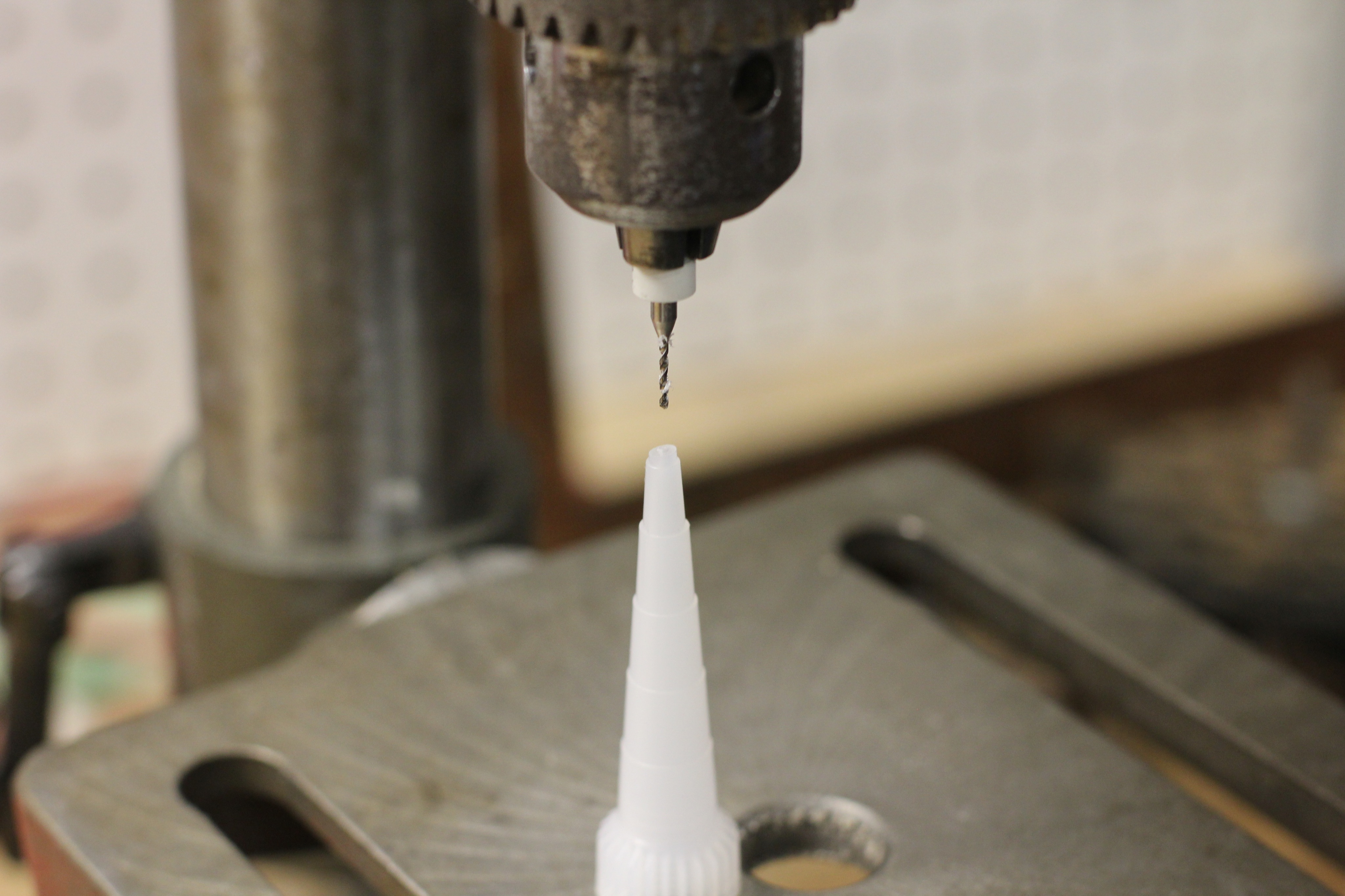

Posted: Sun Jun 09, 2013 2:57 am
by kbob
I just wanted to ensure a good round hole in the RTV applicator. It's not like i used a torque wrench on the drill chuck or anything.
Not overkill at all.
In other news, the bed thermistor, the hot end thermistor, and the hot end resistors are encased in RTV. They should be cured now, but they're at the maker space and I'm not.
