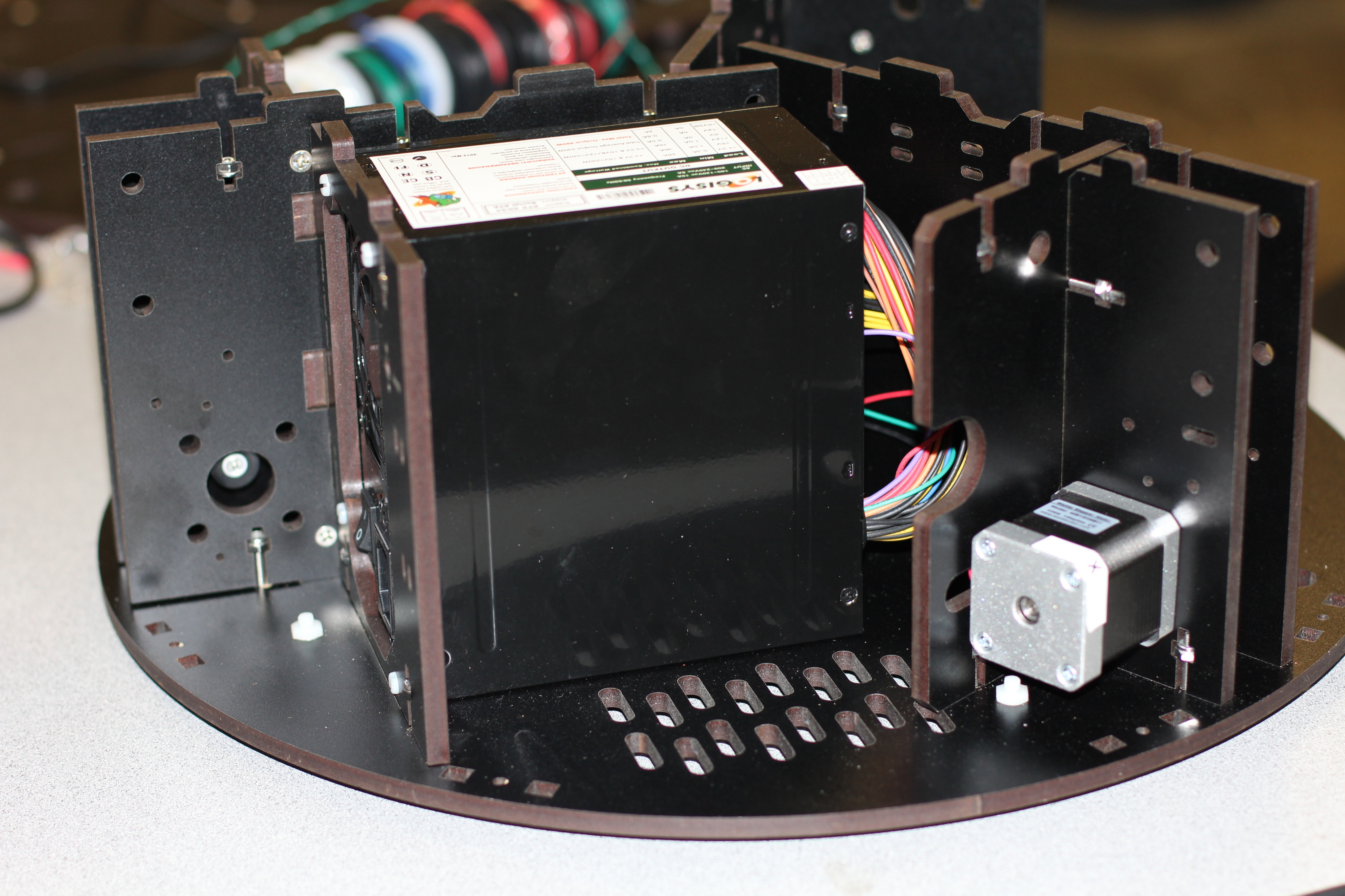

Power Supply installed early, too.
Post by kbob »
After I got the tri-supports loosely attached to the base, I went ahead and put in the power supply. That made it really easy to run the power supply wires, and it also made it easy to install all four power supply screws. The Cover Brackets (those little vertical pieces) are not obstructing the screw holes yet. I also got all the spare wires tucked neatly away between the power supply and the Z tri-support.
I don't see any downside to doing it this way at all.
Power supply in place.
Here is the wiring that I did before closing up the base. I ran power to the motherboard, hooked up all three motors, and ran three wires out for the power switch. (Three? See next post.) The power switch wires are coiled up under the masking tape in this photo.
At Rostock, the wiring goes in before the table goes on.
The Z motor line did not have a lot of slack, so I plugged it into the right hand Z motor jack. The two jacks are equivalent, right?
I did not do any wiring for the bed heater or hot end before closing the base. I may regret that later.

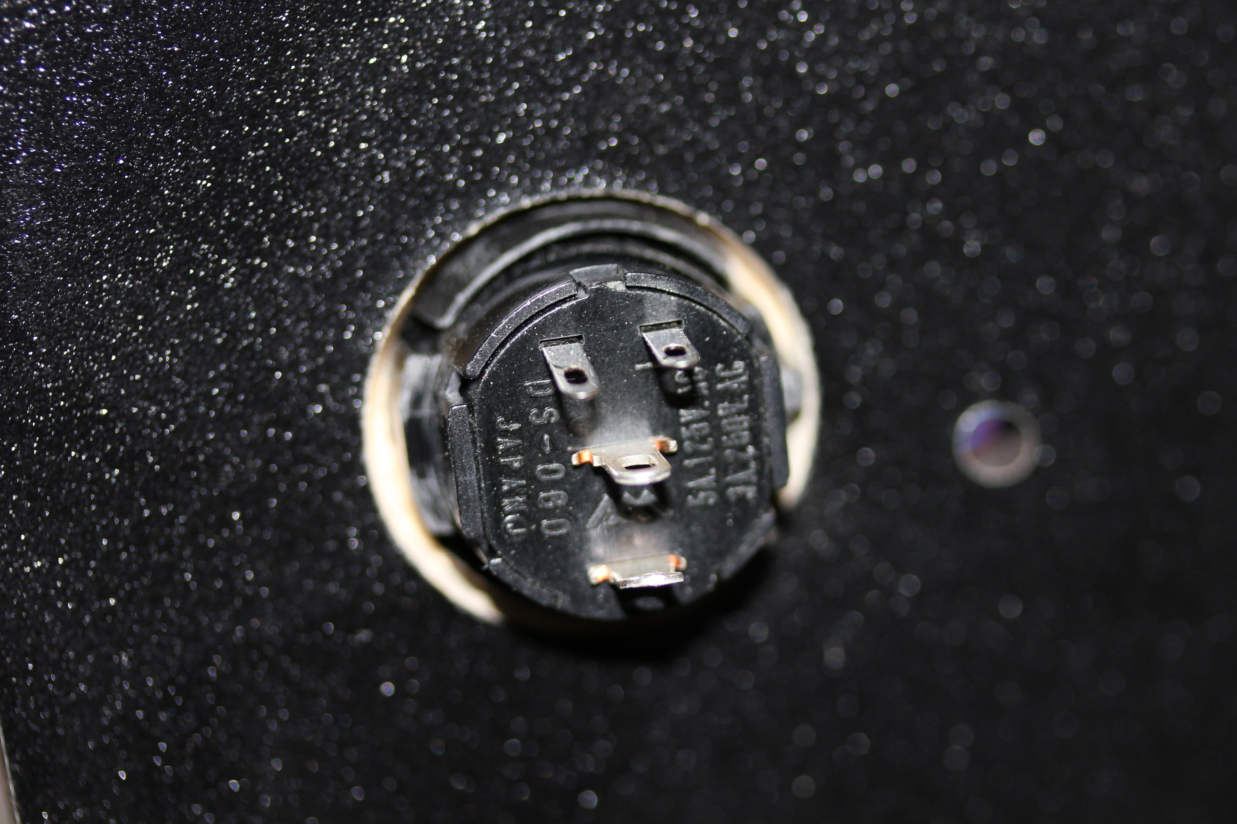

Lighted Power Switch
Post by kbob »
The power switch in the kit is really cheesy. I didn't care for it at all. So when I was at Oregon Electronics last week, I picked up a lighted SPST switch. It's round and black because the Rostock is round and black. It has an LED because the Rostock does not have enough LEDs.
I'm glad I put the switch in before I assembled the base, because I enlarged the hole on a drill press, then enlarged it some more with a Dremel in a vise.
The switch, still a little dusty
The switch was designed to mount in a thinner panel than this fiberboard, so I turned the panel over and drilled a larger hole from the other side. I drilled both holes blind to prevent chipping the melamine, and the first bit poked its nose through to make a pilot hole for the second one. I just love Forstner bits...
Unfortunately, the switch was bigger than 3/4" and smaller than 7/8", so I had to Dremel out the smaller hole to something in between. But the switch bezel hides my sins, so I am absolved.
Concentric drill holes
I did not wire up the switch. Until the base was assembled, the door was not permanently attached. I think I have some spade lugs in the right sizes. If I can find them, I won't have to solder the leads on.
