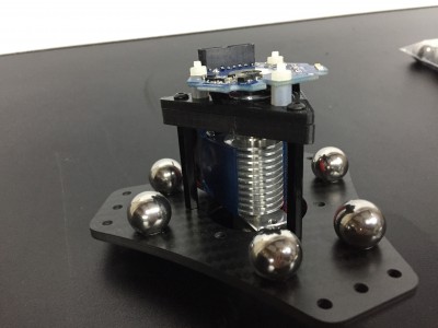

I know you can power a light ring off the HE280 board. Is there any way to turn it on and off?

There is no control for the Part LED on the HE280. Based on the schematics in GitHub looks like the + side connects to the main +12V feed and and the - side connects to ground through a 470 ohm resistor.

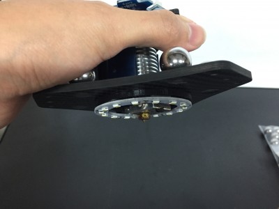

briankb, I have the tricklaser one. It's a perfect fit for the Max

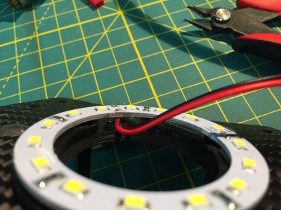

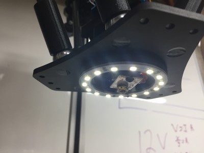

As mentioned in my thingiverse thing, http://www.thingiverse.com/thing:1845789 I used this one: https://www.amazon.com/gp/product/B00BG ... UTF8&psc=1
It's cheap, the perfect size and works great. It provides a nice general illumination, but not a spotlight effect. It's just a medium brightness.

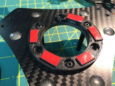

I actually have that exact light ring that I'm using on the Orion and the spare is somewhere in my collection of stuff. Thanks for making and sharing those retaining clips for the HE280 mount!Noircogi wrote:As mentioned in my thingiverse thing, http://www.thingiverse.com/thing:1845789 I used this one: https://www.amazon.com/gp/product/B00BG ... UTF8&psc=1

I used these:
and installed it on the effector with a little double sided tape. It works great and I don't really have to worry about the light level. It does flicker sometimes as the hot end is heating up. What if you just add a potentiometer in line to the LED?
