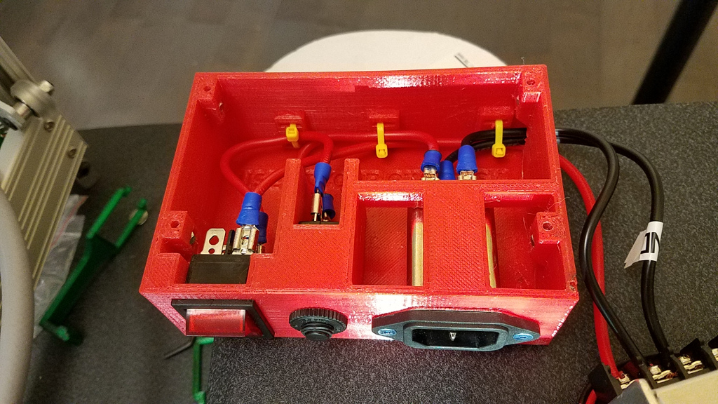

- Load wired to both left pins, or both right pins: Current passed, no illumination
- Load wired to top pin on one side, and bottom pin on other side: No (or very little) current passed, but the bulb lights up
- Load wired to pins on one side, with each pin jumped to its neighbor: Loud popping sounds, white smoke, bad smell

I'm building a custom "IEC box" (IEC plug, breaker, and switch) for a 3D printer, which I will release on Thingiverse when I'm done messing with it:
I got an illuminated 120VAC DPST switch. It has four pins on the back:
Inside, there are two contactors, one for each side:
Sitting on top of the contactors is a pair of round metal pins:
Those pins connect to a neon lamp, and a resistor:
I'm having trouble getting the bulb to light without any white smoke appearing. Here are the combinations I've tried:
Re: EE question: A DPST switch, a neon lamp, and a resistor walk into a bar...
Power IN and neutral IN to the top two pins, load OUT and neutral OUT to the middle two pins.626Pilot wrote: I got an illuminated 120VAC DPST switch. It has four pins on the back:
That makes perfect sense. The switch isolates the equipment from both the hot and neutral sides of the circuit, and the lamp's internal pins sitting on the load side of the circuit makes it only light up when the switch is on. I previously thought they used four pins because the form factor was convenient. Thank you!
