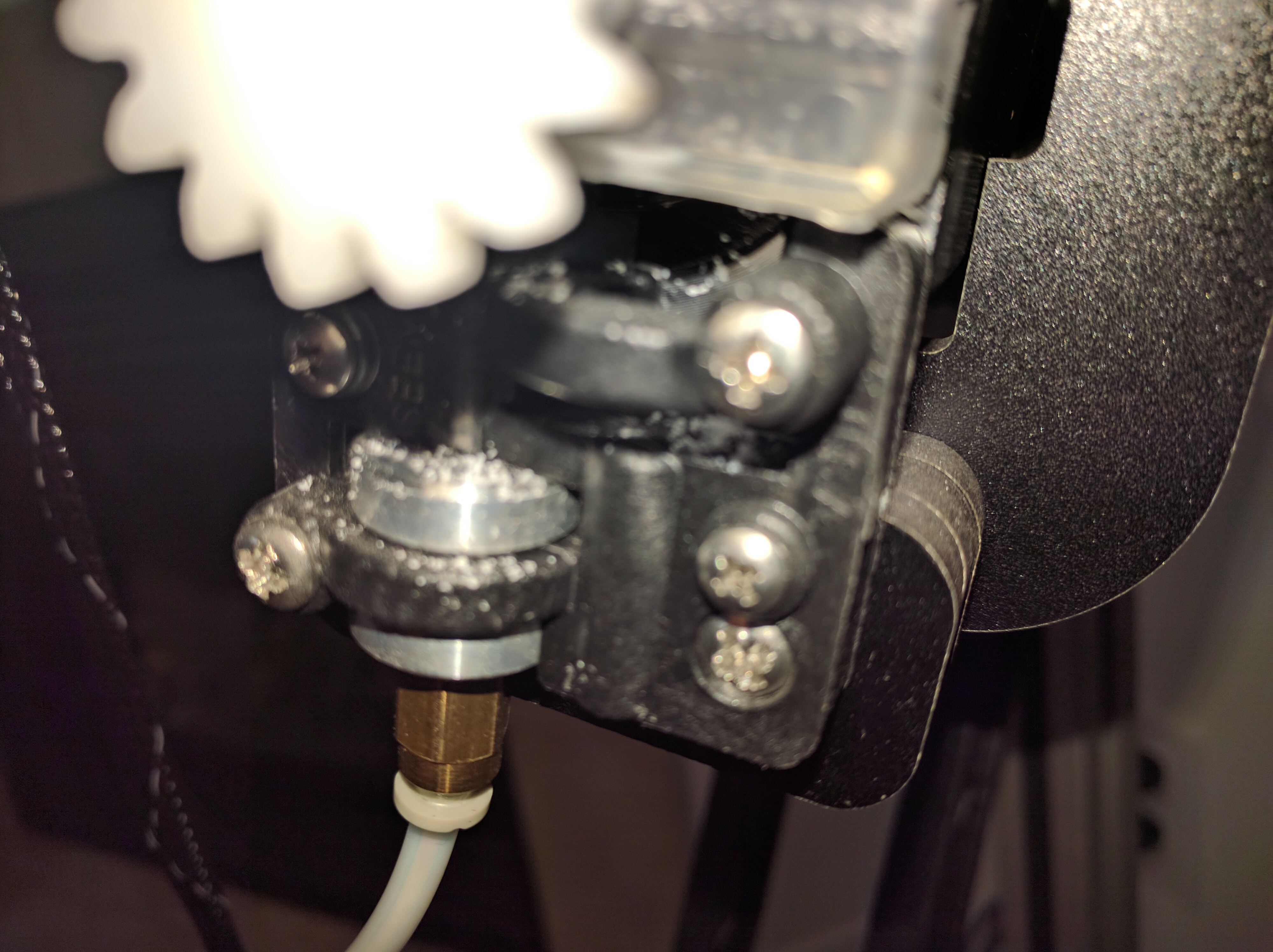

In the meantime, I just noticed that on the extruder, there seems to be some residue, presumably from some sort of grinding/slippage (there is never a clicking sound from the extruder thought). Im attaching a picture, see if that tells you anything.
I have never seen this before, this must be from the last few days of test prints since the upgrade.

Ok, also make sure your cog is aligned properly for the filament path through the extruder. That could also cause this problem.
