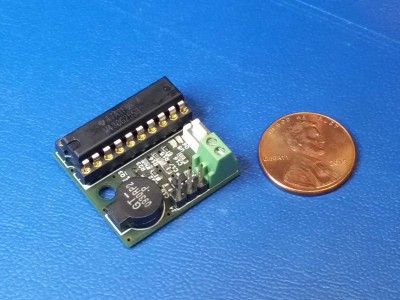

BTW, do you have PCB experience? I need to find someone to help take this POC to a product.

Yes, I have experience designing and laying out PCB's, and have hand fabricated small batches. See this video at the 2:30 time mark for a demo of a board I did recently: https://www.youtube.com/watch?v=j6wLRHK3ATE&t=150s

I'd be happy to help out with that, if you settle on a design.
If I understand what you're looking for, it would be very similar to my recent altimeter project. Is this the sort of thing you're looking for?
Re: Interfacing to the new HE280 accelerometer...
Basically. It will need the HE280 connector on one long edge and pads for the 8 wires on the other. The processor chip and 5v regulator (maybe depending on processor) and an LED to show the touch and relay messages on startup. I'm also thinking a row of four 2 pin headers to use for setting the sensitivity with jumpers and another to select NO or NC behavior. I can write this up and also make a drawing of the basic format and how I'd like to attach it between the whip and hot end.
