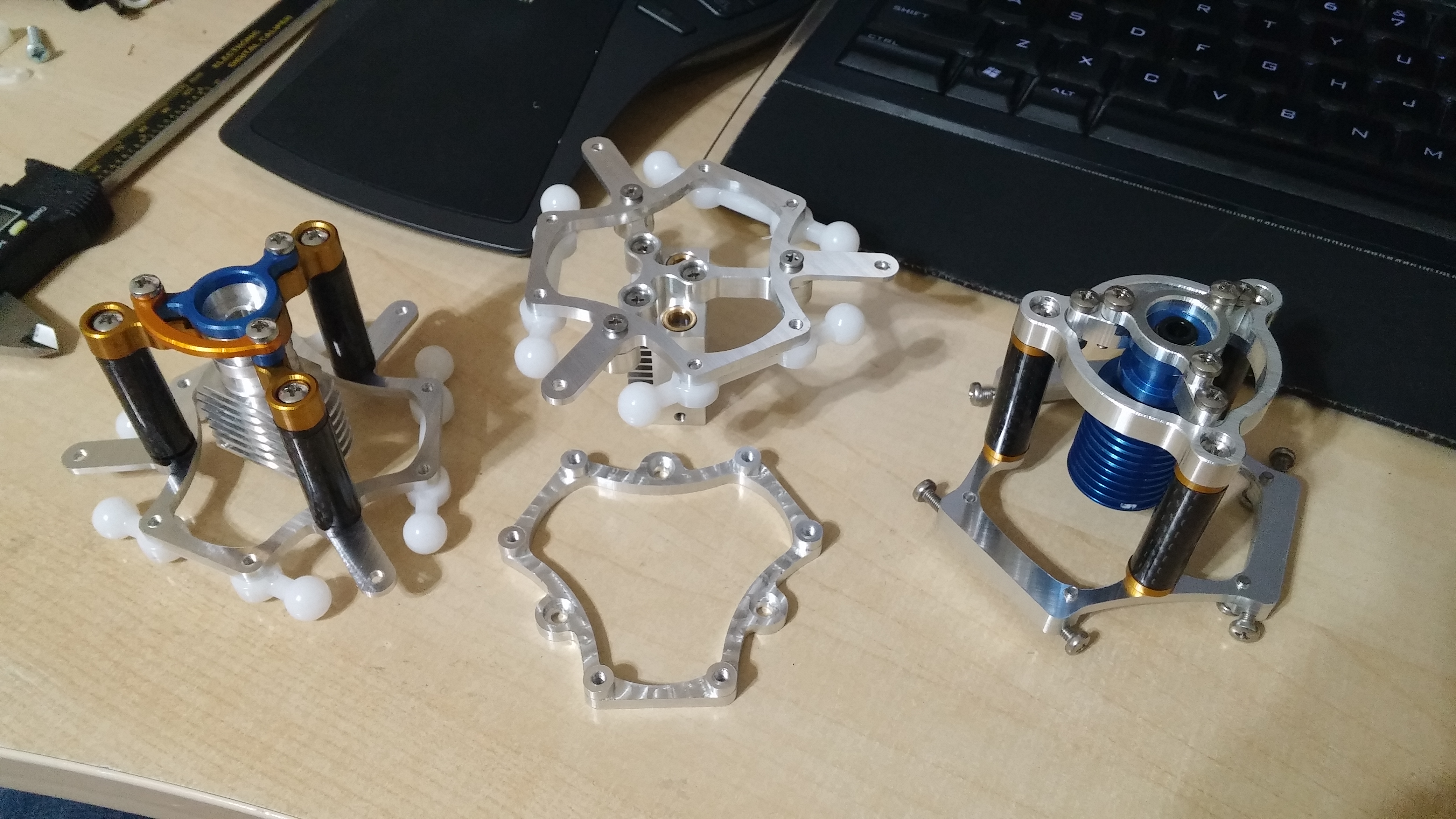

Hey Guys!
Just wanted to drop by and give a small sneak peek at the latest prototypes to come off our new mill. Soon we will be shipping out test units of our new all metal effector plates to our BETA testers for feedback. The new effector plates are offered in two styles. One of them is made to be used with the newest ball cup arms and injection molded carriages which ship on all the current Max V2 and Orion printers. The other style is a replacement for the older style arms OR for use with Trickerlaser carbon fiber arms. The second style has a very large and open center space for mounting large hot ends with ease.
I am also finishing up work on our new all metal Chimera and Cyclops mount to add to our line up of hot end mounts.
I will post more info short on both the newest mount and the new effector plates.
New prototypes fresh off the mill.
I am also very happy to announce that our new mill is up and running at last and very shortly we will cut our turn around time to just a few days on all orders. We are currently milling tons of stock and will officially change our stated turn around times to the new faster times shortly.
Meet our new Mill! We call him Fred.

Effectors are in for anodize right now. Michelle will have them done by this evening and should have first on printer testing tomorrow. Much to check though, like spacing compared to our stand spacers and such. Pics and more updated info after anodize!
travelphotog
Posts: 398
Re: New prototype metal effector plates and new Cyclops and Chimera aluminum mounts
Post by travelphotog »

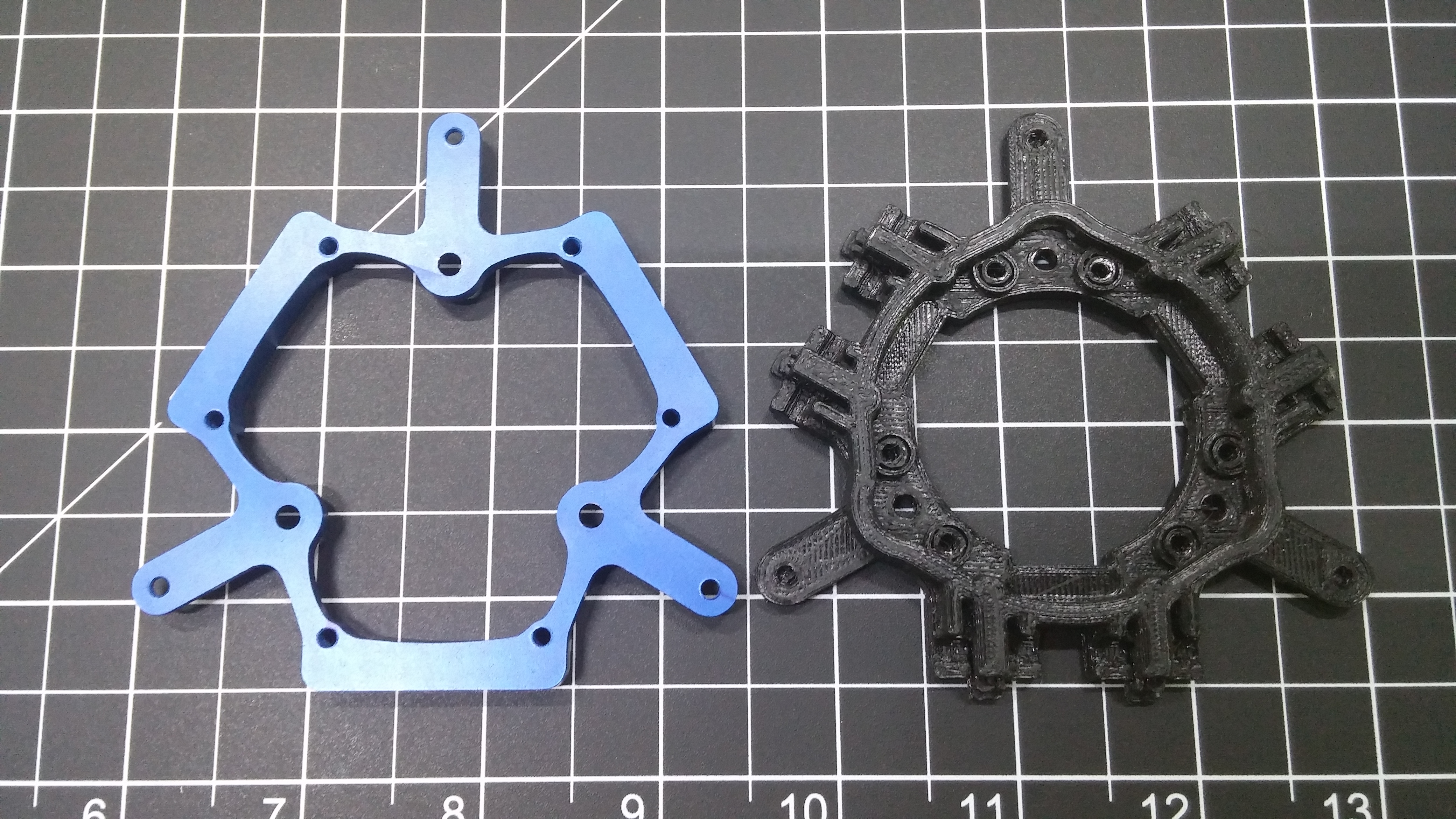

So the first run of effector plates have passed through anodize and will start print testing this weekend. Things like best spacer height and layer fan design will be looked at before the test units are sent out to field testing by our beta testers. The first Chimera / Cyclops mount is also ready to first printer tests and I will be seeking Chimera / Cyclops owners interested in beta testing the mount shortly. We will ask that you already be a Chimera or Cyclops owner to test the mount. If you own one or both of those hot end and would like to be a tester for the mount ( you will be sent a free mount in your choice of colors for testing which you keep as a thank you for helping us test a new product) Please message me at [email protected].
More updates soon and feedback is always welcome.
New ball cup plates on the left and old style U joint plates on the right. Both styles are available with and without fan tabs.
Ball cup effector has far more room in the middle now.
Both our new metal effectors allow far more room in the middle for fans.
Old style U joint effector is also opened up to allow more room for fans and the like.

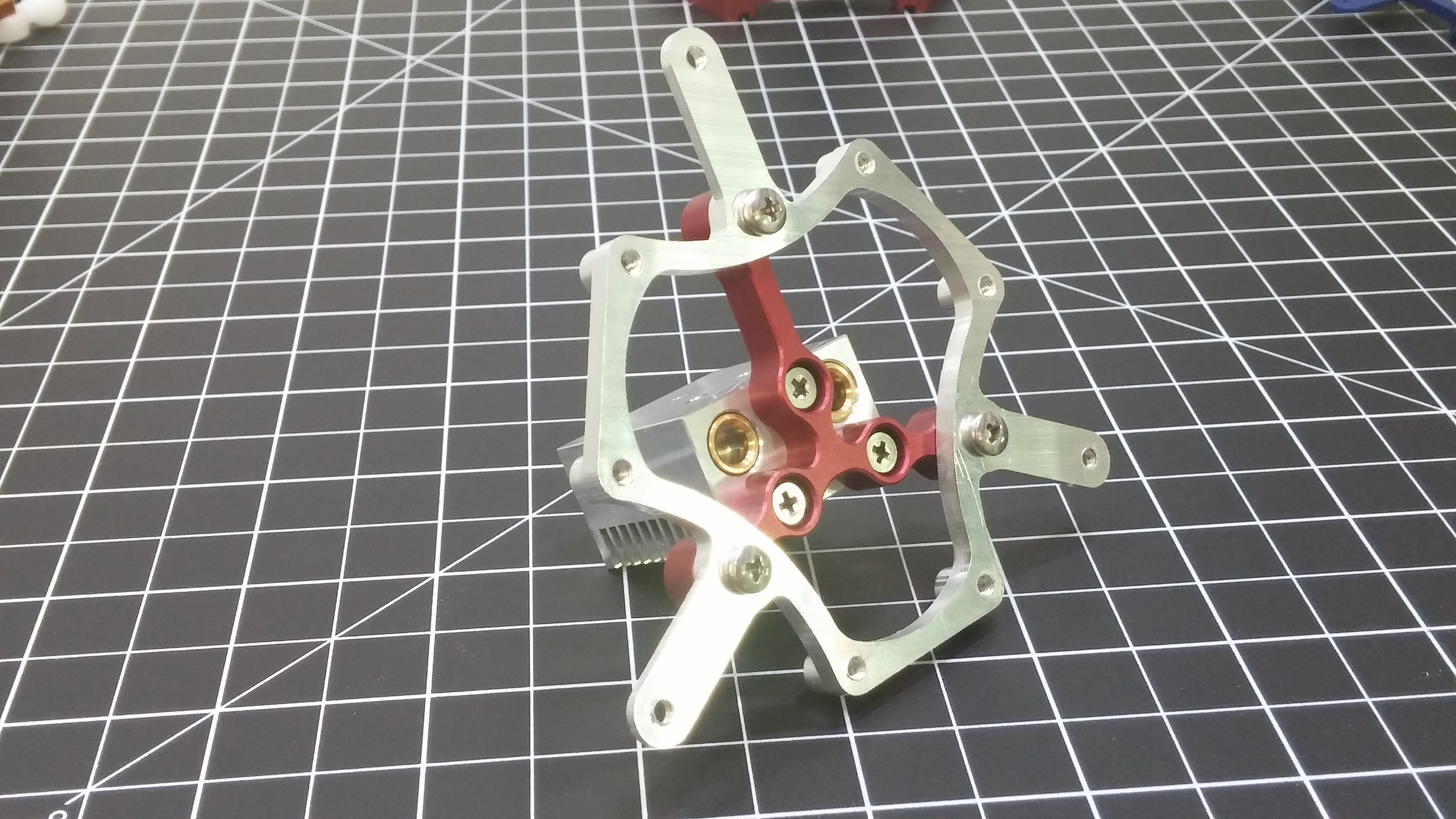

Our new Chimera / Cyclops mount.
The new Chimera / Cyclops mount can be undermounted to allow room for the Chimera heater blocks.
The Chimera / Cyclops leaves room to access the Bowden connectors.
The outer holes on the mount are threaded to M3. All mounting hardware will be included in the kit.

Did the first test print with one of the new metal effector plates in the old style (Tricklaser arms). The print came out perfectly with only a Z height reset when the effector was switched out, no re-calibration needed as it should be. This afternoon I will switch out the trucks for the new ball cup injection molded style and run a test on the new style effector also. But the result should be the same. Beta testers are being contacted now and test units should go out shortly. Once the green light comes back from them, we will have these on the site.

Hi, I have a suggestion if you don't mind.
If you move the ball joints of the platform away from the center aprox. 7mm, there will be enough clearance for the v6 to fit at any position. Not just above or below the effector. I don't have a cad file of the cyclops/chimera or the prometheus to test.
The only parameter that (I think) will be needed to change is the END_EFFECTOR_HORIZONTAL_OFFSET
With the Ball-Cup platform, by default is 30.22 so +7 will be 37.22
But... I don't really know if making a wider platform will decrease printing resolution in some sort. I guess it should not.
An expert opinion is needed here please.

Tincho85 wrote:Hi, I have a suggestion if you don't mind.
This is the stock platform. CAD files from Seemecnc's GitHub page were used.
Strangely, the values obtained were 30.37mm, which differs by 0.15mm from the 30.22mm that are used by the firmware.
[img]https://c1.staticflickr.com/9/8663/2822 ... 3052_z.jpg[/img]
[img]https://c1.staticflickr.com/9/8636/2822 ... 7ccd_z.jpg[/img]
And this is the modified platform. An adapter of thin aluminum could be made to mount the new potentiometer.
[img]https://c1.staticflickr.com/9/8811/2827 ... 5d3c_z.jpg[/img]
[img]https://c1.staticflickr.com/9/8573/2802 ... 2787_z.jpg[/img]
Changing the spacing on the effector arms will cause changes to be made in the setting for everyone who would upgrade to the changed effectors. For me, that is not an option. If one setting was entered wrong, then my customers would have a very hard time getting their printers back in working order and the small trade off for moving the mounting point out, is not worth it to me. I leave the math for things like that up to SeemeCNC. If someone wanted a custom made effector and was willing to deal with the resulting math changes from the spec they asked for in a custom effector, we will be very happy to mill it for them. I strive to produce products that enhance printers and are much as I can I strive to produce direct bolt on products that need no changes in settings (save for Z height) to work correctly.
I removed as much material as I felt I could from the stock effectors to open up the middle for users like myself who want to change their hot ends out and explore the many options offered on the market right now. I understand 100% why the new SeemeCNC effector is so small in the middle, so they can mount their new hot end and their calibration sensor. I just know that for me being a person who is switching to a duet board and others like me, the new sensor would not be a gain and the new effector plate was rather small for my needs given my setup. I am working to adopt the new sensor to my current mount system and as soon as I am able to get a test sensor, I will work hard to produce an adapter that will allow both my mount and effectors to be used with the new calibration sensor.
I know many folks mount their hot ends in many different ways and I try to take that into consideration when I design parts. That is the main reason we offer custom sized spacers for our mounts. Honestly a custom sized spacer is a bit of a task to produce, but they help our customers setup their printers for their own reasons and desires.
If anyone would like a custom sized effector, just shoot me a message or drop by my site and message me from there. We are happy to mill anything we are able to, but I honestly do not have the skills to make effector size adjustments and the needed setting changes to the EEPROM for them to correctly calibrate and print. Math is my biggest weakness honestly.
