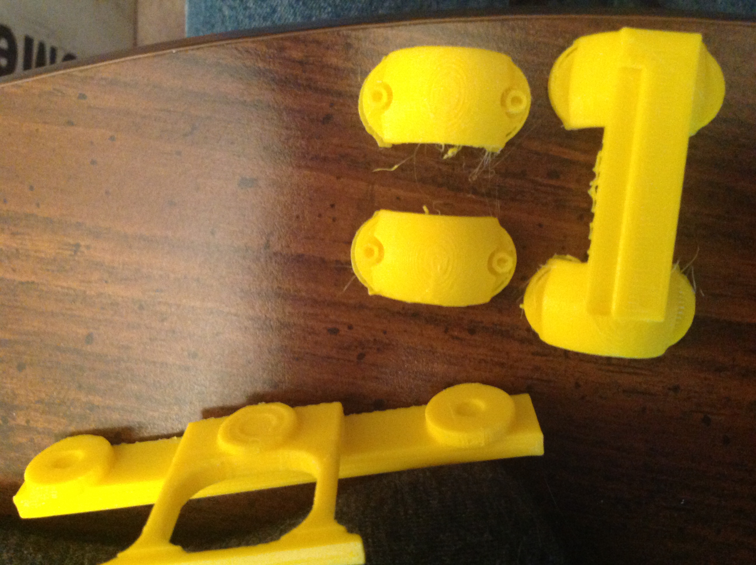

Came with the printer. I've gotten happier results with a temp of 220. Still some very small areas of layer separation in spots. I'm not certain how to resolve that. I'm just kind of winging it.JATMN wrote:Wow.. default profile needs some tuning I see..
was this filament that came with the printer by chance? or your own?
I've also been adjusting retraction and speed. Currently at 120 speed and 2.5 on retraction. I think I've about eliminated the stringiness. Almost. I'm going to move it up to 3mm on my next print and see how it goes. I think the default was 1.
There are a few places on the frame where a small separation appears between the perimeter and the infill. The bottom of the grip and the perimeter look pretty good to ME but, I'm new at this.
The barrel brackets have some of the same issues around the bracket "feet". But only on one side. Those are a bit jagged because I haven't entirely removed the supports. Maybe Monday.
It's not how fast you print, it's how well you print fast!
Not seeing any layer separation.. at least in your pictures..
I do see some under extrusion which could be a matter of both print temp too low and print speed too fast tough..
I would see about slowing down your print speed

Print speed is already pretty low. Would moving the temp up to 225-230 improve the under extrusion?JATMN wrote:Not seeing any layer separation.. at least in your pictures..
Still some problems with stringing. This is at 3mm retraction, 125 speed.
Given this is an ERIS thread, and assuming that's PLA, the hotter you get the worse the strings will be.
You really want to be as cold as you can practically print with PLA, on some brands I'll go down as low as 170C, and my thermistor is accurate.
I would verify the thermistor reading against a thermocouple if your having extrusion problems at 200C.
I'd drop the retraction speed way down (<20mm/s), too high and you can get skips in the prime part of the retraction, which can induce some amount of under extrusion.
If you're worried about the small gap between the edge and the infill, and tweaking doesn't fix it, I'd start by checking belt tension is OK then possibly increase the infill overlap in the slicer slightly.
It's probably worth doing a real extruder calibration, print a single wall test piece etc..
Im with Polygonhell
If your pushing for 225C your printing too hot by now..
Your should be printing fine between 195-210C with most PLA's (not used SeeMeCNC's yet so I dont know how it runs)
But if your stringing badly raising temps is the last you want to do.
Lower your print speeds.. and lower your retraction speeds.. (<20mms would be too slow in my opinion..but no reason to go over 45mms either)
I still dont know your print speeds.. but if they are around 40-50mms you can still slow it down more.
Other wise you appear to have some feeding issues as your prints looked under extruded on the solid layers.
