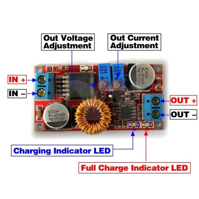

How would I wire up the voltage regulator to the led and my power supply?
Re: LED Light Strip
Your 12V power will go into the input on the regulator and the output will connect to all the leds.
So to make it simple instead of connecting your LED's to the black and yellow wires, they would all connect to the regulator output.
Here is a picture of how it hooks up.
The Black and Yellow wires connect to IN (yellow is plus black is negative) The Led's connect to the out terminals making sure the polarity is correct.
If you had 4 strands of leds they would all connect to the out terminals.
