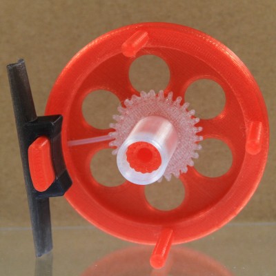

Are you using a part cooling fan? And using it appropriately (see my sticky post on fans)?
I think your calibration all looks good at this point. The billowed pylons are indicative of inefficient part cooling.

Re: Incorrect dimensions on printed objects
It's more about getting the air at the correct location rather than blasting a lot of air on it. If you blast air on the pylons above with such a thin first layer I guarantee you will peal the print. A thin well directed beam of air right around the nozzle will be much better. You can even hand hold a squirrel cage fan with a soda straw rigged up to it and direct it when you get to these critical areas. That's a quick and dirty approach. Even a slow even breath through a straw (or a balloon) will do it.
(click image to see the high resolution version)
The 3 pillars on the red part are 5mm in diameter. They are perfectly smooth and dimensioned. If I used ineffective cooling, they would look like your pylon test.
