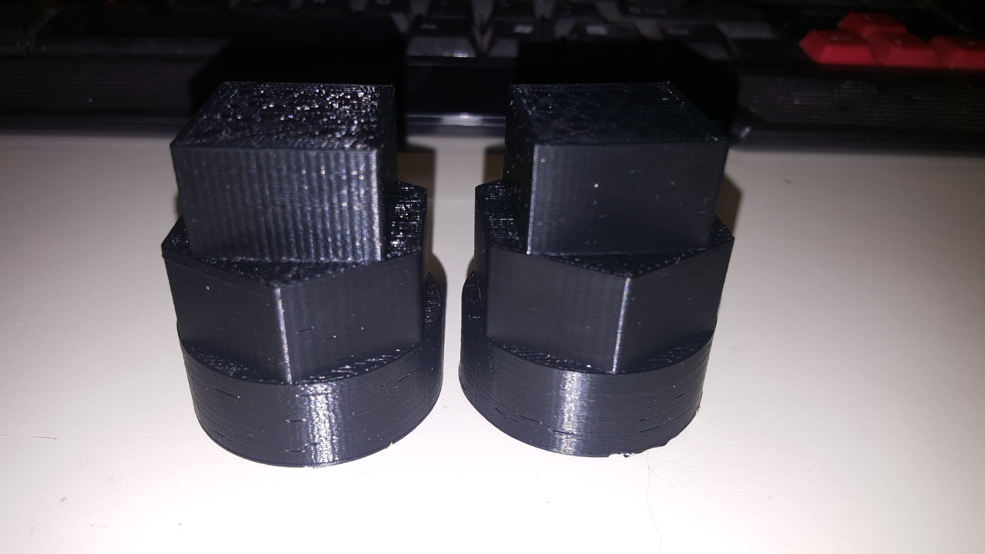

After playing with my Flashforge Creator Pro for the past month or so and being in complete awe of how smooth the outside faces are compared to my Rostock Max (stock stepper/pulley/extruder setup), I had been planning an upgrade to 16T pulleys and a smoothieboard. Now seeing your results with 16T pulleys and 0.9-deg steppers only, I'm rethinking that.KAS wrote:I know this is a broken record:
Before, stock setup: http://forum.seemecnc.com/viewtopic.php ... 150#p67435
After, .9 16t: http://forum.seemecnc.com/viewtopic.php ... 150#p69575
And with a geared extruder running JFettig's adapter plate for the ezstruder: http://forum.seemecnc.com/viewtopic.php ... 001#p76133
Looks like I could change to 16T pulleys, 0.9-deg steppers, and finally setup my geared dual extruder setup for less than the Smoothieboard alone. I'll likely also ditch my Astrosyn dampers for cork or no dampers at all to remove as much potential compliance in the system as possible.

left is 40mm/s, Right started at 150mm/s. at the first noticeable band in the middle I increased 150%. Just above that is the next band that was increased 200%.
You can definity see the rounding of the corners at higher speeds. Right side top looks horrible with 3 layers, probably need to increase the temp.
