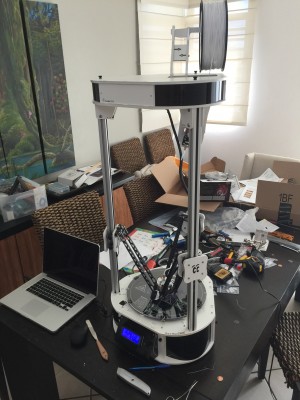

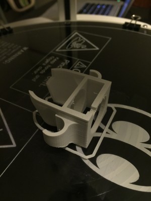

I finally finished my Rostock Max V2 build over this weekend. I clocked in 37 hrs to get me to powering it on. I spent extra time with painting the edges white and squaring the towers: nothing special, just many failed attempts, and in the end I squared them with the glass on top of the build plate and they magically appeared squared, so I guess the bed was not level or screwed on too tight. I only timed myself to powering it on since once this baby got power, the excitement was too much and I simply couldn’t be bothered with the time keeping. I barely slept as my first fan shroud was printing. Set it up at .100 layer height with a .35mm nozzle instead of the stock .50mm using Simplify3D software. Woke up at 3:30 AM and when I got to the printer I could not believe my eyes: The part was so smooth, you could barely see or feel the layers, if I remember correctly you can’t feel them with your finger-meat, just your fingernails. I was blown away. I couldn’t believe it. Then with realistic expectations, I tried to fit the fan inside my beautifully printed shroud… it was at that moment that my head just gave and proceeded to explode.
Such an incredibly tight and perfect fit! Weren’t FDM printers used mainly for crude trinkets? What type of sorcery was this!?
After seeing that fit (and finish) I could not sleep again while the 2nd fan shroud was printing. I just laid in bed tossing and turning, thinking of the world of possibility that had just been unlocked for me…

BEHOLD!!! MY 3D PRINT-I-NATOR!!!
And its very first print.
