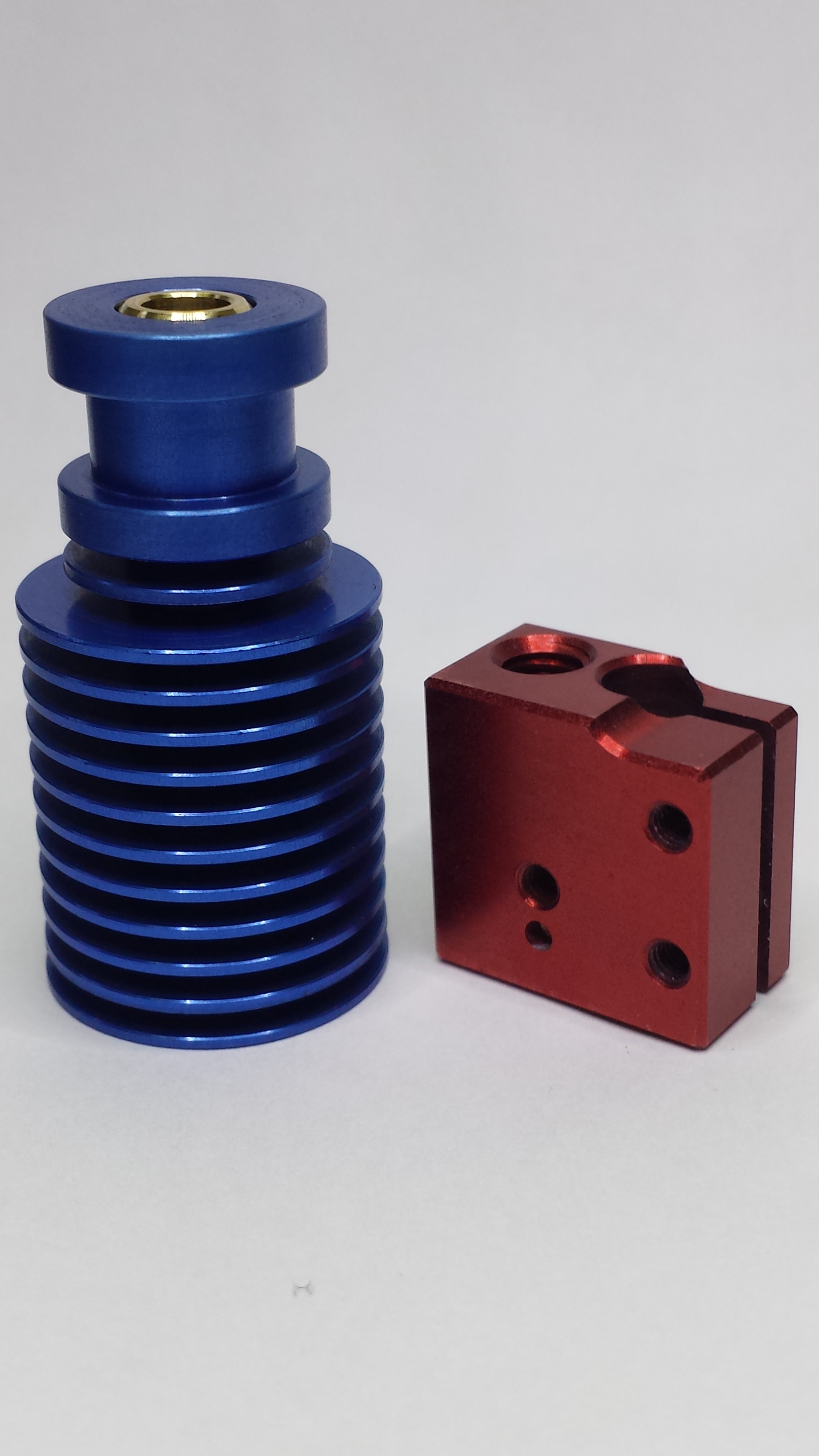

Today I tested how well heatsinks and heater blocks from E3D would anodize. As you can see from the results it works great! I will now be able to anodize them to match the aluminum and carbon fiber mounts I make. If anyone is interested in an anodized heatsink or heater block, just shoot me a note.

Could you do this with a Kraken water cooling block without changing the tolerances on the M3 threads and the heat break holes? I don't know much about anodization, but I think it'd be cool to further establish my color theme I have going.

I would have to touch base with E3D on what alloy they used for those. Also have to make sure there is no other metals in that cooling block already when it is anodized. If both things check out it should be fine. The E3d V6 heatsinks are sourced from them without the brass fitting pressed in already so they anodize fine. The anodize layer is not a super thick layer over all and it should be fine. Everything still fits great on the E3d V6 I tested with. I will email them tonight and check on the metal alloy and also to make sure there is no other metal fittings I need to know about before it can be anodized.

Having been down this path - anodized heater blocks will discolor with use. It is not a good candidate to anodize. The heatsink is fine though. And yes, the Kraken exterior can be anodized, you simply plug the holes and anodize the exterior. The brass fitting in the Kraken can be covered with nail polish to protect it and then the hole plugged with silicone seal or putty and away you go.

For ease of doing this I use the heat sinks straight from E3d in the UK without the brass inserts in place. thhen press them in place after being anodized. So I just charge $10 above the cost of the unit and shipping (which comes out cheaper than buying it local with the brass insert already pressed in). That being said

How are you anodizing your aluminum? I'm working on a project that id like to have some anodized colored bits on it, and I've been looking around for home brew ways of doing it. Seems the battery acid anodizing, lye and RIT dye, and boiled water sealing method is pretty common and inexpensive. Is this what you're doing?

Over all that is the idea of how it is done. But you need a lab power supply so you can control the power 100%. I do not use Rit dye as it tends to fade over time. I use anodizing dyes for all my work. Also you should use a Nickel Acetate sealant when you do the boil sealer. It is pretty simple but also depends on which color you are trying to use also. Blacks are pretty ease to get (with the right dye otherwise they tend to look eggplant purple in sunlight) While reds are much harder to get good results from. Do you know which alloy your parts are made from? Some alloys need an acid dip before they are dipped in the dye and also some will not do very well if you do a Lye etch before hand. It all depends on the alloys and the color you intend to go for.Nylocke wrote:How are you anodizing your aluminum? I'm working on a project that id like to have some anodized colored bits on it, and I've been looking around for home brew ways of doing it. Seems the battery acid anodizing, lye and RIT dye, and boiled water sealing method is pretty common and inexpensive. Is this what you're doing?

I have been out of town so much for work and trying to keep up with the demand for the hot end mounts, that I have not had much time to work on this of late. We are working hard to get some new mount prototypes out to expand the number of hot ends our mount will work with. If it is a E3d V6 cold end you are seeking to have anodized, you can shoot me an email at matt@713maker(DOT)com and I will see about getting on taken care of for you. Currently I am only working on new cold ends without the brass inert installed and then pressing the insert into the anodized cold end. This is due to the brass fitting being damaged our polluting my acid bath in the anodizing process. Some have success with applying a mask to the brass fitting to cover it from the acid. But I have have mixed success with this due to the placement of the insert in the cold end, so we currently only work on the new cold ends then inert the fittings after anodize.Renha wrote:How's your progress? I want some!
