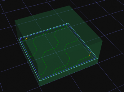

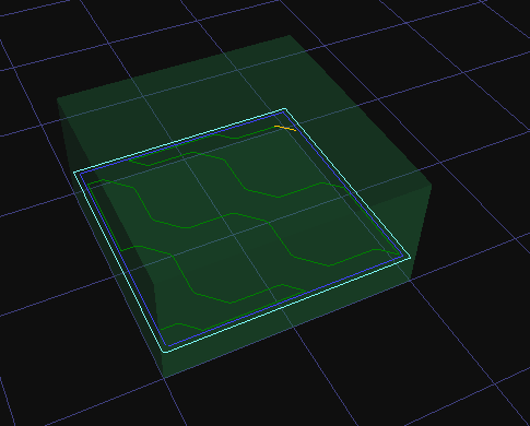

have kisslicer running real nice on my delta, but the infill is just crappy. When i was using slic3r or cura the infill layers stacked on each other real nice, but with kisslicer the infill gets rotated 90 degrees on each level. I can't seem to find out how to change this.

It's doing exactly what it's supposed to. Print it and you'll see.
I use Kisslicer 99% of the time and I've never had a problem with the infill pattern.

i guess must have some flow issues then, because with these patterns the material only stacks up at the cross over points.

That's pretty grim. It's NOT the infill pattern. :)

Can you increase the infill extrusion width? If it's too low (even the same setting as the wall can be too low) it starves like you're seeing sometimes.

Awesome! Changed my infill width from .4 to .6 and the infill is beautiful!! Glad kisslicer looks like it's gonna work for me because I already bought the pro license. I like to support devs for freeware that I use.

If you're using a .5mm nozzle, try setting your extrusion & infill width to .55. If you've got a .4, set it to .45.
Give it a shot and see how it works out.
