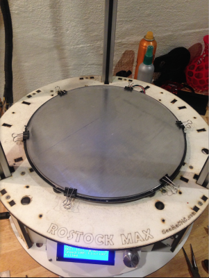

Eaglezsoar wrote: The aluminum disk was purchased and a machine shop cut it to size here is the link: http://www.sandsmachine.com/alumweb.htm
Did you have S&S machine it for you? If so, care to share the drawing? I may get one of these in the future for a print surface. Thanks for the link!
Re: All prints are raising up on one edge
No, S&S does not do the machining, I took it to a local shop where they cut it into the smaller round shape the same size as the Onyx for a $30 charge. I drilled
the holes using the Onyx as a guide then used my drill press to countersink for the #4 screws. The rounds I bought from S&S are 5/16" and perfectly flat. Mine
had 4 holes in them already but they were outside the cut line so it didn't matter but they may have changed the sizes so be careful what you buy.
Edit: I just looked at the link and the bottom listed plate that is 5/16" is the one I bought. I do not recommend that you try to cut them to size yourself unless you
have the proper saw and blade. That thick aluminum chatters like a squirrel in heat if you don't have the proper tools. The $30 I paid to my local machine shop to do
it was money well spent. If you took the Onyx with you the local shop would drill and countersink the holes, take a #4 screw with you so they know how deep to countersink
if you go that route. If the heating Onyx can bow that plate then my name is Silver and I have a rider named the Lone Ranger. I also run my Onyx on 24V, I don't know the
results of heating that big plate with 12V but I can imagine it would take a long time to heat.

Eaglezsoar wrote:A piece of aluminum 1/8" between the Onyx and the glass can help to distribute the temperature. A wall you mentioned is also a good idea to minimize drafts. Some use a section
of Sonotube (not sure of the spelling) but it is for concrete, can work also. Heating the Onyx with a 24v supply can get you to temperature faster and you could try a hotter bed
temperature but I recommend a DC-DC SSR feeding the 24V into the Onyx although I have received arguments on that. (Some would rather run the 24V through the Rambo).
Just throwing out some ideas.

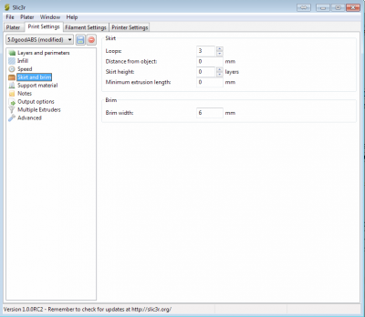

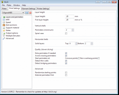

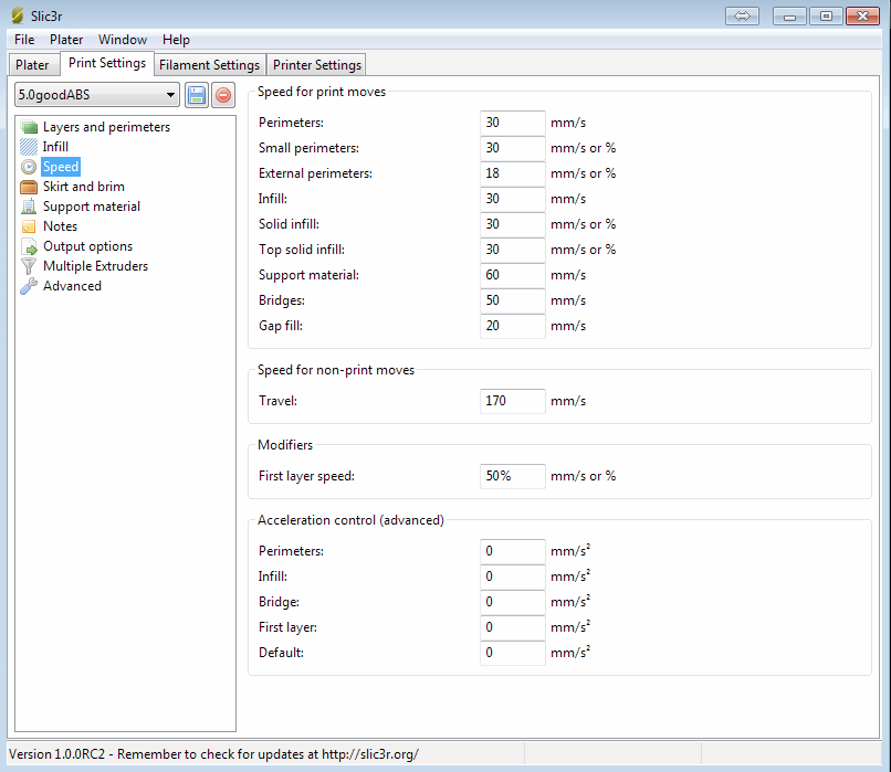

I have installed an alumninum sheet. It's about .69mm thick.
My prints are still raising up on all edges from the bed and splitting on the corners throughout the prints.
Bed temperature is 90C on first layer and 93C after that. Extruder temp is 228C. I have perimeters set at 2. Infill is at .20. I'm using a brand new .50 nozzle. Layer thickness for the first layer is .20 and all other layer thickness is .20. Printing with skirt and brim. I'll try again today with a wall around the printer.

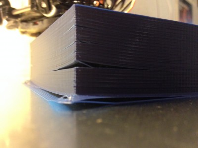

Your last picture shows delaminating during the print... I t could be from your filament.
Have you tried different filaments ?
What brand is it ?
A layer fan could do that too. Do you run a layer fan ? You should not use layer fan with ABS.
If you don't have layer fan, is your printer near a door, or a window ? Is it in a garage with bad isolation ?
ABS really does not like wind or temperature changes. Some even build an enclosure for their printer, that helps with ABS.

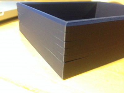

Printing with the fan off and an enclosure didn't help. This is how the print turned out. I'm printing ABS here btw.

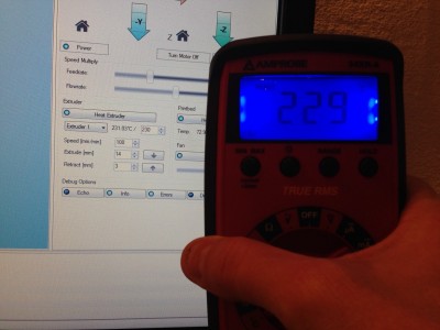

It's not only warping away from the plate, but also delaminating... I guess I would try playing with temps.
Did you check your thermistor accuracy with a thermocouple ?

enggmaug wrote:It's not only warping away from the plate, but also delaminating... I guess I would try playing with temps.
My extruder temp is 2C below what it is reporting in Repetier Host. I think this is ok.

grabredemeyer wrote:I'd bump your hot end temp up a bit. Let's say 235. I don't like the delamination...usually ends up being a hot end temp thing in my experience. I'd also recommend making sure the temp you're re reading is the actual temp.
I raised my hotend temp for ABS from 230 to 237. Given that Repetier Host reports 2 degrees lower it should be at 235 now. Will update changes in prints soon.
