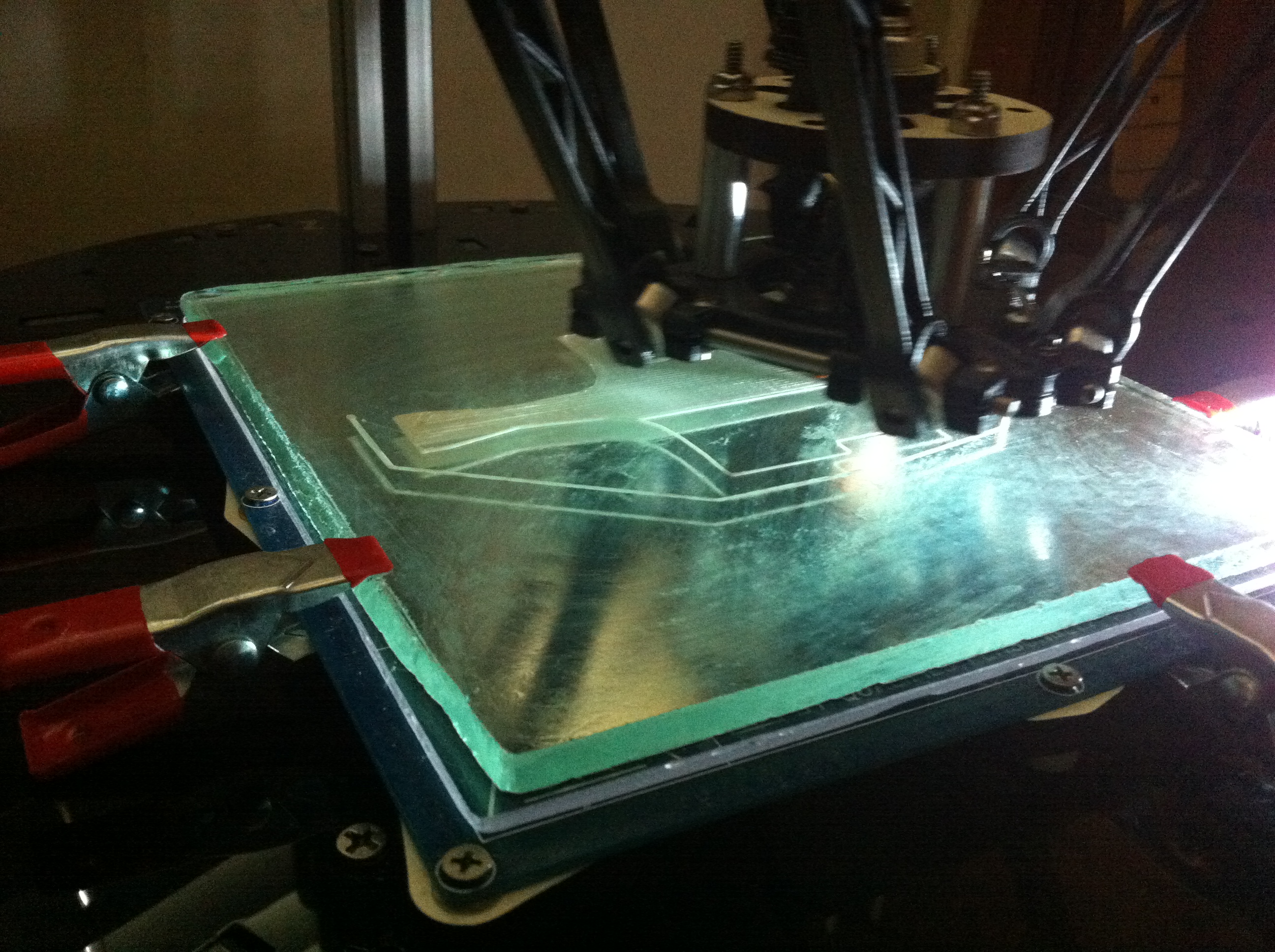

I have been very happy printing on glass with hairspray on my Onyx. I like glass because you can remove parts with a razor blade without hurting the build plate. You can buy a piece of window glass at the store for less than $5 and cut it to size very easily (especially a rectangle like you need). Cutting a glass circle isn't that bad either ( http://www.youtube.com/watch?feature=pl ... T_sb-tPdx4 ). I made my own circle cutter out of a plastic ruler and a suction cup.
[img]http://i.imgur.com/JLFv2dd.jpg[/img]
Recently I saw one of the seemecnc guys using glue-stick on his glass build plate, but I don't know what material he was printing and I haven't tried it for myself yet...

Oh nice contraption! I'll keep that in mind when I upgrade the bed.
I tried Elmers glue stick but didn't seem to do very much.
I tried ABS Juice and have been using Hairspray and painters tape but painters tape always starts coming off on long prints.
So I just cut a thick mirror I had lying around and voila works like a charm using ABS juice for now!
I had to readjust the #define PRINTER_RADIUS now it's moving across flat!
Highly recommend anyone using a plastic build plate like I was to use Glass, the warping of plastic was a constant hassle of recalibrating.
