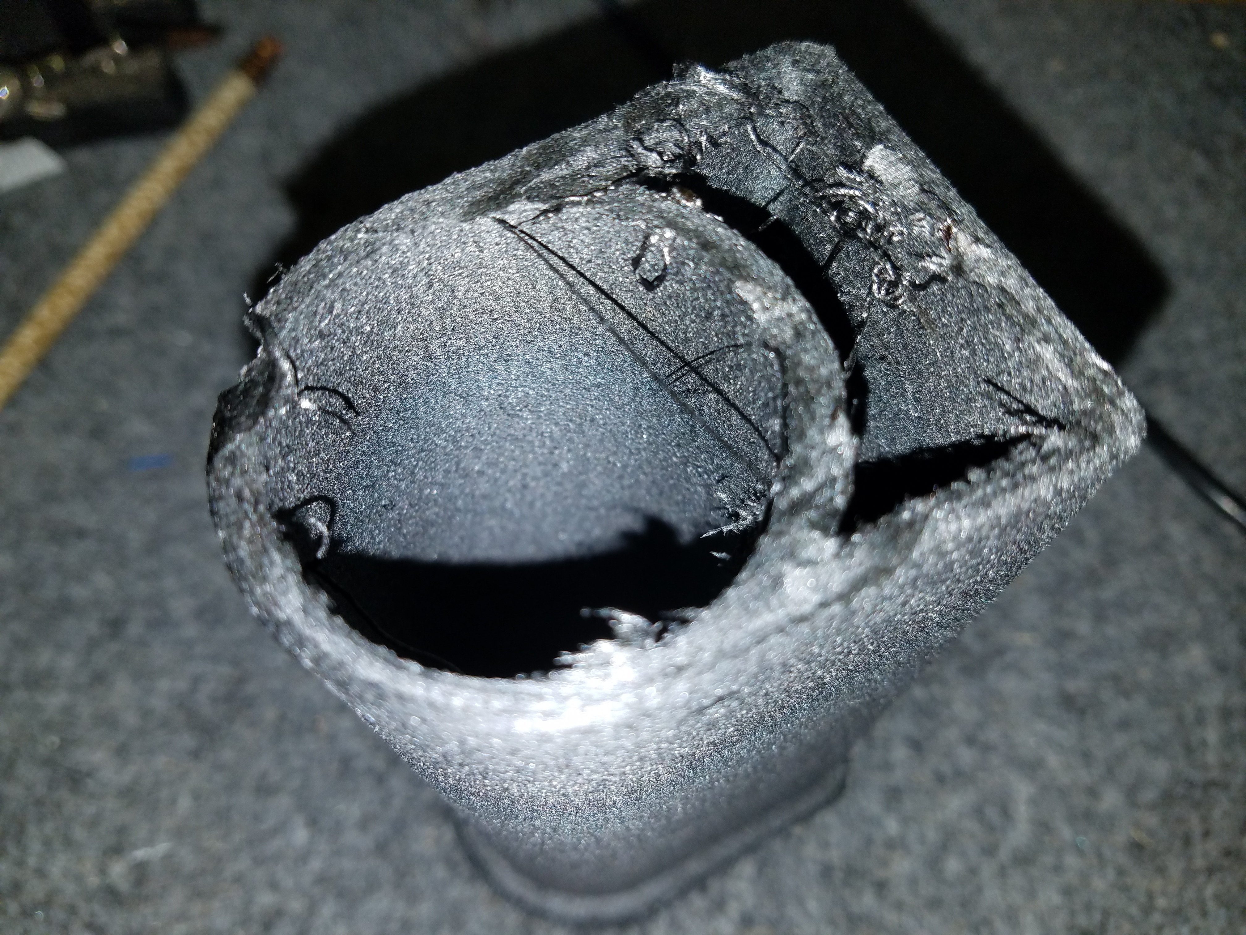

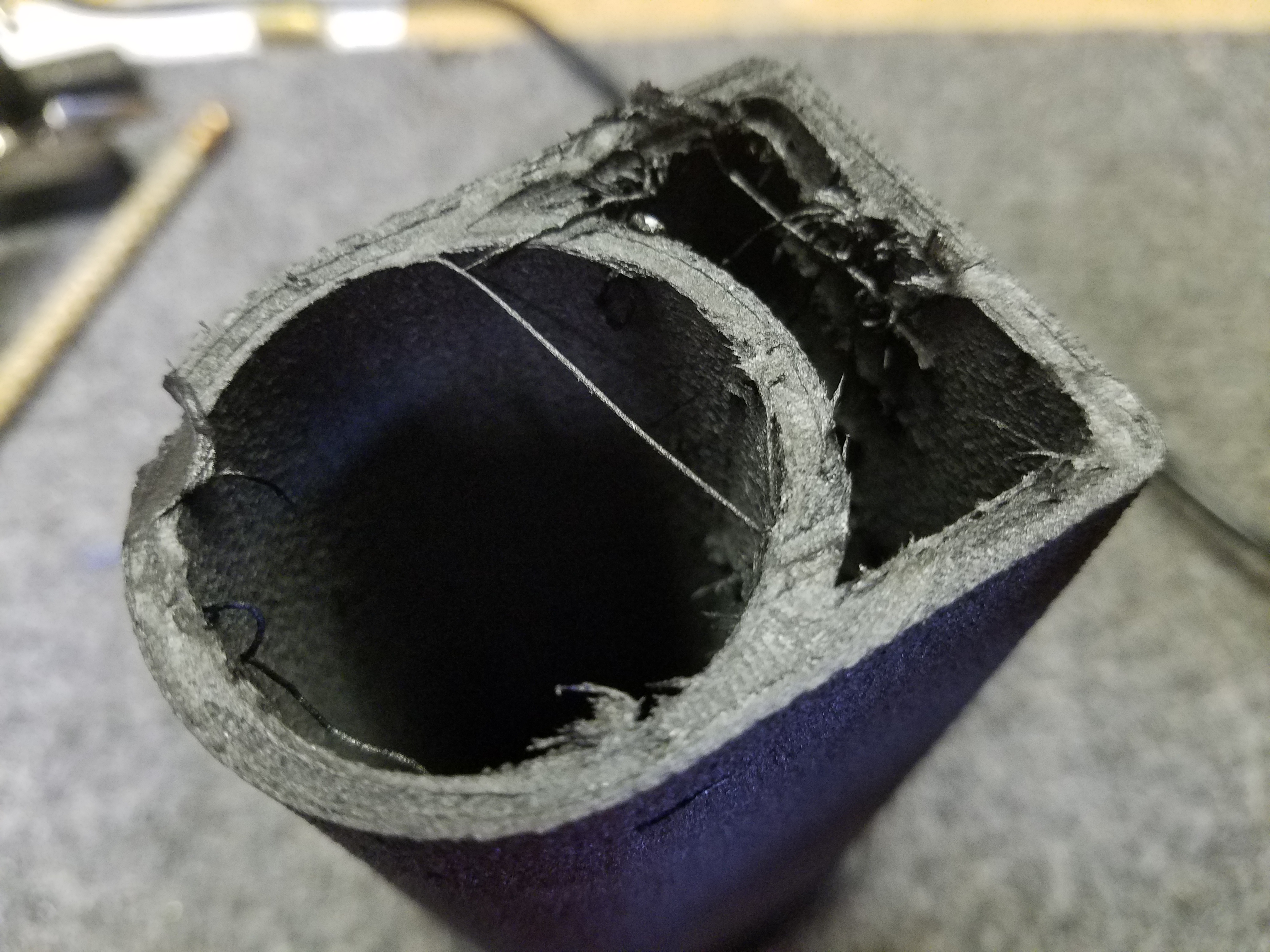

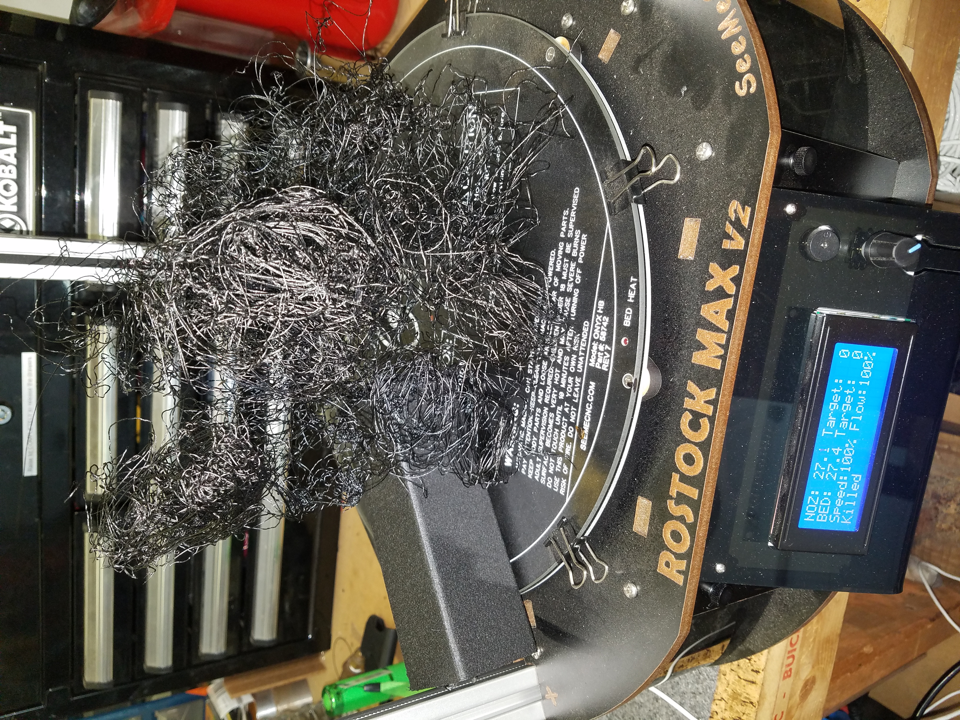

So, in the continuing saga of trying to print this vertical column, changing to direct-print from the SD card in the printer seemed to be a solution. The first time printing from the card the job got about 80% of the way done and then the printer somehow knocked over the print job in the middle of the night after about 15 hours of the 19+ hour print job. The result can be seen in the attached pictures. I woke up to find the column knocked over on it's side on the bed, with a ball of filament all over the bed.
I tried a second time and once again I found the column lying on its side the next morning with the printer spitting out filament all over the bed. In both cases, the printer was able to complete about 5.5" of the vertical column before whatever happens happened.
I used a raft for the piece. Attached are photos of the mess.
Thoughts?

I would try printing with a brim attached to the print,,, possibly as high as 3 layer thick.
Re: Print failure when printing vertical columns?
Make sure you've got your slicer configured to lift the nozzle on retract - z-lift or z-hop.
You can also add a brim to your print that will give it increased surface area on the bed to improve the part's hold on the bed.
