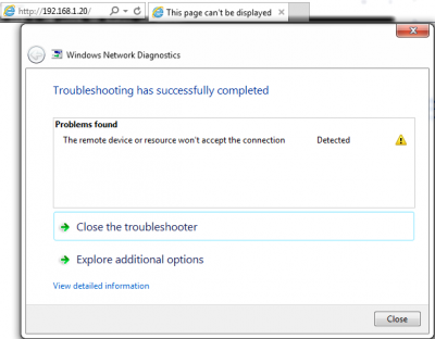

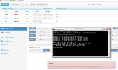

I leave it on with just USB power while I'm away to see if it fails, and it died again while I was at work.
It's had two different Ethernet cables, and either your adapter or my NIC has automatic crossover because I don't have to use a crossover cable (which is nice).
It has its own dedicated NIC card, and it's set to a different network than the rest of the house. And I've used ipscan to look at the network after a failure (no duplicates).
It's pretty simple to detect a bad or disconnected SD card, go to the console screen and look to see if the system sees your network. If it's unplugged, you will just see a running time stamp and the word "Connected". Nothing else. (BTW, I can't tell you how many times I've popped the SD card out while trying to disconnect the Ethernet cable. This is why I know this). When it's plugged in and working, you will see your network. Non-Gcode (or I suppose a corrupted file) will knock out the network as well.
Curiously, the board says "Duet WiFi" on the bottom, but I'm assuming the only difference between the two boards is the network adapter.
I've tried it with and without the USB cable plugged in and unplugged. It doesn't seem to make a difference.

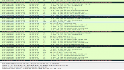

I'm installing Wireshark, we'll see what it comes up with...
Re: Duet Ethernet connectivity problems
So I ran it last night with no problem, however the connection had dropped out by the time that I got home today. This is what WireShark shows more and more of near the end of the capture.:
