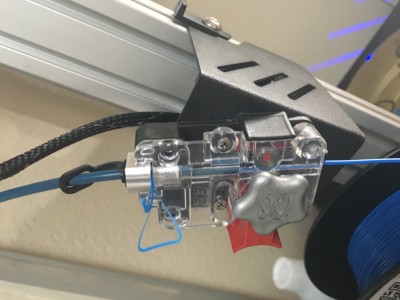

I bet the root cause is the bowden tube not being fully seated in the extruder.  If it's moving as much as you say, it's robbing part or all of the travel of the retract.
Also check to make sure the bowden isn't moving at the hot end-end.
Once again, it's NOT the hot end.
Re: First homing: horrible grinding sounds
Never said it had to be the hotend btw, I just like to test everything when things go wrong.  I had an extra v6 and it quelled that question in my head.  I also figured if I made the setup more similar to a tried and tru setup, I'd have a better idea of what to look at.  Also, so far I like the v6 more than the se300 and don't see how it could be a down grade--not having a good print from the se300 doesn't help it.  They are very similar, but the v6 is more mature.
Bowden is firmly inside the extruder and hotend as much as possible. I spent a good deal of time trying to verify the bowden was seated all the way in the hot end--to the best of my ability, it is/was. It was kinked a bit at the start, but not any more.
I asked for a new thermistor but haven't heard back yet.
This shouldn't be a big deal but it is. Nothing looks wrong at the moment so after all the obvious fixes have been exhausted, the non-obvious need to be looked at.

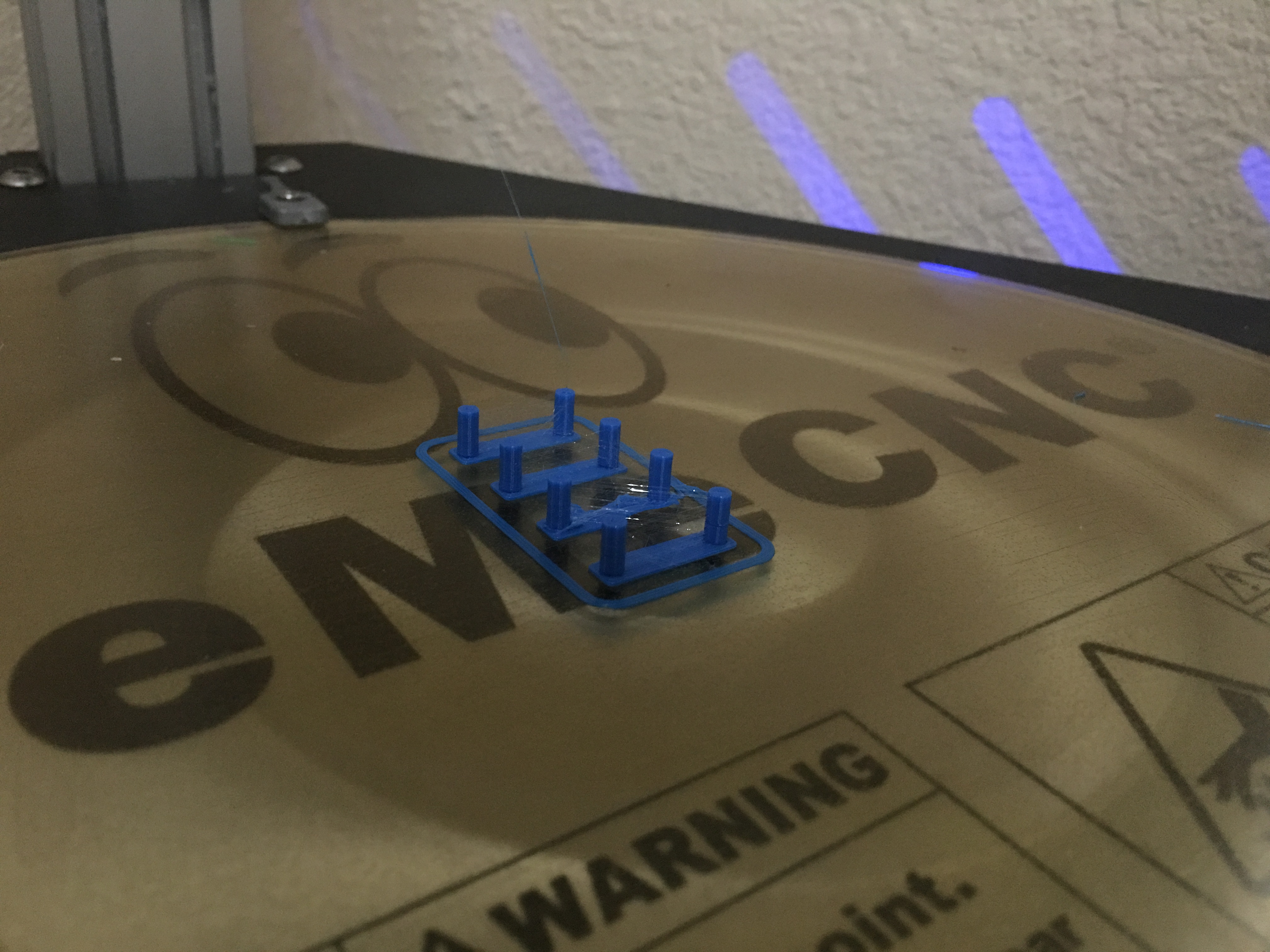

I'm going to table retraction/stringing bug fixing.  I might just have to live with the Artemis being a string monster for small parts.
I found my old retraction test and tried that instead of the circle/cylinder one.
https://www.thingiverse.com/thing:2240682
After swapping out the eztruder end piece and clamping it, the thermistor, and swapping out the short ptfe tube in the hot end that was kinked, I didn't have any strings on the cubes. Still strings on the cylinders though... I'll look into getting a low heat heat gun (cheap travel hair drier maybe?) for when I do get strings.
If you look at my previous picture of the eztruder, you'll notice there are no screws in the top part. Does anyone else have those? I believe those need to be filled and tight to avoid that metal end piece room to move. Gene, thanks for sending a new one, it is tighter than the old one, so not a waste.

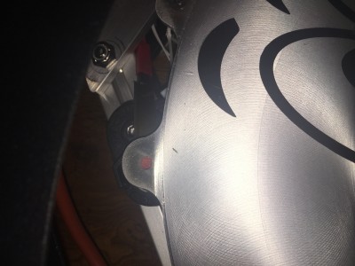

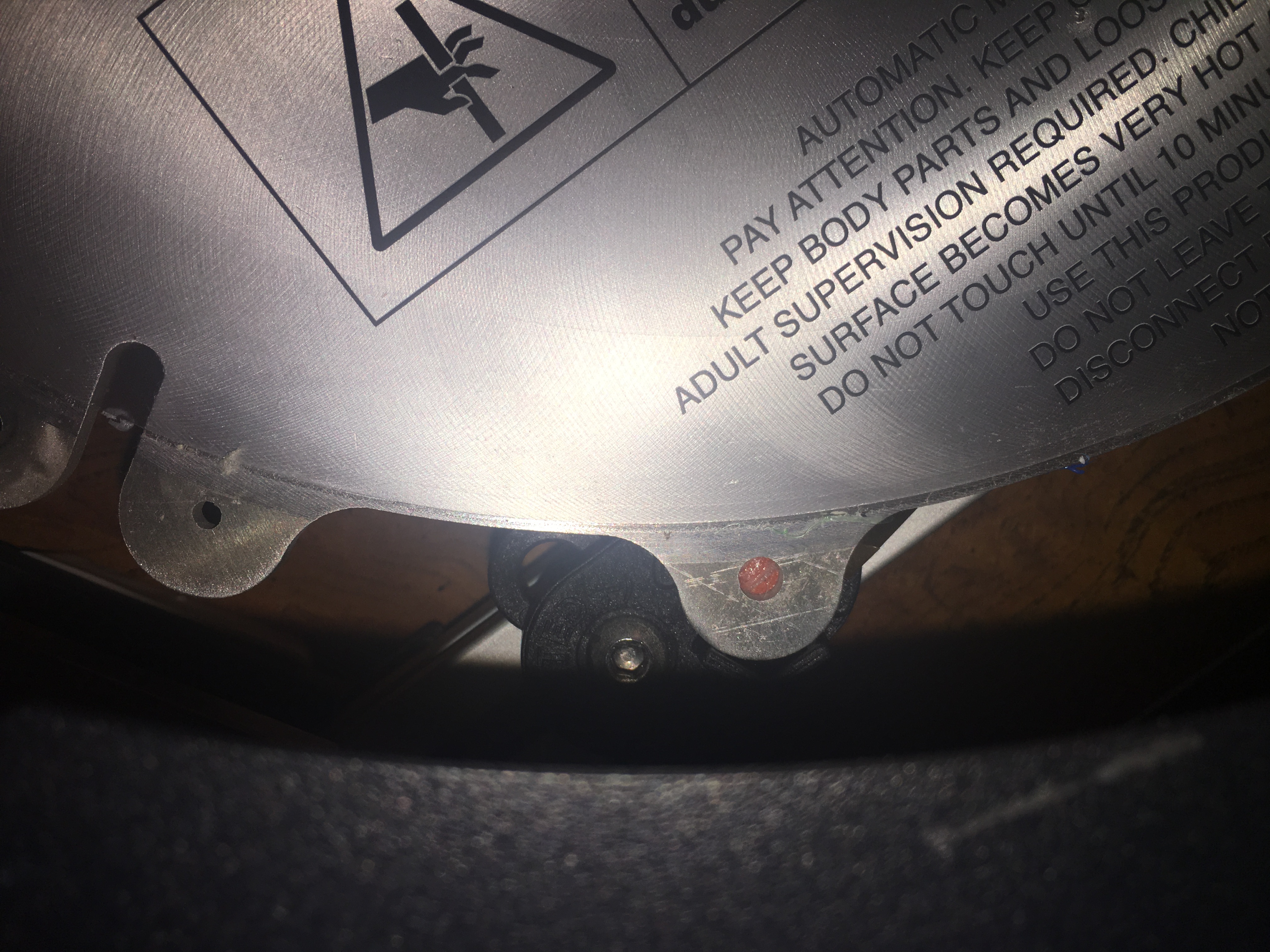

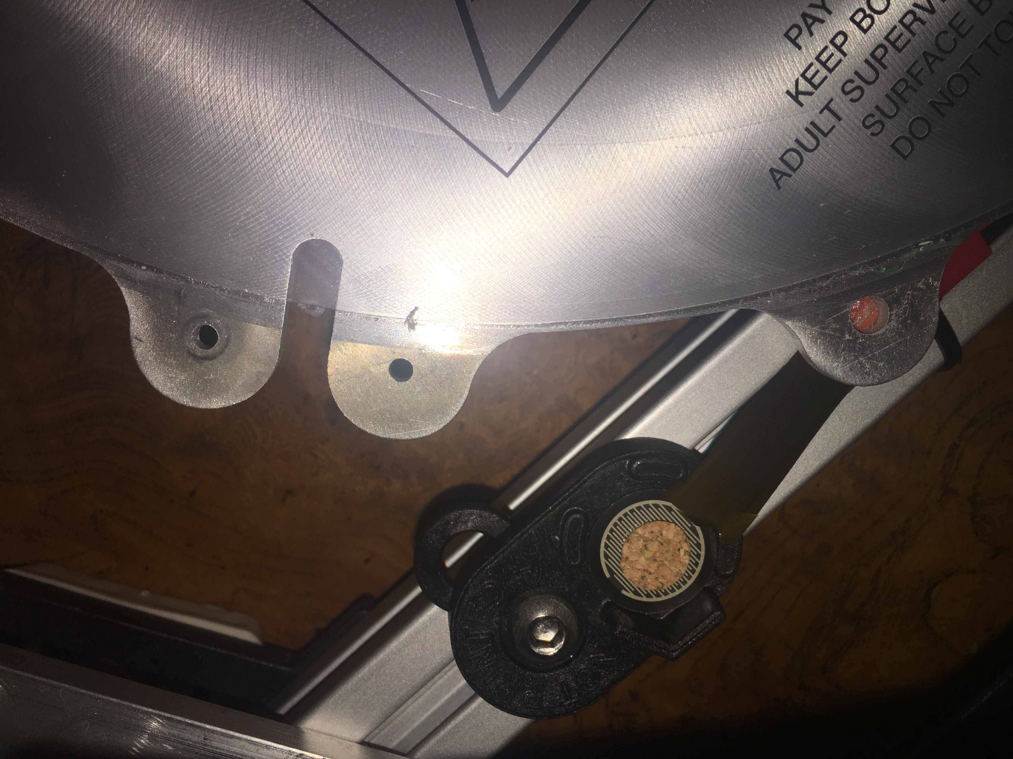

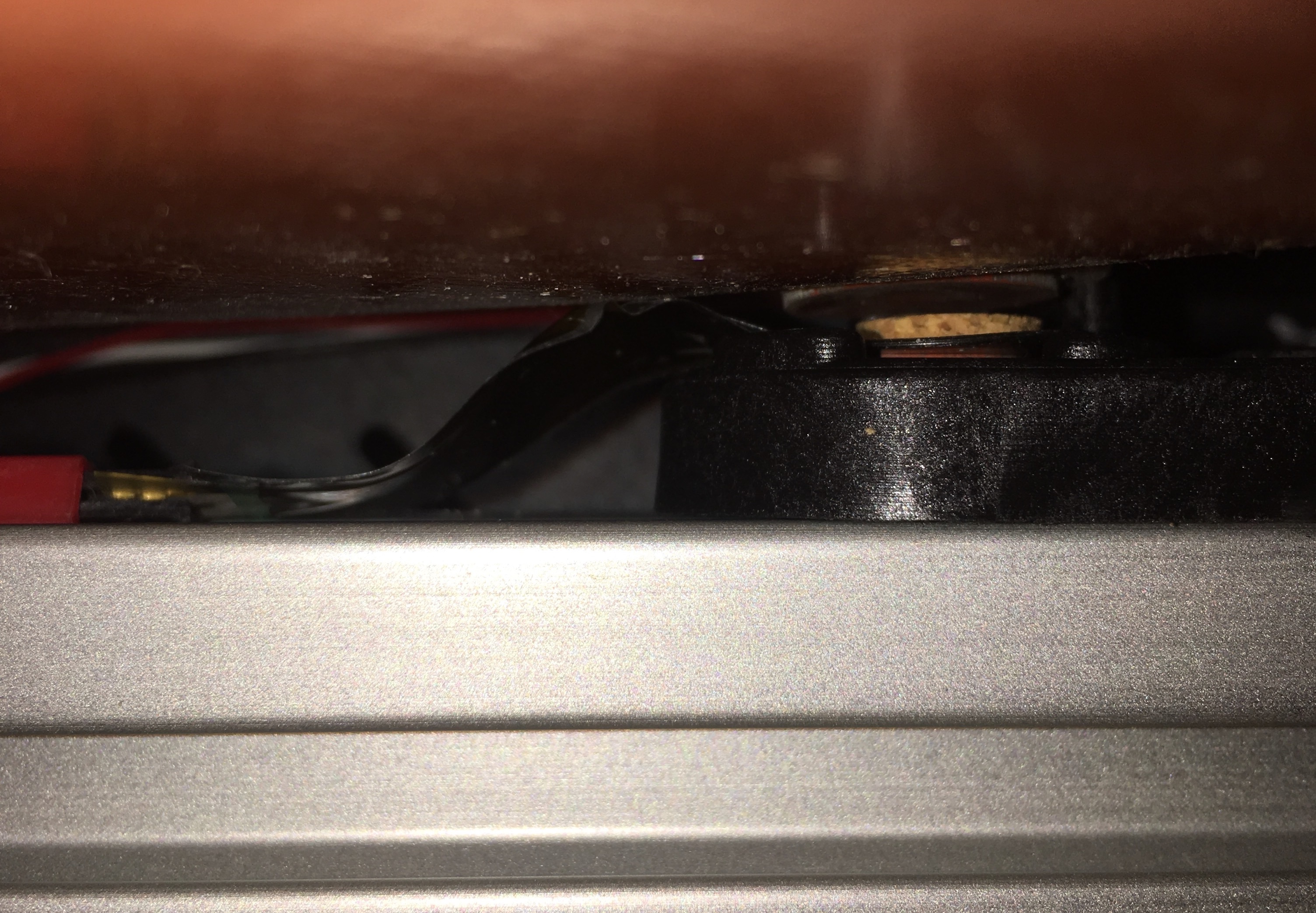

On to the FRSs not working when the bed it up to temp--60C.
I put the big guy on it's side on the table so I could see the bottom and took some pictures of what I could: The others had their cables neatly flat on the 8020, and out of heat's way. This guy (on the problem tower, pretty sure it's the Y, have to keep looking it up) was curled up and flat against the underside of the bed heater.
I thought, that ain't good, so I cut the ziptie and re-sat the connector along the side bar and re-ziptied it. Very hopeful, I righted the printer and heated it up... still no go on that tower at 60. Fine at room temp, just not 60. Z is really the only tower that triggers nicely. X is iffy, but Y is consistently unresponsive.
Looks like the FRS kit is a common one, so I'll look it up again and try to debug what to look for or how to protect the sensor pads.

In order to test the pads, and also because of Gene's post about bed clips and triggering, I took out the bed climps and raise the bottom's top cover as high as I could and clamped it there. I needed better access to the innards down there.
I noticed that the pad that works flawlessly has the connector go out away from the bed while the other two go under the bed. I spent the afternoon dissecting the lower area of the Artemis and lengthened one of the sensor wire sets so I can have all three pads extend out and away from the bed so their wires don't touch the bed. The troublesome pads worked "much better" but still not as reliably Z tower pad. They trigger now at 60C but Y stays on or doesn't come on as often as Y and X is only barely not as reliable as Y.
I then swapped the pads (probably should have done this first since it's easier) between Y and Z. Even better, but still not great. Y, with Z's original pad, still works just as good.
This makes me think that the position of the pads in their little nook is the key.
Looking online, I noticed the pads people use are usually slightly bigger than mine. Maybe I'll look into cutting some larger cork circles and try those. I know I've got some cork rolls somewhere in the attic...
Here are some pictures of the pads and the direction of their connectors so you know what I'm trying to talk about:
The start pad, connector go up and away from the bed: The sad pad, connector is barely visible because it goes under the bed: Same pad, but with the bed moved aside to show the connector's direction and the small cork spacer:

Phew, ok.  I'm in a "workable" but not "good" state now I think.
Deviation is now .1 -- .09 at 60C and .03 -- .02 at room temp. Is that reasonable? I hope not. I'd like it to be better at temp.
I'm not sure how to tighten up the FSRs... will need some help.
I didn't redo the cork spacers yet. They are stuck on there pretty good and I'm unsure if I can/would damage the FSR trying to pull it off.
As for the cork pads... any reason they don't go to the edge of the FSR inner circle? Why just a small bit on the inside?
