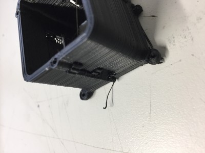

aerouta
Posts: 185
Re: Duet setup - instructions in progress
Post by aerouta »
dc42 wrote:
aerouta wrote:
aerouta wrote:Finally had time to get some work done on calibration when i notice this strange behavior, at least to me. I have posted a link below to a YouTube video. While doing the paper grip test I noticed that it was difficult for me to get consistent results. Then I noticed that the friction/force on the paper was varying significantly without any commands sent to the printer. I seemed to coincide with the bang bang control of the heat bed and sure enough, turned of the heat bed and no more fluctuations. Once the head bed is on, regardless of bed temperature it seems to lower the nozzle slightly.
In the video you will hear the friction on the paper increase at 12 and 25 secs
https://youtu.be/17Dt0IXVa1s
mhackney wrote:Might it simply be current fluctuations due to the bed heater are affecting the steppers?
This problem persisted after changing to "high dollar" PSUs and running a dedicated PSU for the Duet.
What solved it was changing the idle current from 60% to 100%. I believe mhachneys suggestion to turn off heaters during probing would also be good to consider, at least for bed leveling, maybe not bed grid compensation. But for paper grip testing the idle current should be 100%, there is no need to introduce additional variables to that process.
If the bed heater going on/off in bang-bang mode cause fluctuations in the paper grip, then it will probably cause print quality issues too. Try enabling PID for the bed.
you are spot on, I am having quality issues even with using PID. The banding is due to the heat bed. Any suggestions?
dc42
Posts: 454
Post by dc42 »
How stable is the bed temperature? Does the bed heater LED show a steady flicker when the bed is up to temperature, or can you see it cycling?

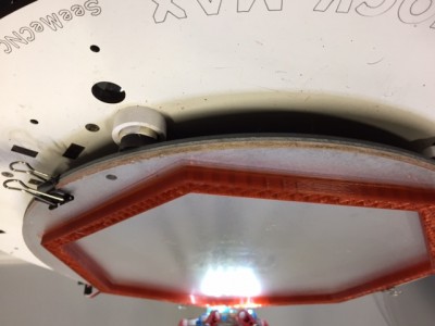

Any clue why the edges are being truncated?
dc42
Posts: 454
Post by dc42 »
That will be because the corners are outside the printable radius you declared in the B parameter of the M665 command.
aerouta
Posts: 185
Post by aerouta »
I looked everywhere for where the print radius could be defined.

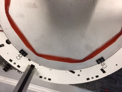

aerouta
Posts: 185
Post by aerouta »
largest footprint I have been able to print.
Though the first layer was not perfect. Depending on which direction(clockwise or counter clockwise) these loops where made changed the location of the thin area. Any clue what may cause this. My first though was hysteresis in the head movement. Does the Duet have the ability to have hysteresis settings?
Yes, you have some slop in your motion mechanics somewhere. It could be simple like loose belts or a loose stepper pulley or it could be sloppy arm joints. But something is not tight. Duet's RepRapFirmware (dc42) does not have backlash compensation. Sometimes reducing your acceleration values can help with this. In config.g:
M201 X1000 Y1000 Z1000 E1000 ; Accelerations (mm/s^2)
changes X, Y and Z to 200 and see if you get any improvements.
