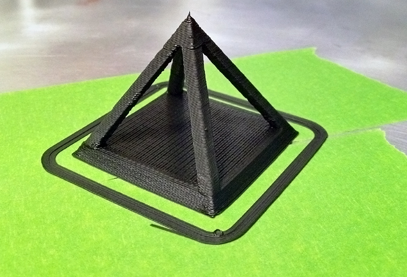

Hey Guys!
Its taken many attempts but here is where I'm at now. Printed with black PLA.
- 0.25mm layer
- 0.35mm nozzle / 188C
- KISS Slicer
Even though I have calibrated my filament I think I am still a tiny but heavy.
Brendin
Re: Rostock Max Hollow Calibration Pyramid Challenge!

Posted: Tue Mar 26, 2013 6:12 pm
by aehM_Key
Anybody tried it with ABS? I think it's quite hard..
Posted: Tue Mar 26, 2013 6:27 pm
by xnaron
aehM_Key wrote:Anybody tried it with ABS? I think it's quite hard..
I think ABS would be easier. PLA is very hard.
Posted: Tue Mar 26, 2013 6:35 pm
by mhackney
Agreed! Do any of your Cartesian printers have a Bowden? That has been the biggest challenge for me. A direct extruder is "crisp" in its retraction, the Bowden tube introduces some slop.
Posted: Tue Mar 26, 2013 6:53 pm
by xnaron
mhackney wrote:Agreed! Do any of your Cartesian printers have a Bowden? That has been the biggest challenge for me. A direct extruder is "crisp" in its retraction, the Bowden tube introduces some slop.
No this is the first bowden I've played with. I'm at 10mm for retraction right now. On my cartesian I am at 2mm.
Posted: Tue Mar 26, 2013 6:57 pm
by xnaron
Part of the problem I am having is that I cant get a reliable retraction speed above 30mm/s that does not occasionally skip a step. This is even with my stepper digipot set to 255. I think I need to get to at least 60mm/s to start improving things.
