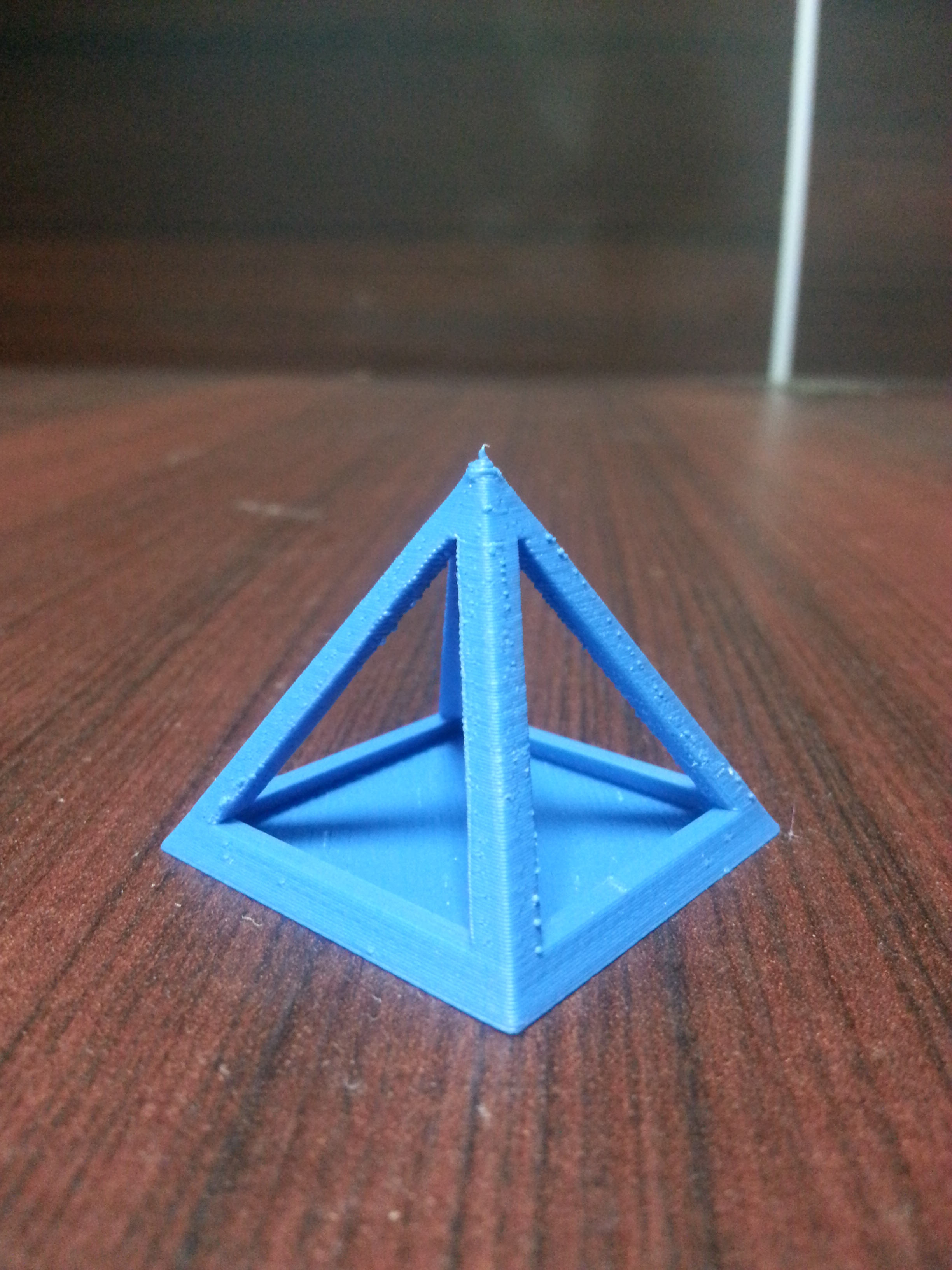

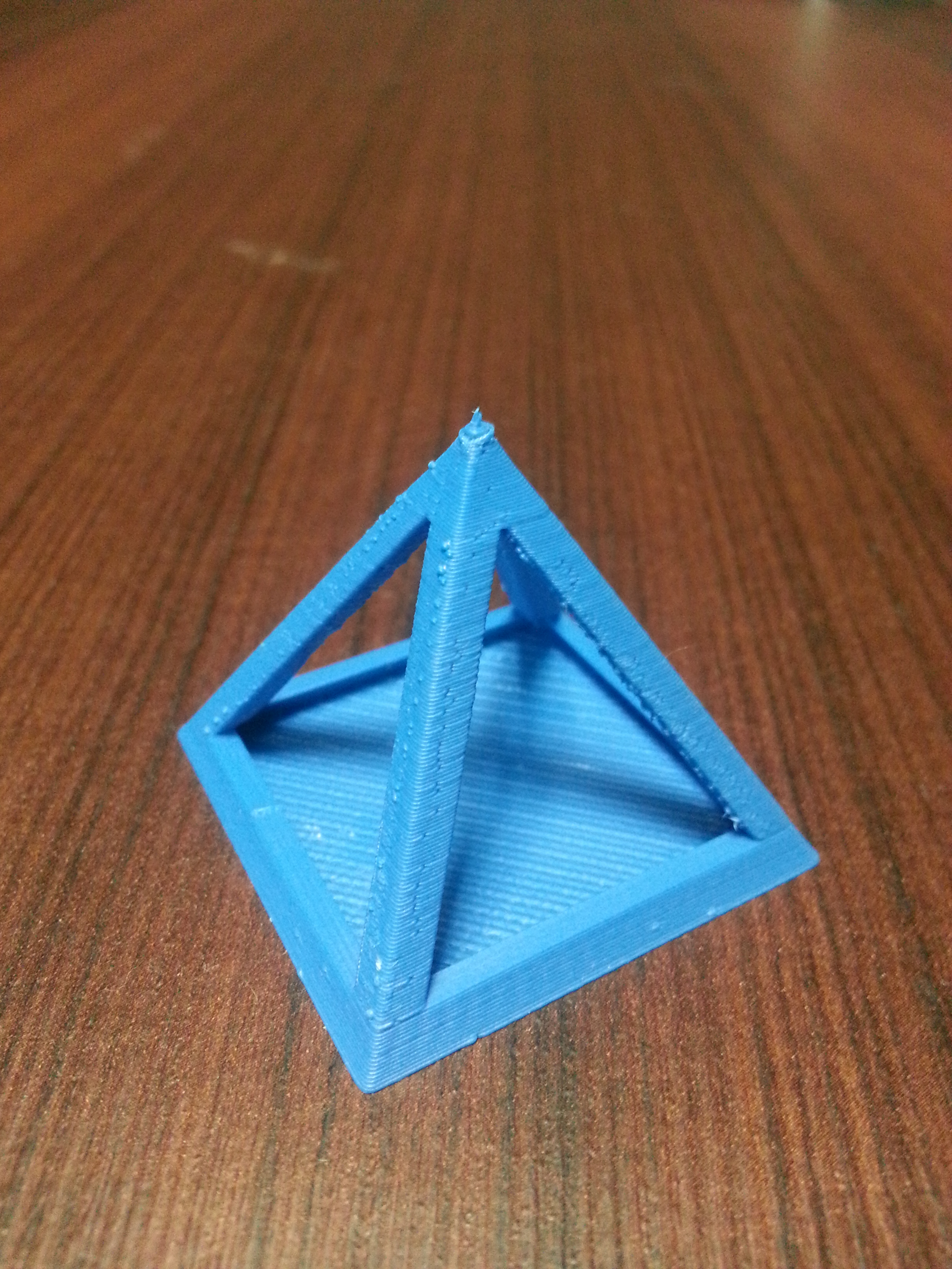

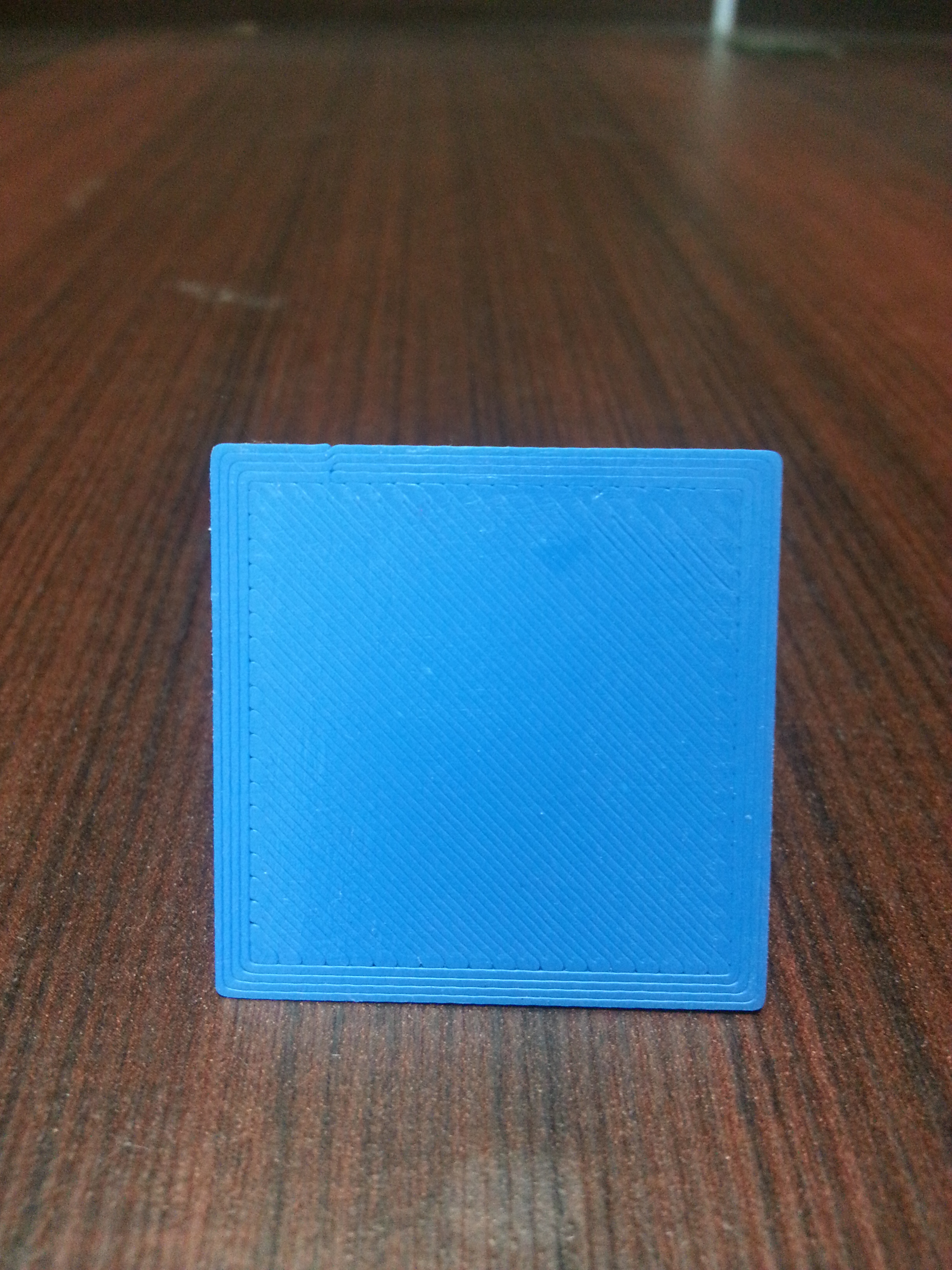

so this is using craftware... wonder what would help with the pitting...
the previous print was matter control with standard settings, 190 degrees PLA.
this time i tries 195 but standard settings in craftware more or less
any thoughts on improving?
both were at 20mm/s

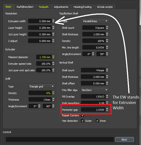

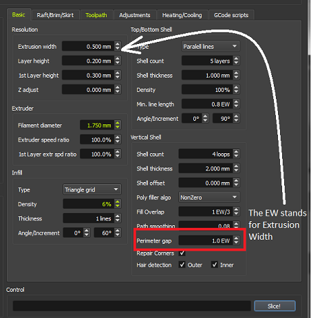

ok... so here is something interesting...
look at this picture I took of craftware after it sliced my project.
the layer start/end coincide really well with the print in the above post...
pretty interesting why they would do that...

Part of that could be due to whether or not you imported my settings.
If you did, I have my layer start and ends with a full extrusion width, so that could be the reason you see those wide gaps in the G-code. If you take a look at the setting in the screenshot below, this will affect the overlap of your extrusion and help to eliminate some surface blobbing if any should occur at layer start and finishes.
If you lower this number, those gaps should close up.

so yes, i am using your import.
so your using 1.0 for your Perimeter gap setting why? just curious, did you have bubbles or bulging when using .5?
what setting would you suggest I use for day to day printing? its interesting you have that set the way you do, are you having any such issues?

I get so many different kinds of PLA, that I'm a bad boy and don't usually bother to measure my filament width consistency, choosing just to set my filament width to 1.75mm...
Some filament was giving me small little tick marks at the perimeter gap, so I had widened the gap, never readjusting the setting after that particular print, because I've been printing cello parts lately and don't mind minor surface issues.
As far as day to day printing goes, it's definitely going to be filament based. You will need to check through all the settings for each filament roll you use.
Member MHackney actually does a VERY good job of this in his KISSlicer configs, if you've come across his color settings for different kinds of filament in your traversing these forums.

EDIT.... So the latest print was ok on the outside, fixing that EW setting worked... still having a bit of roughness on the inside of the pyramid but the outside looks great... ill keep working at it :)

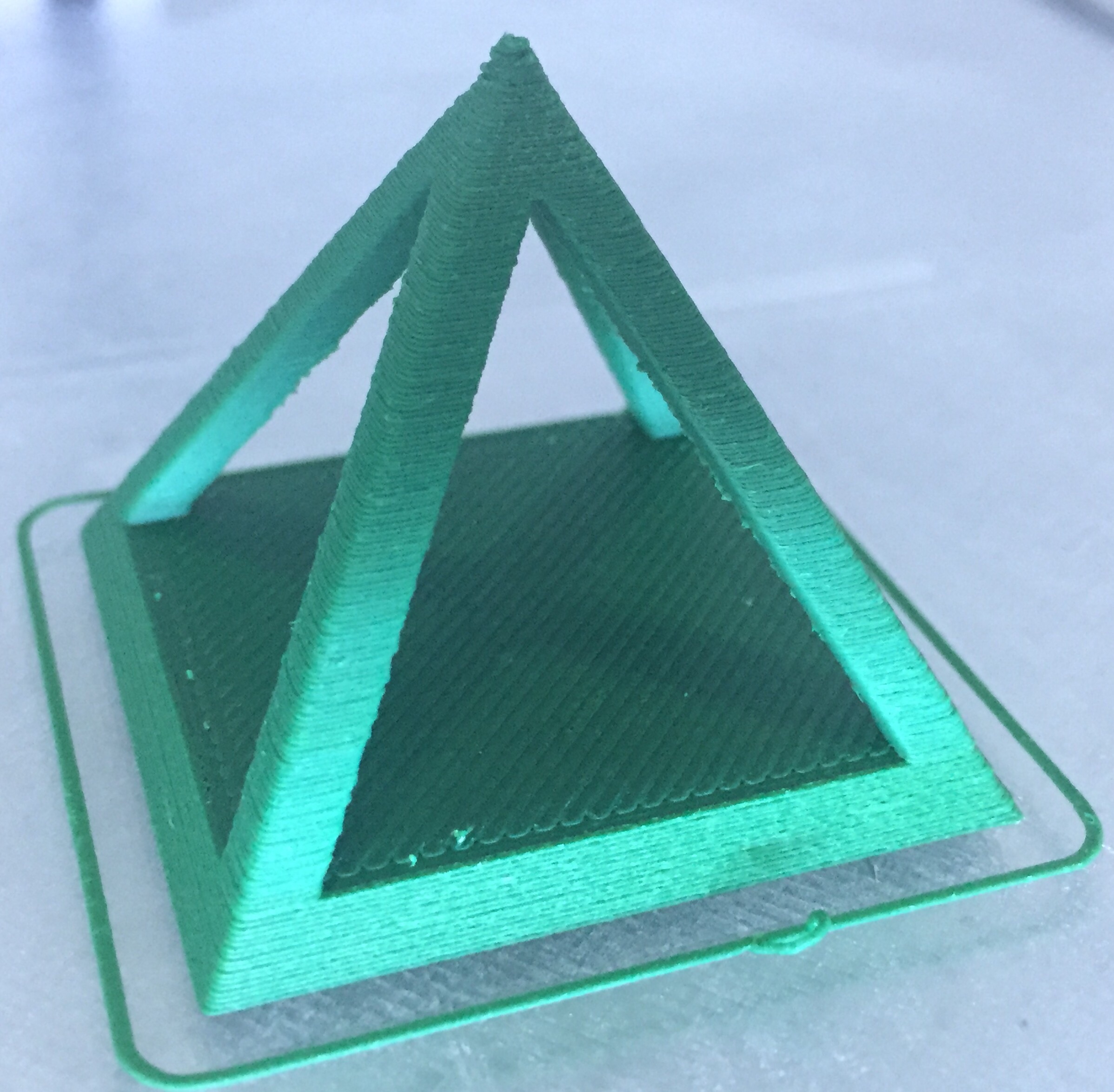

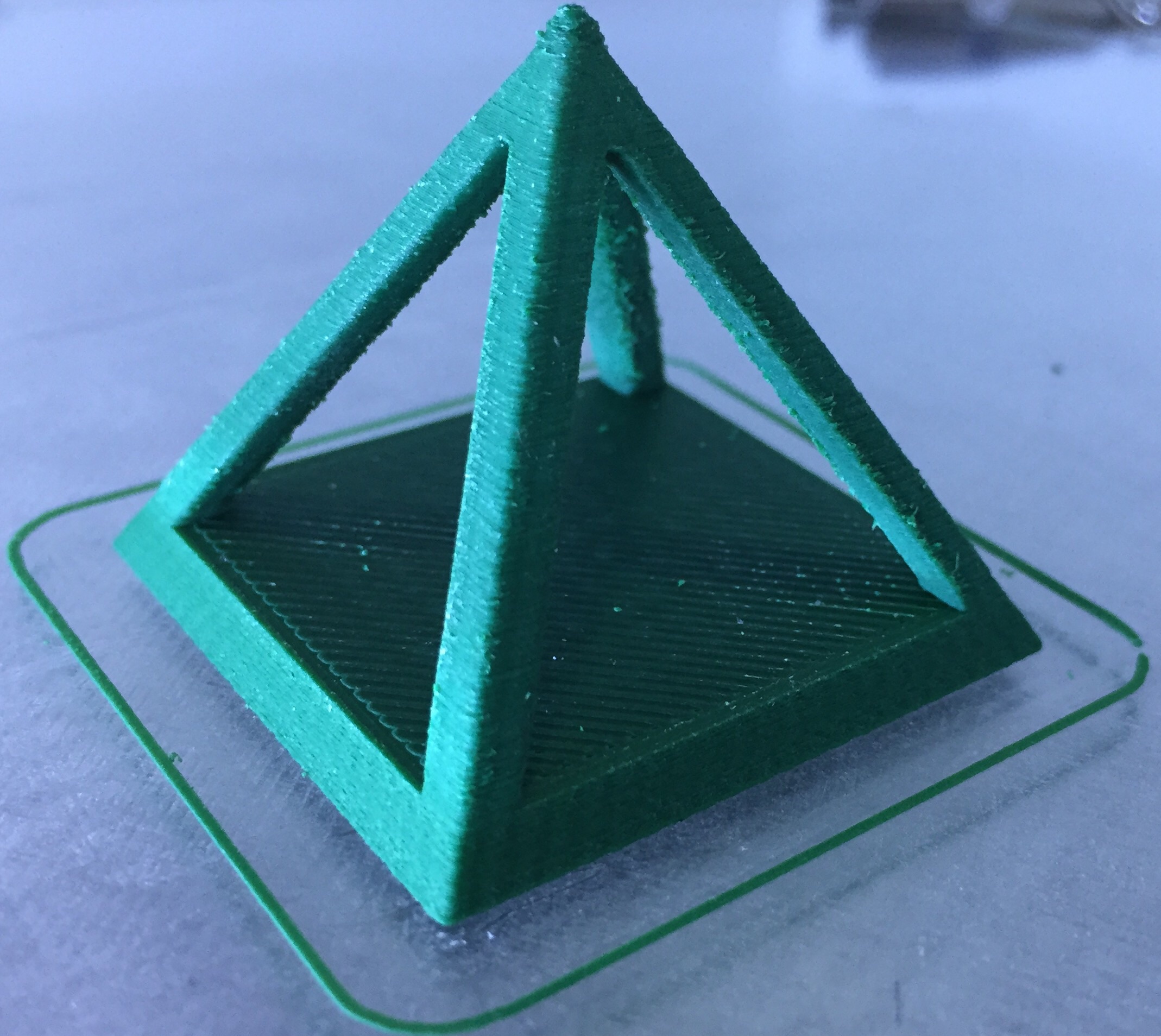

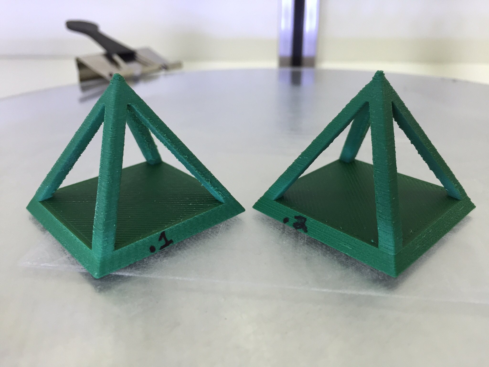

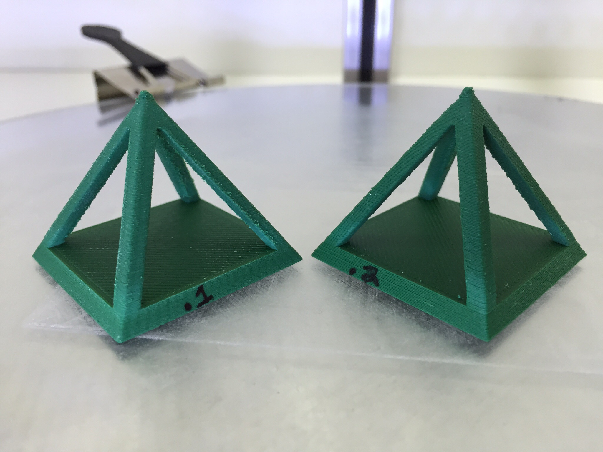

Round 2 over a year later
Green ABS!
Hot end 230c
Bed 98c
Speed
Loops 10mm/s
Solid 14mm/s
Sparse 30mm/s
Infill 33.3%
Extrusion width .44
Infill extrusion width .44
Seam hiding 1.0
Jitter 175
Wipe/destring on
Loops 3
Stacked sparse 1
4 prime/4 suck/5 wipe
Speed 55
Min jump 1.5
Trigger 5
Min layers 25
Zlift 1
Best ABS pyramid???
Both
Both
.1 layer height
.1 layer height
.2 layer height
.2 layer height

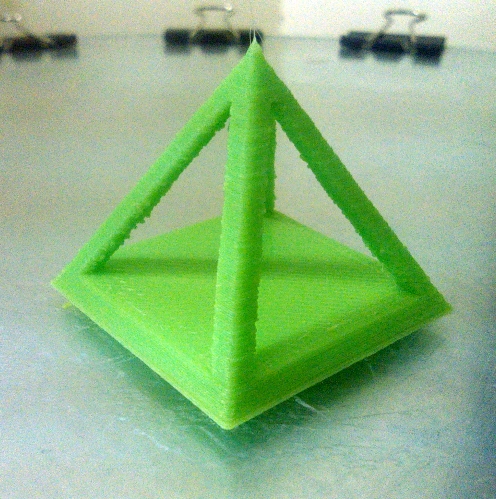

Hmmm... here is mine 205C Nozzle 60C heated bed, white glue stick ... the machine is not calibrated for dimensions yet... light green PLA....i think it took 45minutes to complete... seeing others i think mine is not that good... :cry:

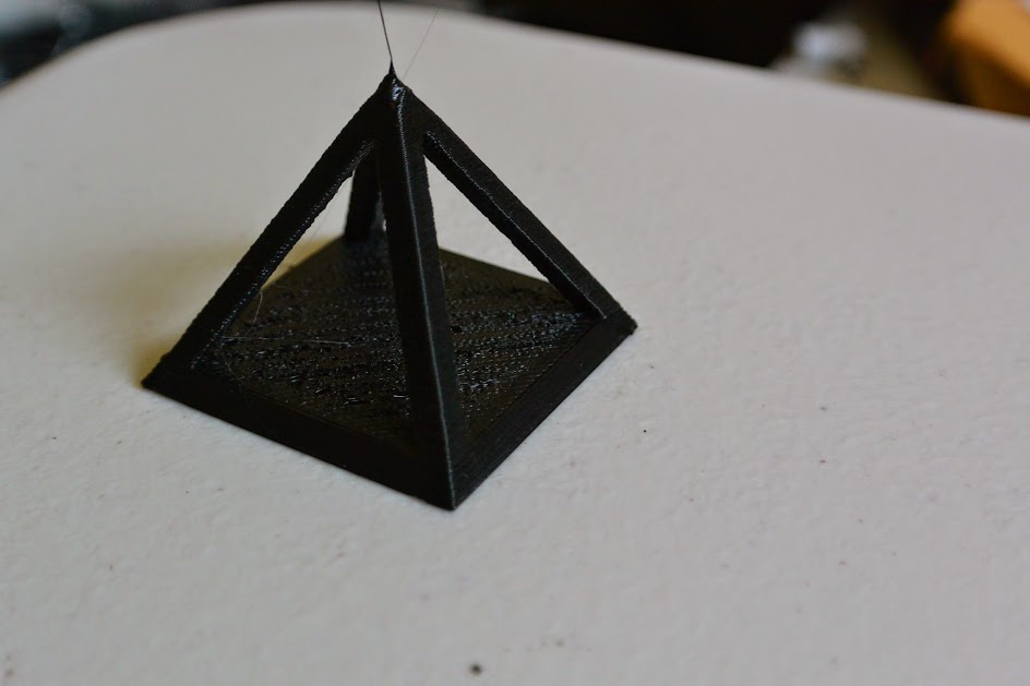

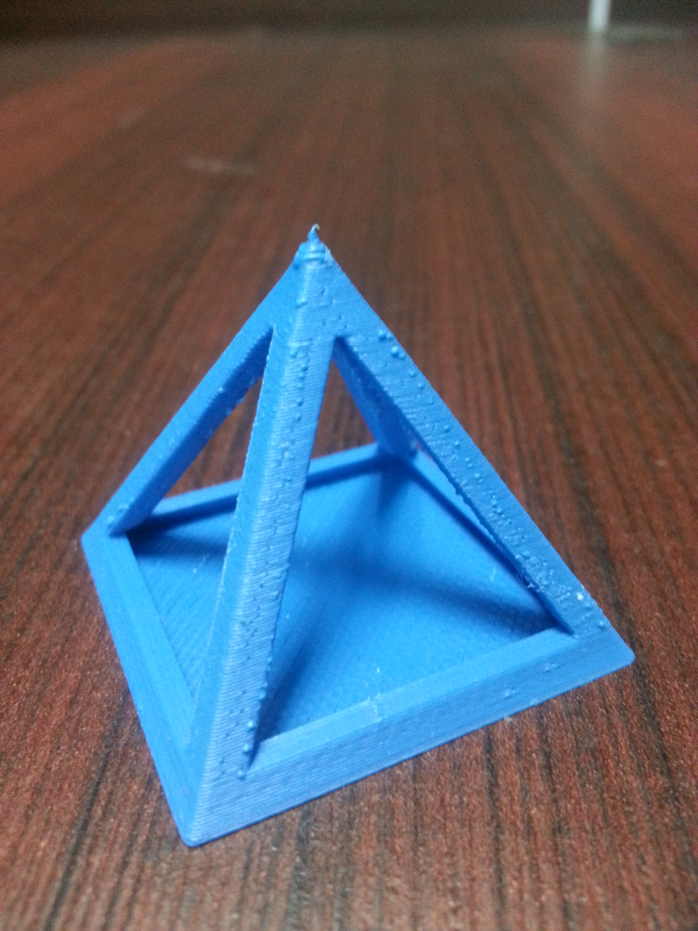

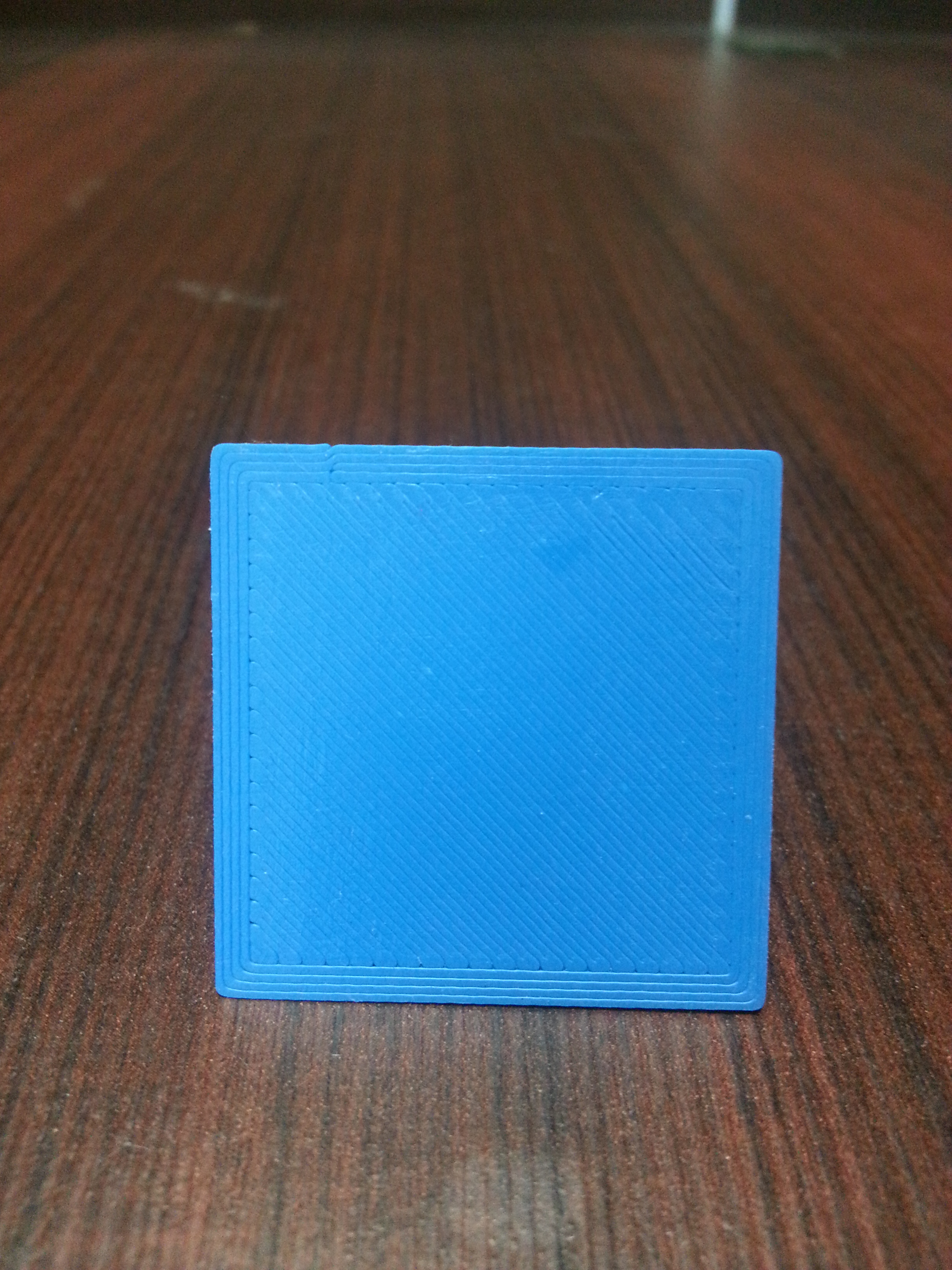

Here's my first attempt. Using translucent blue PLA filament at 202C and sliced with MatterSlice default settings printing at full speed. Result is some very thin stringing between some of the poles and a sharp point at the top, but otherwise it looks pretty good. I may try another with the heat turned down a hair and again using Cura. I'll post results if I see anything better. :)

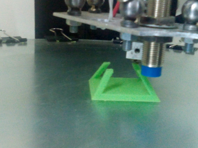

Khalid Khattak wrote:Hmmm... here is mine 205C Nozzle 60C heated bed, white glue stick ... the machine is not calibrated for dimensions yet... light green PLA....i think it took 45minutes to complete... seeing others i think mine is not that good... :cry:
Not a bad start but there is still room for improvement. Good news is your machine is capable it's just about learning your slicing software and ensuring your printer is fully calibrated. I make improvements everyday and honestly it's the part that I enjoy the most. Today I started using Kapton tape with my heated bed and found my ABS prints have drastically improved due to better adhesion:
[img]http://i62.tinypic.com/i4omqg.jpg[/img]
Sorry for the picture quality it's tough to take pictures with my phone while part is still on the print bed. This is really my first decent pyramid using ABS but still needs tuning IMO. Setup: 3D Solutech ABS "Metal Silver" Filament sliced with Simplify3D, 0.2 layers, 0 Infill, 225C hot end temp, 4.9 retract(little too much), 20mm/second print speed, 4 shells and fan set to 75% after first 5 layers but I plan to use 100% fan next time.

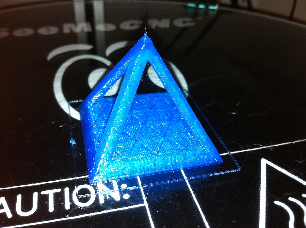

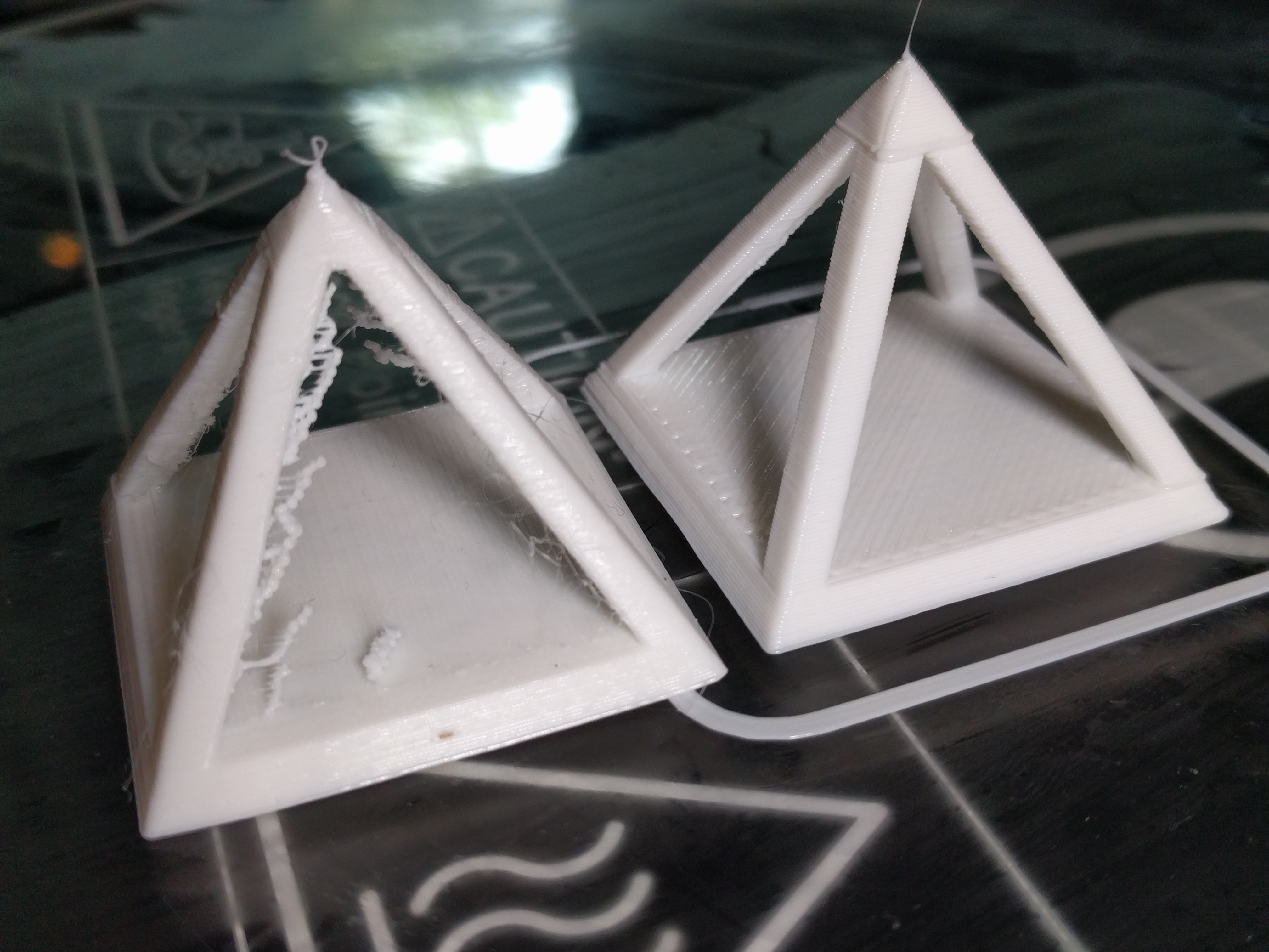

Hey All,
New member here.
I've been printing for about a month with decent results (i think) and decided to give a go at the pyramid.
This is my second try at the pyramid (first one was pretty bad)
I was wondering if i could get some suggestions and tips to get it better.
I'm getting some pretty bad "Z Scars" from where the extruder changes layers
Also some blobs on the outside and very bad blobs on the inside of the columns.
Here are the settings i used (on stock Rostock Max V2)
1.75mm SeeMeeCNC ABS
Sliced in Slic3r
Temps:
Extruder 225
Bead 85
0.2 layer height
0 infill
4 Perimeters
2 bottom layers
0 top layers
3 mm retraction at 100 mm/s
0.25 Z lift
Retract on layer change: TRUE
Layer fan at 100% after 5 layers
Print speed: 30 mm/s
1st layer speed: 15 mm/s
Travel speed: 250 mm/s
1st layer width: 0.6
Extrusion width: 0.5 (stock nozzle)
Appreciate any help,
