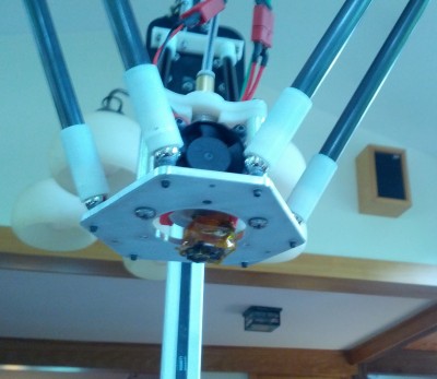

The ease of disassembling this set up provides is phenomenal. It is so much easier to disassemble the hot end and effector with it connected to magnets. I highly recommend this set up.
Thank you for this wonderful idea. Magnetic holders it is very cool!

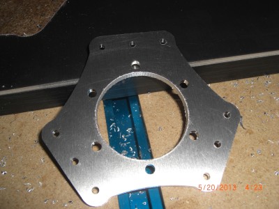

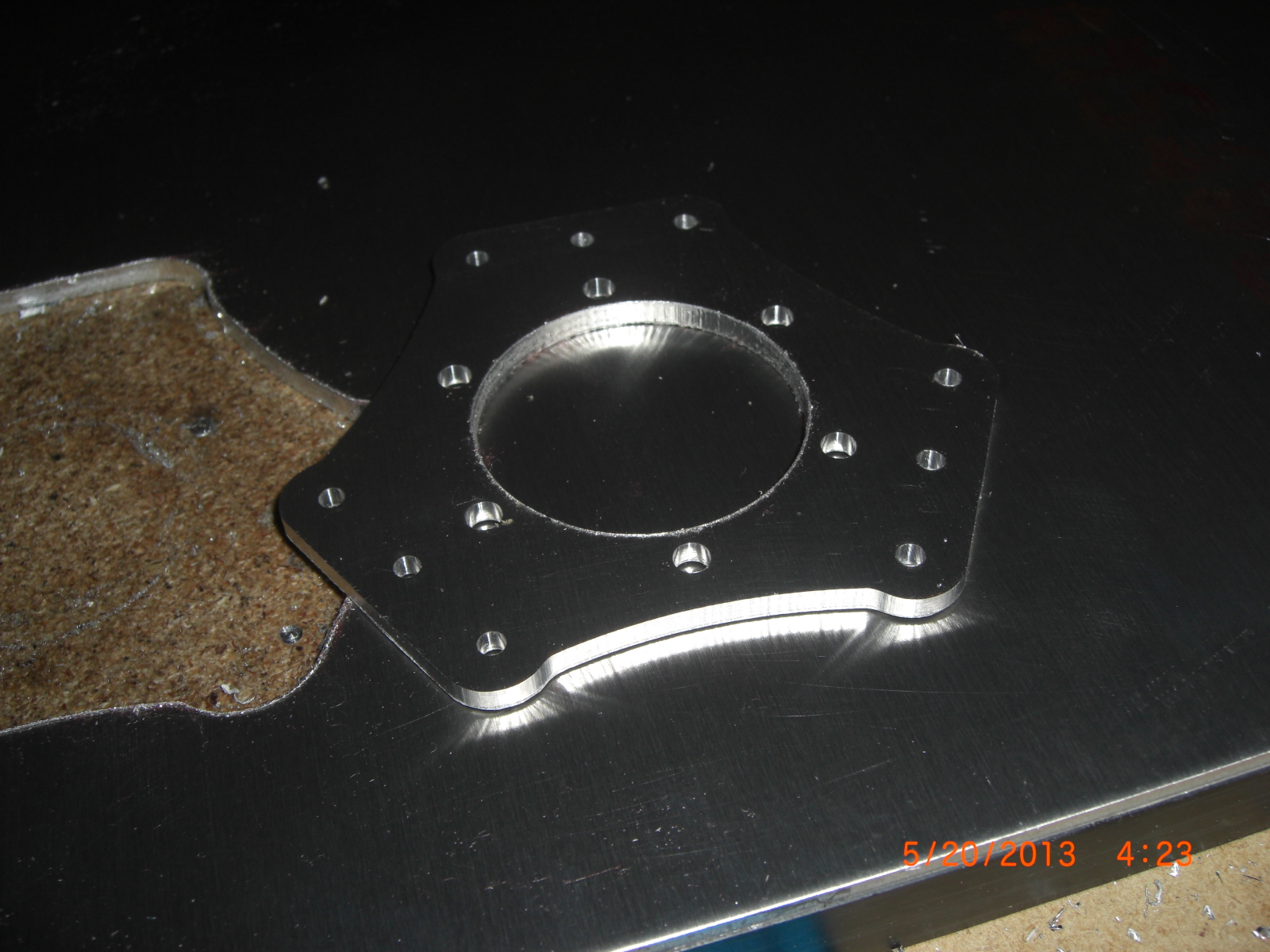

all aluminum platform for xnarons conversion prototype
prototype made

You could free up some space to make the aluminum effector a bit smaller by rotating the inner hole circle 30 degrees.

I detect a VCarve Pro or Aspire user...
Funny because my artcam sensor is going off on that one.
Did you create your own effector model? Or did you modify xnaron's?mrblade wrote:Thank you for this wonderful idea. Magnetic holders it is very cool!

Wow MRBLADE that is a thing of beauty!!! Well done! What size tap did you use? Would love a copy of the .stl
I create my own effector model.
[img]http://cs403126.vk.me/v403126555/7d3c/eLC1L2JOYco.jpg[/img]
I use cylindrical tips for D10mm magnets and D10mm carbon tubes.
Screwed M4.

Flateric, the funny thing is that the guy that did most of the work on Artcam left and started Vectric and they produce VCarve Pro and Aspire. They bring Artcam quality to the table without having to pay Artcam prices for it.

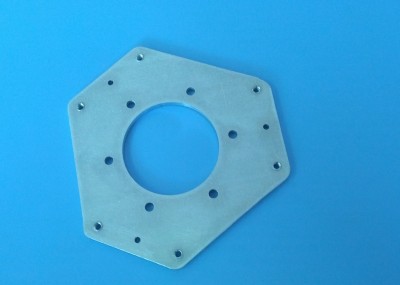

I thought I'd try out a flat aluminum effector plate with the mag arms today.
Though close, it makes it within my work volume (-120 through 120mm) without the rod ends touching the 3mm cap screws the ball bearings are sitting on. Here is a shot at Y-120.
Now I've got some Z travel back.

looks good. I prefer this method over the original design for durability of the aluminum plate against heat.
I have found that heat was not an issue. If you are really concerned you can print it out of abs instead of pla.cambo3d wrote:Broose wrote:I thought I'd try out a flat aluminum effector plate with the mag arms today.
