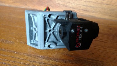

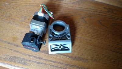

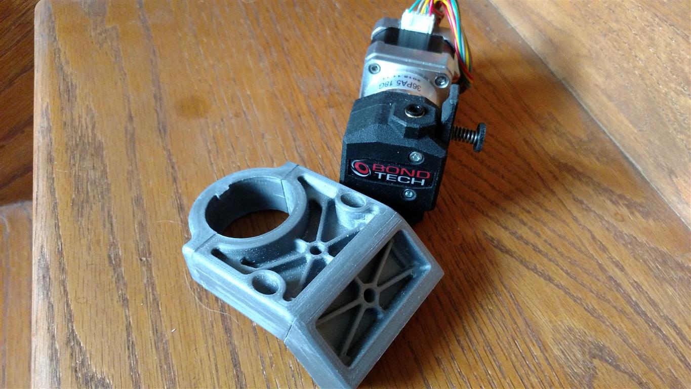

There is a single STL but it consists of two parts, easy to draw this way. I just busted them apart with netfabb into two printable files.Eaglezsoar wrote:This may seem to be a stupid question but it is not my first. Since the mount is printed in one piece, are we to cut it at the defined lines so that it can be bolted around the Bondtech QR?nitewatchman wrote:mhackney wrote:So it's verified that V2 has 50mm spacing?
I'll update Martin so he can make a V2 version on my mount. He is planning to post the STLs for these on the bondtech web site.
Meanwhile, a comment on orientation. It is much better to orient the mount the way I have it in my original STL. The "overhang" part of the base is 45° and prints beautifully in that orientation AND you'll get nice round, clean holes for the stepper clamp. In this orientation, the stepper clamp holes will be difficult to print cleanly.
Clamp printed standing up. Original BondTech received with extruder was printed flat, it has a layer split through one of the clamp bolt holes. I did not want the layers running parallel to the holes. Guess a split the other way is not much better but the section is heavier.

Got around to finishing a mount and getting the BondTec Extruder mounted and I must say I am impressed.
Print smoothness is greatly improved and I guess I don't really understand why unless the non-geared extruder speeds are a lot less stable than I thought.

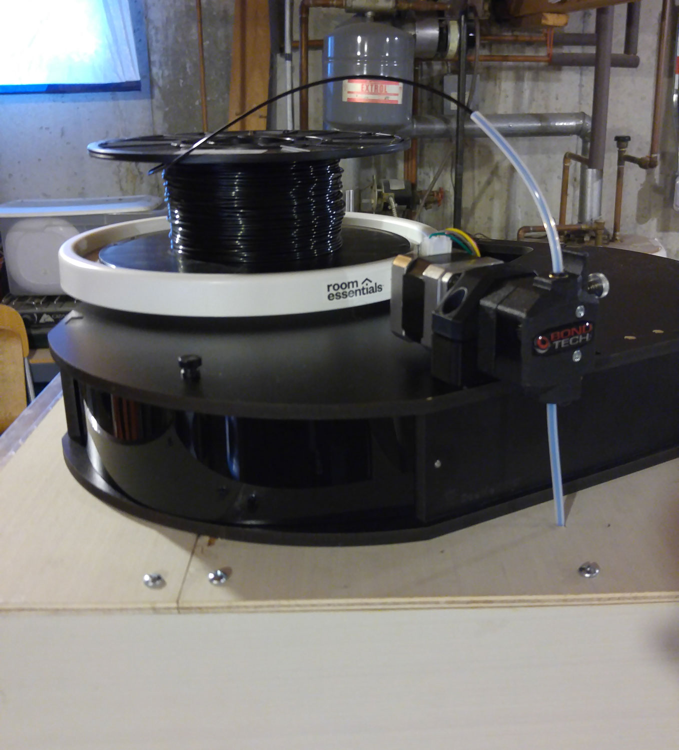

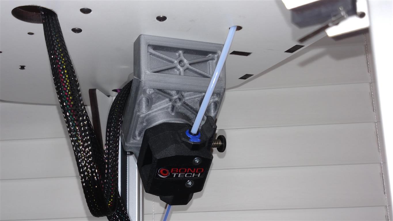

Received a couple BondTech QR 1.75mm filament drivers with Bowden attachment 2 days ago.
Very nicely built devices.
The quality of the 3D printing on these gives me something to aspire to achieving.
Thanks mhackney for the recommendation and info on these.
Confirming an earlier post, this wiring for QR to Rostock MAX v2 works perfectly:
Gray (QR) - red (stock wire )
Green (QR) - black (stock wire )
Yellow (QR)- white (stock wire )
Red (QR)- green (stock wire )
Started with 490 steps/mm and calibrated as suggested. Found that the first QR dialed in at 470 steps/mm.
Taking mods one step at at time, as I am new to 3D printing and this is my first machine.
So started by installing one QR to replace my EZstruder which was having intermittent filament slipping problems.
Driving filament through stock hot end for now.
Next mod will be installing the second QR and an E3D Cyclops.
Pictures of QR mounted to the top of my MAX, pulling filament from roll on a lazy Susan, and feeding into the top of heated enclosure. Second QR will mount along side it later.

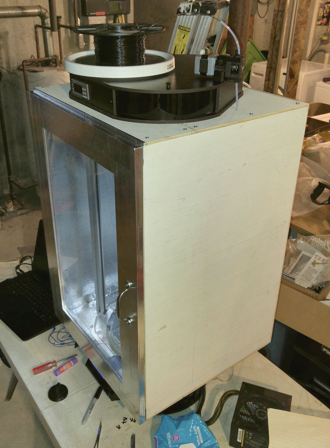

Sketching out using either the one I printed from rostock file with the angle Based on Hackney's with 50mm spacing or the Delta 22 version at the edge of the top plate seen above with I am guessing the standard bond tech mount. which I will print while I am deciding..
since I do plan an enclosure as a future build project either will work but if I use the the Angled mount i will have to remove the spool holder and print a new one But right now I am thinking I will go with the Delta22's lazy suzan.
given the summer humidity here on the Maine coast I am thinking of a dollar store plastic cake box to cover the spool and lazy suzan to keep what ever filament is mounted dry.... I have some .50BMG ammo cans that I think will work for the other opened filament storage with the silica gel packets.
Re: BondTech QR Extruder Tip #1 - Calibration

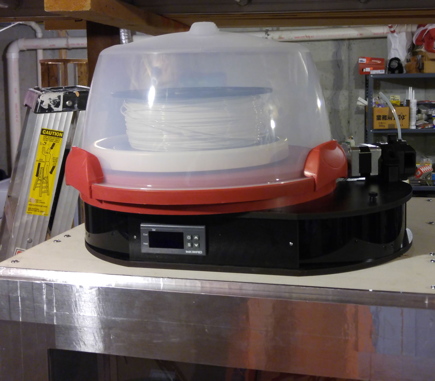

Windshadow,
Yes, that is the BondTech standard mount on top of my RS MAX.
Had the same thought as you regarding a cake box. Picture shows 14" (max diameter) cake box containing 10" lazy Susan both picked up at Target. They fit together well. Haven't set it up for use yet as the winter air is relatively dry.
Considering options with the cake box as the MAX will soon be a dual filament machine.
