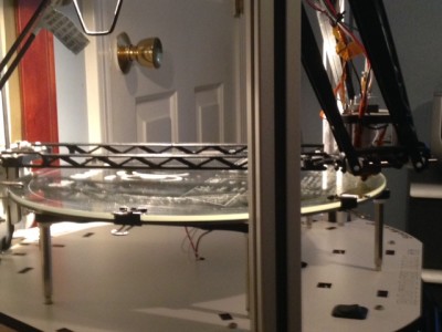

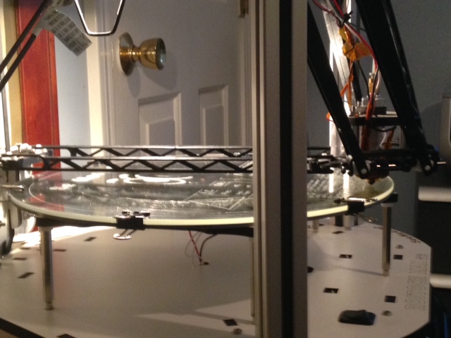

Meantime, of necessity, I have found a way to address issue #1 by raising the Build Plate
onto 2" circuitboard spacers. That gets the nozzle at least far enough out for my purposes.
Check it out:
Note the horizontal Delta Arm. If you try this with your on-base bed, you will see it cannot be done (I'm not going to paste a pic of that after all, cause they're in my other computer.)

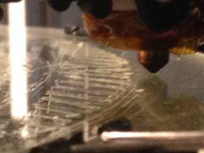

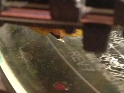

Now see here how the nozzle is still significantly within the 11&quot; line? <br />No, because it's a shitty picture?
Now see here how the nozzle is still significantly within the 11" line?
Ok here's a closeup with the line visible - better?
http://forum.seemecnc.com/download/file ... w&id=10081
It's not all the way to 11", but significantly closer - enough for my purposes at least.
