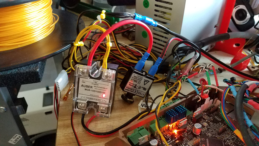

Here's a question that keeps bothering me. Why is it "right" to put the SSR on the ground side of the circuit, and "wrong" to put it on the hot side? Isn't it safer to gate the hot side?

It's neither right nor wrong. It should work on either side of the circuit, so long as you can keep the correct polarity on the SSR.626Pilot wrote:Here's a question that keeps bothering me. Why is it "right" to put the SSR on the ground side of the circuit, and "wrong" to put it on the hot side? Isn't it safer to gate the hot side?
When telling someone else how to do something it's way easier to pick ONE solution and document that. Some people work better when given an exact solution, especially if they don't quite understand it. Doesn't mean there aren't a dozen other ways to do something.
It's safer to FUSE the hot side. The SSR isn't a fuse.

Then, I suppose a breaker on the hot side.

I agree, I would put an SSR in the hot side of the bed circuit.626Pilot wrote:Here's a question that keeps bothering me. Why is it "right" to put the SSR on the ground side of the circuit, and "wrong" to put it on the hot side? Isn't it safer to gate the hot side?

I thought so. If the bed has +12V of potential even when the heater is supposed to be off, it's one more way for a short circuit to make something bad happen.dc42 wrote:I agree, I would put an SSR in the hot side of the bed circuit.

Switched the SSR to the hot (+12V) side of the circuit, and added the Blue Sea Systems 25A breaker to the circuit.
Wiring is now:
+12V -> SSR+
SSR- -> Breaker's "Line" terminal
Breaker's "Load" terminal -> Onyx+
Onyx- -> blue crimped pin gizmo -> GND
The pin gizmo is throwing off less heat than the wire nut, and the back of the SSR is very close to room temperature. The circuit characteristics have changed enough that PID control keeps overshooting, so I have to finesse that back into shape.
I have also adopted a safety protocol that I learned the hard way, last week. I had the high-current wires on the SSR reversed, and when I turned on the PSU, the heat sink got very, very hot within a minute. This was WITHOUT the heater being turned on in the controller! I had wired it backwards, and apparently, that's what an SSR does when you do that. They are NOT bidirectional! From now on, any time I touch the SSR wiring, I will turn on the PSU (without turning on the bed heat on the controller) and keep my fingers on the heat sink for a minute. If it doesn't get hot, I probably got the wiring right.

Okay, this is interesting! After hand-tuning the PID variables, the heater is staying within 0.1C of set point, almost always exactly 75.0C, AND I don't have to lower the max PWM like I did before. I put that variable back up to 255 (maximum value), and it works fine. I think putting the SSR on the +12V side of the circuit is doing something to the electrical characteristics that makes it easier to hold a steady temperature than when it was gating the ground side. Maybe there is some kind of "inertia" going on.
The temperature control is very nearly as stable as it was when I wasn't using an SSR at all. In this configuration, my guess is that standard deviation is less than 0.01.
