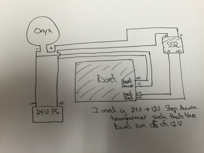

I just upgraded to 24V and so far (limited use) it has been awesome. My bed heats to 100 degrees quicker than the HotEnd gets to 220 degrees!!!
I used the Mouser (http://www.mouser.com/ProductDetail/Mea ... 5rFg%3d%3d) 24V, 31.3A power supply stock # 709-RSP750-24. I then used a step down (24V to 12V) transformer http://www.amazon.com/gp/product/B00BWK ... ge_o04_s00) to power the Duet and other 12V dependent items (i.e. DueX and my chamber temp probe). I then used the solid state relay (SSR) that was detailed by mhackney (http://www.auberins.com/index.php?main_ ... cts_id=288) which is activated by the Duet to power the Onyx with 24V. Here is a rough drawing that details how I wired the system, minus the 24V to 12V step down transformer.
Re: Heat bed + Bench PSU
That is awesome. that drawing makes it really easy for me. If its working well for you maybe i will give a similar setup a try. Thank you very much.
