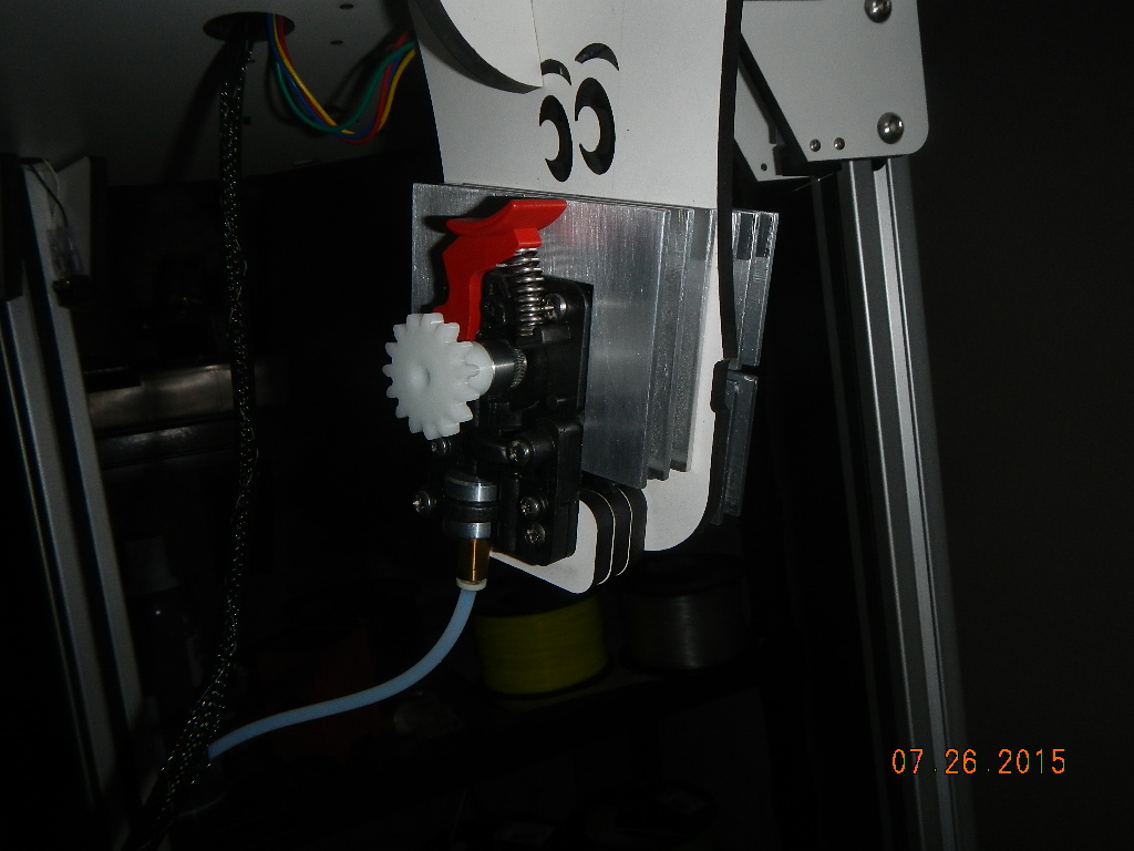

I'm having trouble figuring out why my stepper motors on my V2 Rostock are running really hot. I know its not normal, because I have a V1 Rostock and the motors on it run considerably cooler. The extruder motor is getting hot enough that its actually softening the pla filament as it passes over the drive gear into the bowden tube. This has caused several clogs and lots of frustration. The firmware is the latest version that came pre-installed on the V2. Could this be an issue with the current settings for the motors? If anyone has any ideas or experienced similar problems, I would love to find a solution. my V1 prints almost around the clock without issue, but this new V2 is proving less reliable because of the excess heat.
All the steppers are equally hot while running. too hot to touch for very long without getting burned.

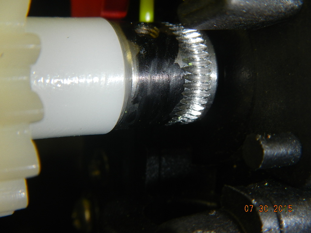

I am also having this issue. all steppers running hot and giving a high pitched annoying sound. the extruder is stripping my filament now as well which is really unfortunate because im trying to calibrate it so that finally use this blasted printer. Im thinking this could be the cause of my under-extruding issue.
Kysan 1124090 7951 steppers
printing octave red abs @ 215c
I have not changed the config.h file just yet. did anyone have any luck with this?
Having so many issues with this printer. It was a much larger project than I expected.

215 sounds very low to me.. this will essentially be putting more backpressure on the motor causing it to do more work.. and get hotter.
Considering your chewing up your filament in the feeder... does seem to confirm this to me...
I don't think any ABS I've got I run at <225 DegC - normally 228 - 233.
Lots of stuff on setting current power for the steppers- here's one I know about..
http://forum.seemecnc.com/viewtopic.php ... san#p60744
If you have Kysans the default power will be too high so you really should change them IMO as they will run hotter than they can..
