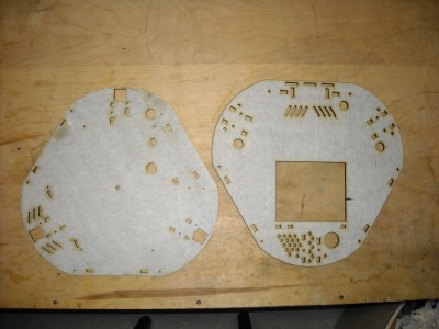

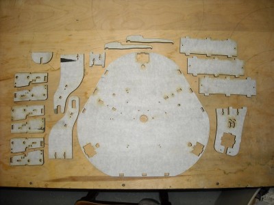

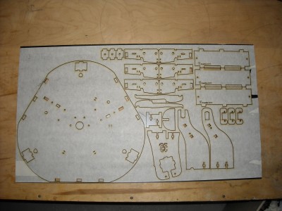

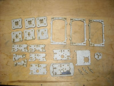

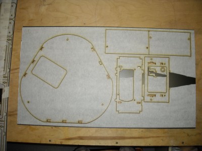

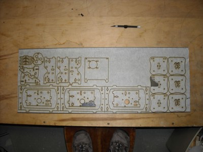

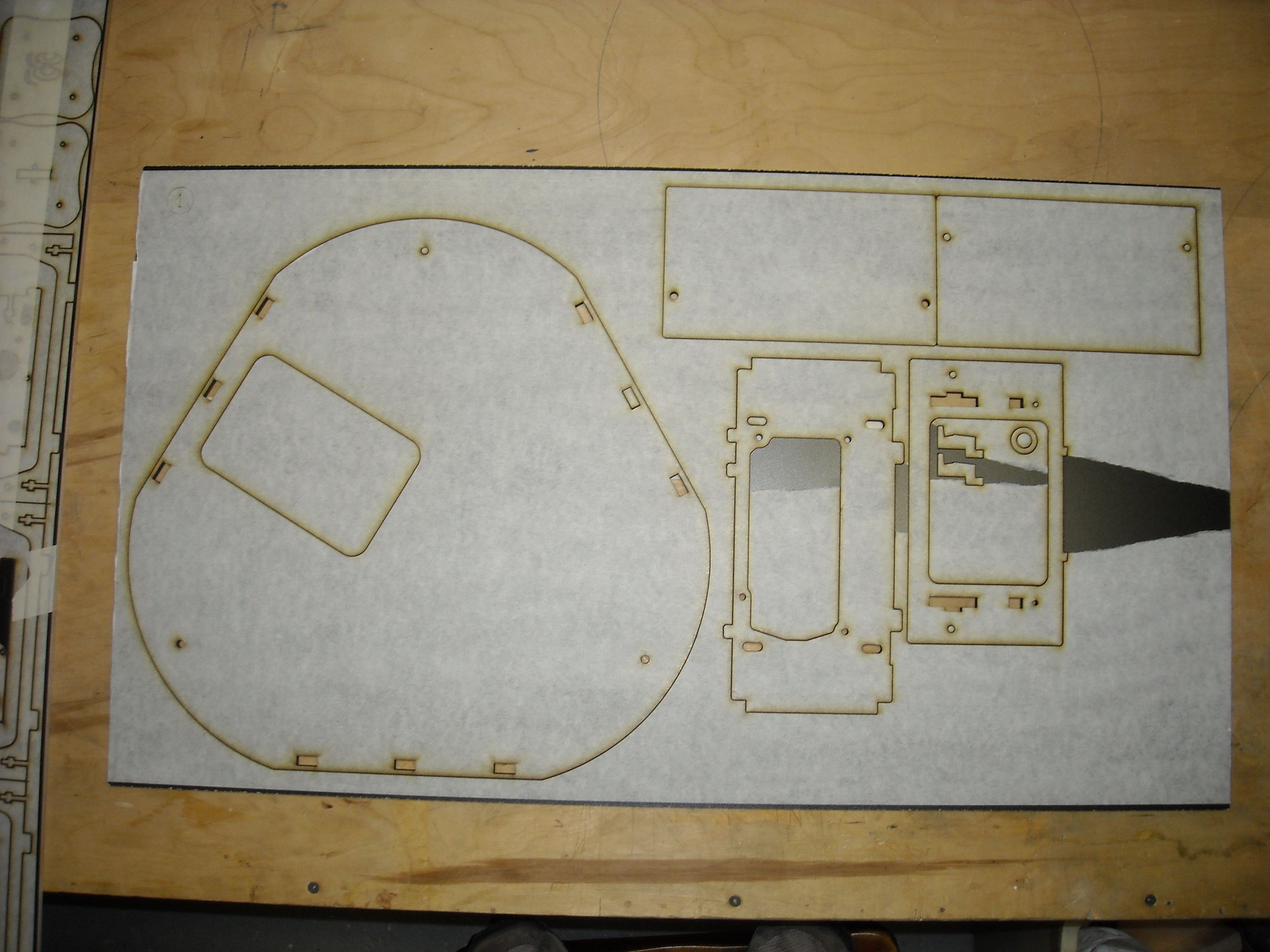

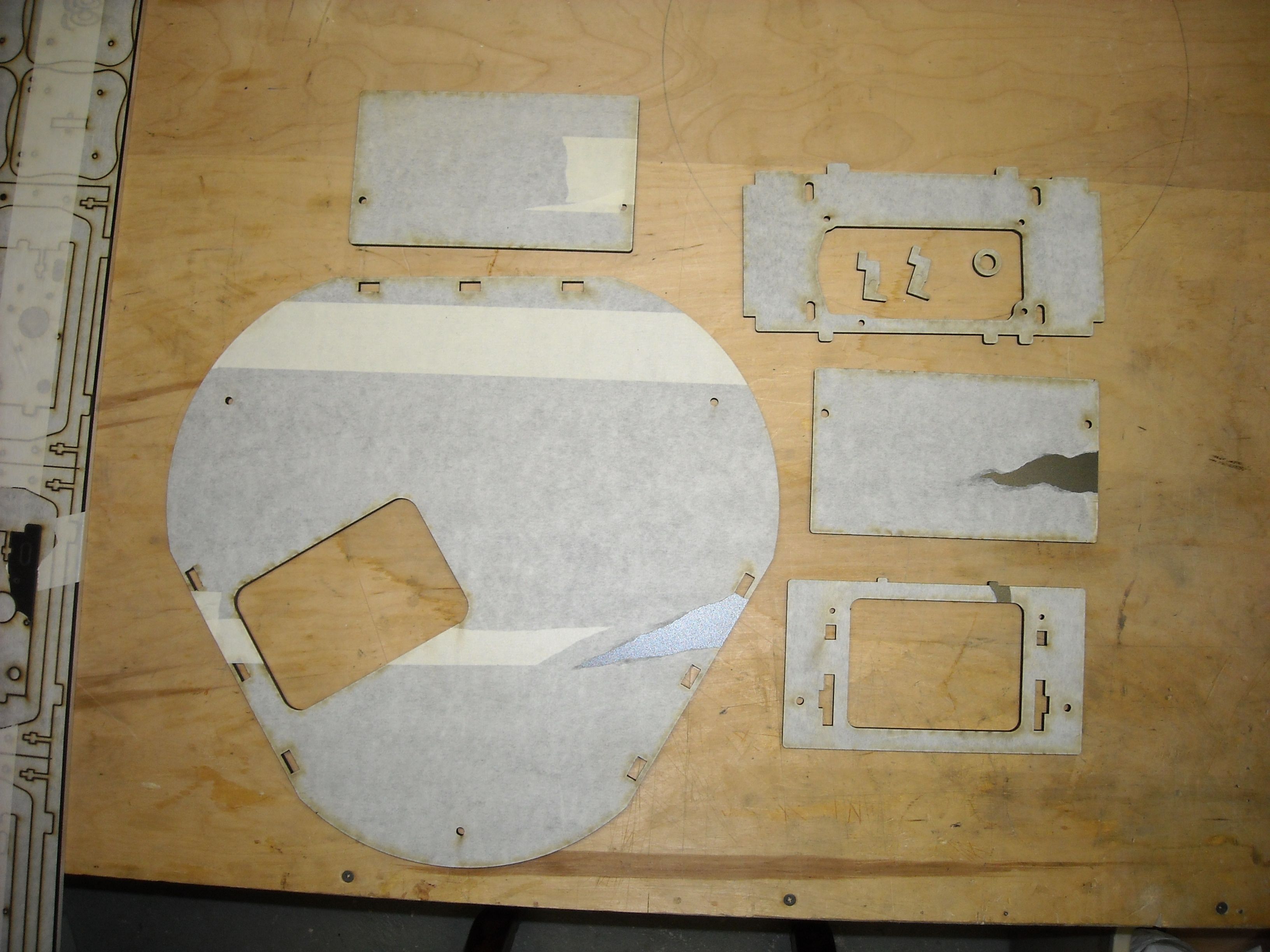

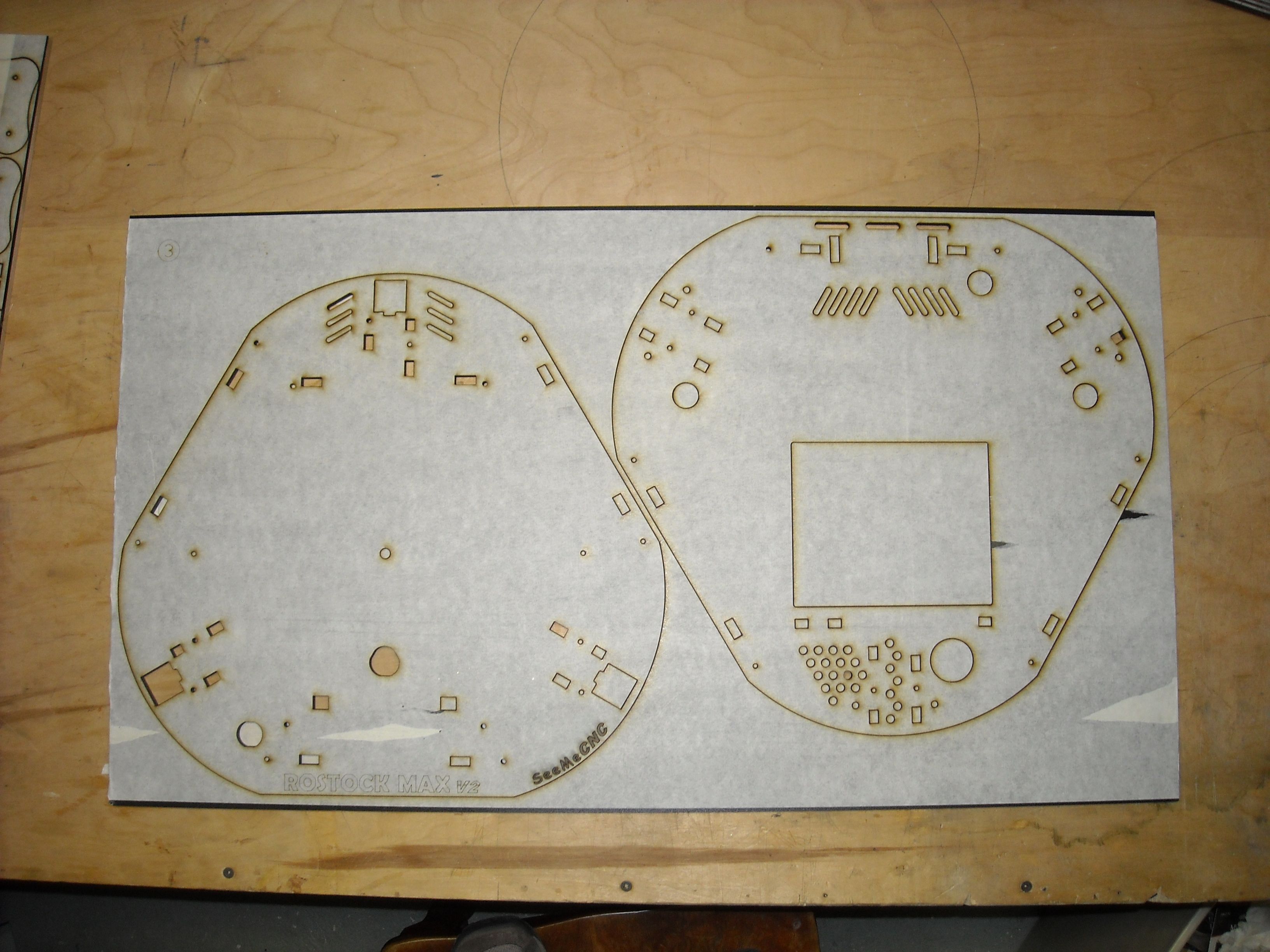

Well, I've started opening up the various bags and wrapped packages, and SeeMeCNC has rearranged the parts on the melamine sheets since sending you your kit. I'll take and post pictures of mine.
dtgriscom
Posts: 205
Location: Wakefield, MA
Post by dtgriscom »
Here are photos of my kit's melamine sheets. It looks like SMC rearranged and spread things out a bit, which makes sense since the cost of the material is pretty minimal.
On the fourth sheet, I wasn't able to separate one piece, as the laser hadn't even penetrated the bottom laminate sheet. The laser kerf is too narrow for my #11 blade to get through from the top, and I'd be completely winging it if I tried to cut from the bottom. I'll be asking SMC for a replacement.
Gene, feel free to use the photos in your manual if you find them useful.
Dan
