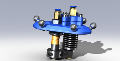

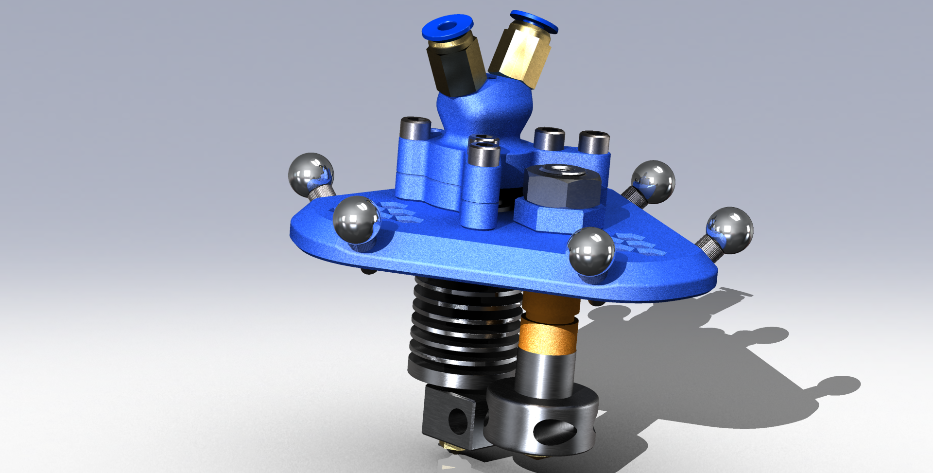

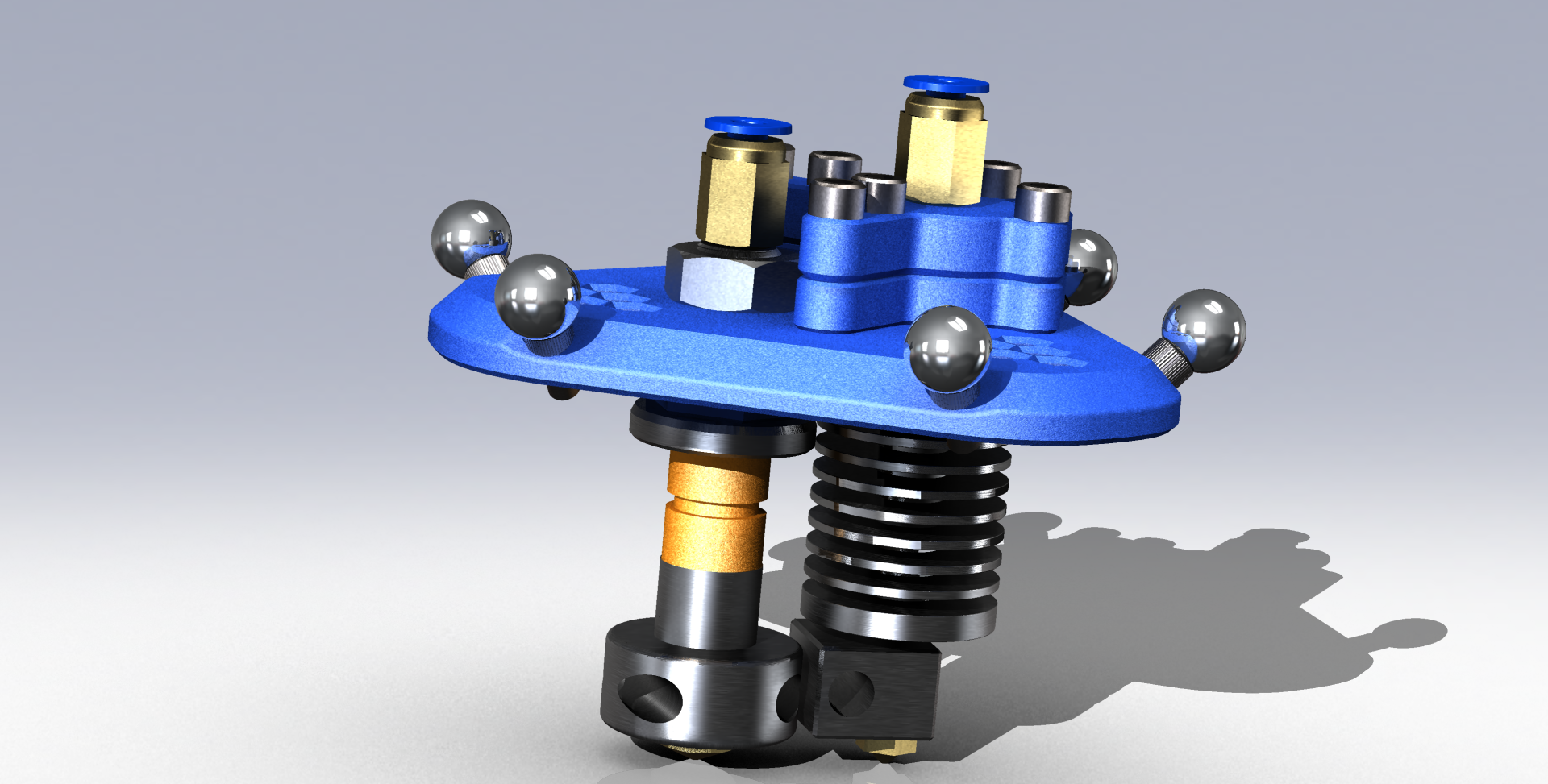

I printed a new effector platform for it. Mine uses a magnetic ball upgrade, but it shouldn't be that hard to make your own replacement part to adapt the E3D for the default rostock u-joint plate.

Ok ok, hold the phone here for a second!Generic Default wrote:I printed a new effector platform for it. Mine uses a magnetic ball upgrade, but it shouldn't be that hard to make your own replacement part to adapt the E3D for the default rostock u-joint plate.
What is that really cool looking split or dual feed situation thing you have going on there in the second and third photo down? Also I would love to have a copy of your stl's if you feel like sharing.
