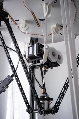

A direct extruder (with the extruder motor at the nozzle) makes the end effector heavy. Due to the limited torque of the axis-motors and the limited stability of the linear bearings and the frame the printing speed is limited.
A bowden extruder (with the extruder motor at the frame, feeding the nozzle trough a tube) does not have these issues. The end effector is very light an can move with high speeds and high acceleration. However the bowden principle introduces many problems. This is mainly friction in the tube and a hysteresis due to the elasticity of the tube and play of the filament in it.
To fight stringing retraction is used. But because of this hysteresis you need more retraction. You'll also need more retraction if you are trying to print faster, because the pressure in the nozzle is higher and this pressure has to be eliminated before moving the nozzle to another position (otherwise you get strings). More retraction takes time an you get small blobs during the time the nozzle stays at one position.
Long story short: The fastest I could print with a decent quality was around 25mm/s with 5mm retraction.
The Solution

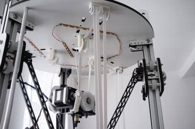

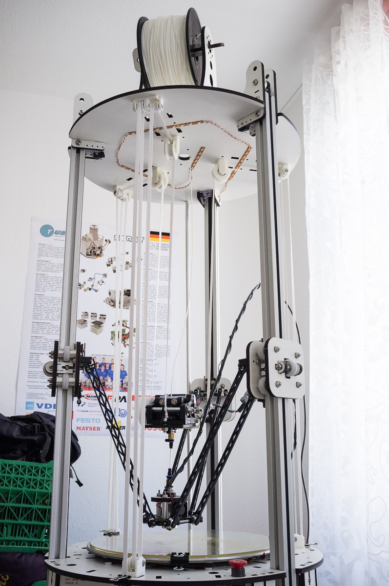

The Flying Extruder! The extruder is suspended by rubber bands. These are running around several rolls to increase the length (each around 2m relaxed) to have more or less the same force over the whole vertical range. The extruder is connected with a very short tube (around 75mm) to the nozzle. This tube decouples the high frequencies between the nozzle and the extruder.
Long story short: I'm printing with no problems with 75m/s and 3mm retraction and still with the same acceleration of 800mm/s². But this was only a short test and I think I can bring it up with a bit optimization.
Another advantage is, that it's now easier to build an enclosure and that the printer is much quieter, because the extruder is decoupled.

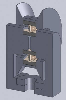

I added some shrinking tube (with internal glue) to the tube and used cable ties around the tube fittings (to keep the plastic part away from the metal part) to minimize the play and make the retraction more effective.

I tried to print the small rollers in the first place, but couldn't get them to spin as smooth as they have to, so I found some rollers with steel shafts and printed only the flanges. I used ball bearings inside the large rollers: I found the translation for the "rubber band": It's called "Braided Elastic". I also tried "Thera Band" (often used for slingshots) but it is too sticky and climbs the flanges.

Yes, I use 0.5mm Z-Lift, but the extruder does not notice that, because of the elasticity of the tube.
The bowden fittings can handle it so far. I printed for some hours and the tube was also looking ok.
No, shorter elastic bands would not work, as I described in my first post. The relative stretching would be huge and the force at a low position to high, vice versa.

Could be good, but could also be bad, because the eigenfrequency would be lower. For now I'll go with what I have.JohnStack wrote:Looking at this, I'm wondering what you might come up with if you used the Ezstruder - which is significantly lighter.
Figuring all this stuff out took a while (also it looks easy nowJohnStack wrote:You went quiet for a while....I was wondering!
Yes, but the extruder mass is moved with a much lower acceleration (A) then the nozzle itself is moving.ApacheXMD wrote:I wonder, though, since you're still essentially moving the extruder alongside the effector, arent you still moving much more additional mass? I realize the force of gravity is negated by the elastic bands but moving laterally youre still bound by F=MA where your mass (M) is still increased by the extruder.
Here you go: http://vimeo.com/68489641 .ApacheXMD wrote:Can you post a video?
Ask Kisslicer why it's producing such crazy moves
You can see the extruder not only moving, but also tilting, which requires also less force.
