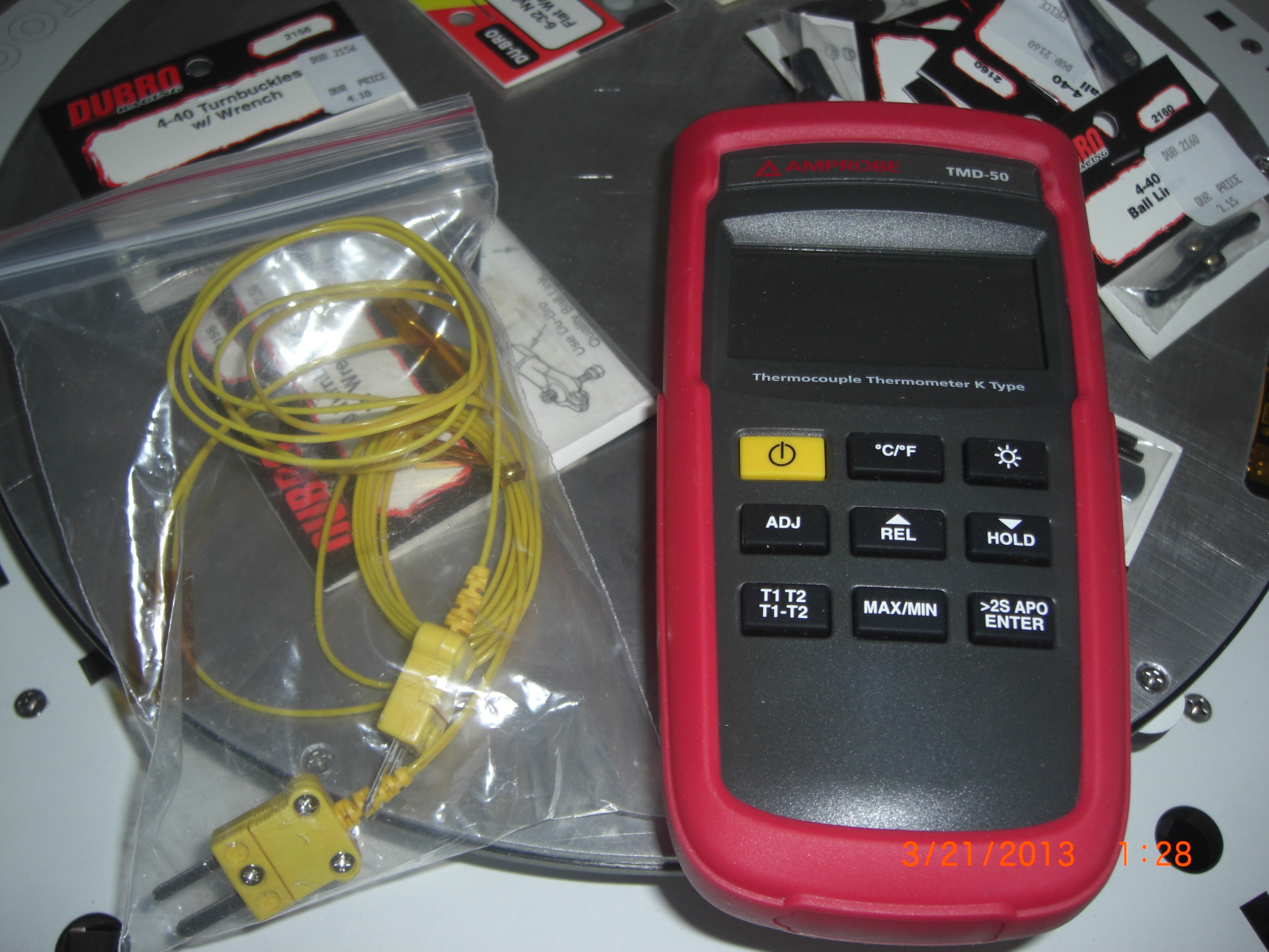

I planned to do this in order to see what temperature difference there was and adjust firmware/software as needed. use of the second hole in the hotend for a thermocouple could come in handy.Polygonhell wrote: The only accurate way to measure temperature is to put a thermocouple in the nozzle, almost no one does this when they calibrate, so almost no one knows how accurate the thermistor is or isn't.
There is a second hole in the Al heater block and I've checked that with a thermocouple, all it tells you is if the thermistor is calibrated against it's spec sheet, unfotunately it doesn't tell you what the temperature difference between the location of the thermistor and various other parts of the hotend are.cambo3d wrote:I planned to do this in order to see what temperature difference there was and adjust firmware/software as needed. use of the second hole in the hotend for a thermocouple could come in handy.Polygonhell wrote: The only accurate way to measure temperature is to put a thermocouple in the nozzle, almost no one does this when they calibrate, so almost no one knows how accurate the thermistor is or isn't.
I bought this one from amazon http://www.amprobe.com/amprobe/usen/HVA ... ?PID=73400 it has two thermocouple inputs. maybe use one for heatbed and one for the hotend, maybe permanently mount the thermocouple, if you wanted to.
