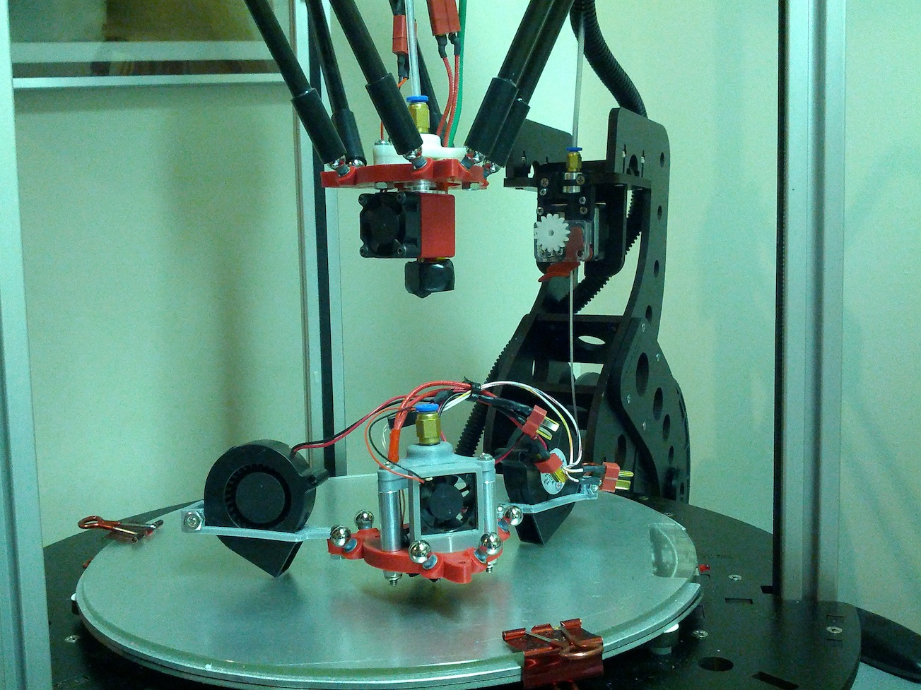

One of the things I like most about the magnetic arms is the speed with which you can disasemble the platform with the hotend. I printed up a second platform and have the E3d set up for ABS and nylon, and the other head (makergear style, from the guy that makes the screw-in thermistor) for PLA. With the Dean's plugs, I can swap them out in hardly more time than it takes to swap the filament, then just change the Z-max length and PID and I'm back in business. With micro Dean's, it would be even faster.
With 4 pin micro deans, I have one connector for the heating resistor and thermistor, and then one additional connector for the PEEK fan and two pins for future expansion (lights probably).
With some careful shimming, you might be able to keep the same Z axis length with both heads.Broose wrote:I can swap them out in hardly more time than it takes to swap the filament, then just change the Z-max length and PID and I'm back in business.
Very nice picture!Broose wrote:One of the things I like most about the magnetic arms is the speed with which you can disasemble the platform with the hotend. I printed up a second platform and have the E3d set up for ABS and nylon, and the other head (makergear style, from the guy that makes the screw-in thermistor) for PLA. With the Dean's plugs, I can swap them out in hardly more time than it takes to swap the filament, then just change the Z-max length and PID and I'm back in business. With micro Dean's, it would be even faster.
Are those the original Xnaron effectors, they look different somehow.
Those effectors look familiar to me... actually nicer than the one I printed.Are those the original Xnaron effectors, they look different somehow.
I have to agree my favorite thing about the magarms is how easy it is to take off them off.
Props to Barnett for the effectors and Xnaron for everything elseEaglezsoar wrote:Very nice picture!

I used Kisslicer and they are ABS. Of course, having the Xnaron mag arms helped with the print quality.Eaglezsoar wrote:Which slicer did you use to print the effectors? They look great! Are they ABS?
I noticed that the hotend you are using for the PLA has no slots in the Peek to aid in cooling, is that a problem for you?
I just went to his website and it does show there are no slots.
Is that a custom fan mount you have on the PLA head?
It seems to work fine for PLA with the fan. Yes, I made a little box to hold a 25mm fan next to the Peek.Eaglezsoar wrote:I noticed that the hotend you are using for the PLA has no slots in the Peek to aid in cooling, is that a problem for you?
