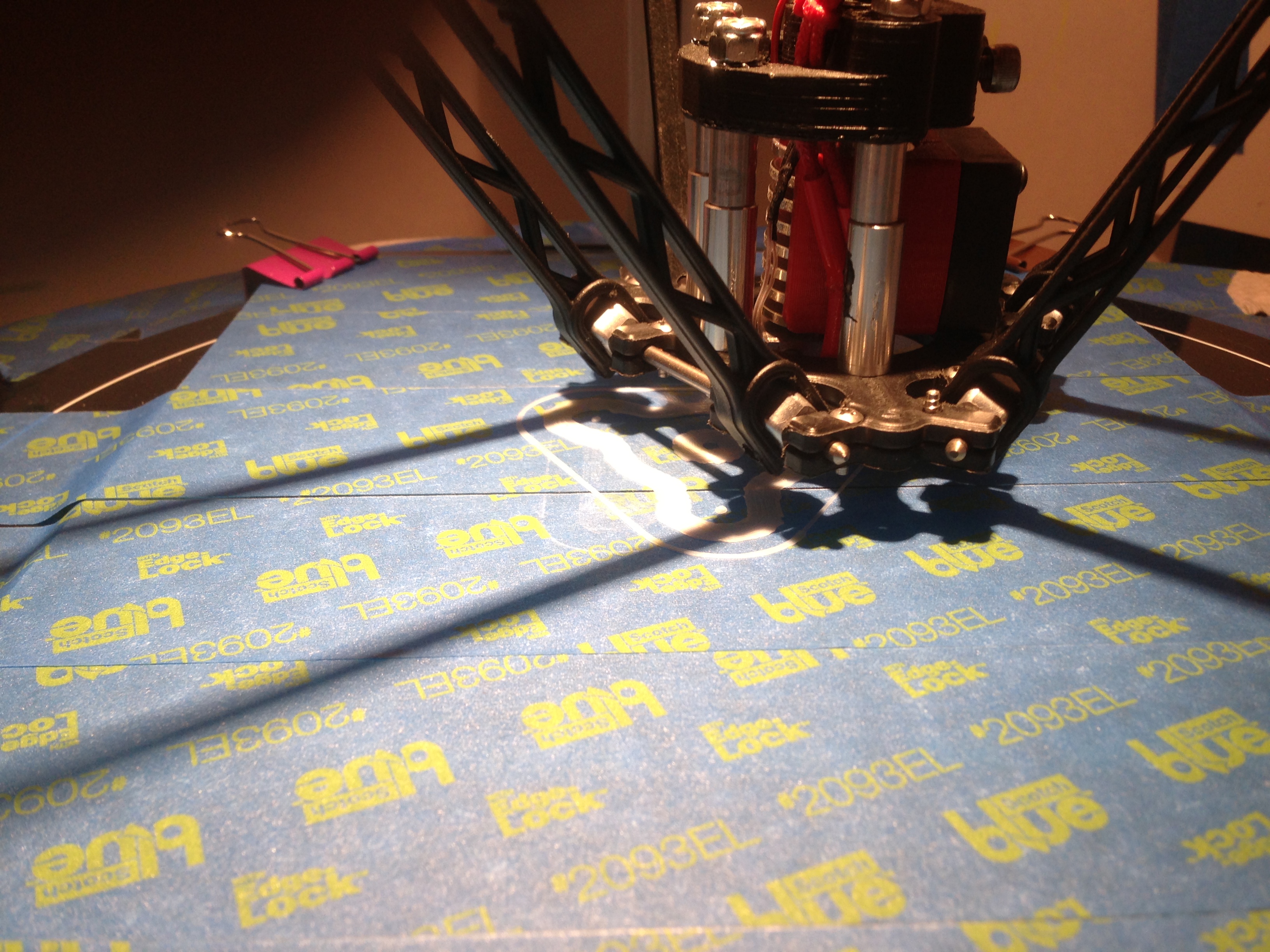

Hey Sanjay from E3D. Great product. Here is my Rostock Max set up with your E3D hot end and Xnaron's magnetic arm set up, zero lash operation. E3D hot end head taped with ceramic tape and kapton tape to keep some heat off my prints as I print mostly with ABS plus and High impact. So far this hot end is by far thee best I've had to work with.
