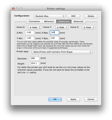

I just got my printer built and decided to switch to the Repetier Firmware before getting everything calibrated. My apologies if I have little to no idea what I'm doing...
I downloaded Polygonhell's fork of the firmware, changed the MICRO_STEP config to 16, then compiled and uploaded fine.
When I open Repetier Host and home the printer everything moves to the top as expected, but the manual control panel reports the current position as X: 280, Y: -280, Z: 0, which is very incorrect. My best guess is that what ever is controlling to homing logic doesn't realize it's a delta printer. I've confirmed that DRIVE_SYSTEM is set to 3 in Configuration.h, any help would be greatly appreciated.
Thanks in advance.

Type M114 and press return in the G-Code field. This will tell you where the firmware thinks the position is. You most likely do not have the printer setup in the Printer dialog correctly. RH uses what's here to display. Here is my config:
Also, you have to change the steps-per-mm for the extruder to reflect 16 microsteps too. It should be 584 mm/s and can be found further down in Configuration.h in the extruder section.

The readout in the host software is bogus, it's based on commanded moves not actual moves, and with relative moves (jogging) it accumulates error.
M114 or the LCD display are the only accurate ways to know head position (assuming you aren't missing steps).

mhackney- I'm an idiot and you're awesome. Thank you very much.
I'm now having a another issue: it seems the movement on my stepper motors are off, the printer is reporting its Z height as 90mm when the hot end is almost to the build plate. It might be something in the EEPROM, but the Repetier Host crashes whenever I try to edit the EEPROM configuration.

Can you make a screen shot and post it of the EEPROM window?
You can also disable the EEPROM in the firmware Configuration.h file. Then you set the values there.

Screen shots aren't really that useful, so I downloaded the source and fired up visual studios. The host is crashing to some invalid EEPROM values. Its seems arbitrary space and/or line breaks are getting inserted at random. After messing around with resetting the EEPROM values for a while (I could never get save and load correctly), I gave up and just disabled EEPROM.
For anyone having movement issues with newer machines, make sure you change PULLEY_TEETH to 20
