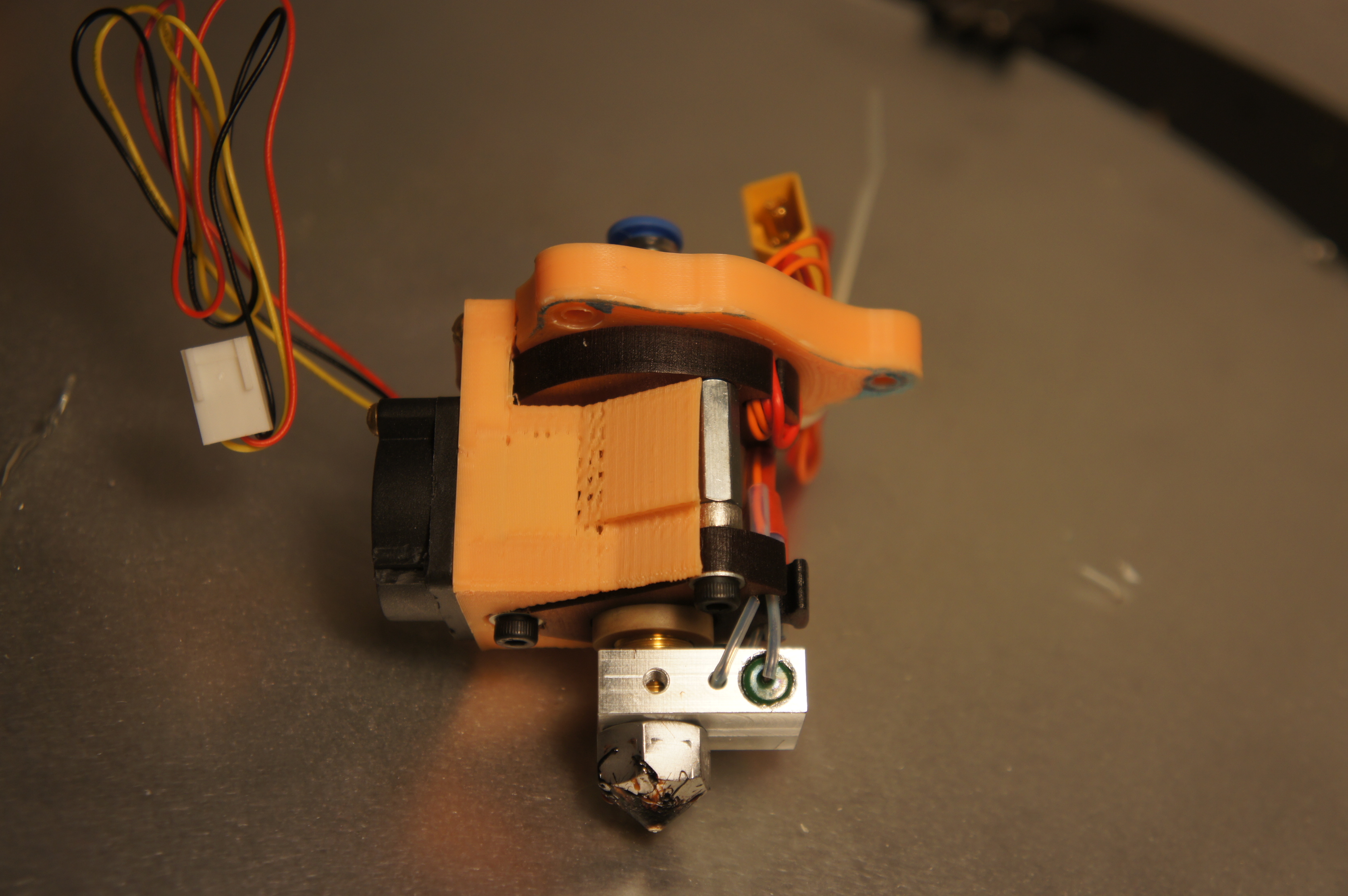

Here's a link to my Budaschnozzle mount for the Max. http://www.thingiverse.com/thing:71673
There is also a mount for a transition end fan shroud. I would say this is required if you want to print PLA.
I had to move the Budaschnozzle 5mm forward from the center so that the heating block was centered on the hotend platform. It was just barely clearing the hole in the platform with the nozzle centered, so I moved it.
I originally purchased this for my first printer which had a hotend that basically would not work with PLA, all I had at the time. I got tired of it and tired of trying different designs of my own, that didn't really work well. From the get go the Buda printed awesomely. I did have a few problems with PLA plugging, before I found out about using a fan. But with a fan, absolutely zero problems with plugging. Just one leak.
With that said, I have had zero luck successfully changing nozzles without destroying at least two parts. Once the hotend goes thru a few heat cycles, the aluminum on aluminum threading will gaul against each other basically destroying it. To possibly solve this problem, I've machined a brass threaded piece to replace the aluminum one. Haven't tried to change it since I've installed it, about 20 hours on it right now.
I tried the Budaschnozzle because takes less force to extrude plastic thru it than the stock nozzle. And I never could get decent retracts with the stock nozzle. And in my opinion the extuder seems way overenginered, and I do not like how you are basically relying on friction alone to keep the gears turning. I've put marks on the gears and bolts, ect. to see if there's any gears slipping. I've never seen any slipping, but I just don't like it. Too many possible failure points. Plus it's way louder than the Max. When I hit some layers with 10 or more retracts it makes me want to pull my hair out. Klack---Klack--Klack-Klack,Klack, :evil: ,Klack,Klack,Klack,Klack.....
So far since I've put it on the Max I've only printed ABS with it. I've never printed with ABS before I got my Max so no experience with it in my old machine. At printing speeds of 40~50mm/s the Buda will just barely keep a temp of 230~231, when set at 235 or higher. Setting it at 230 and it will float around 227~228. When printing at 50mm/s and just above I couldn't get the temp above 225, at about 65mm/s it was down to 215. And at 100mm/s it was 205. All of this was with the transition zone fan on. It may perform better with it off. But I didn't want to risk melting my mount, it has happened to me before with a PLA mount on my last machine.
I tried wrapping the heater block in kapton, but it only helped marginally. As these PID values show.

I got this all hooked up today. It seems to work pretty well. I have a Budaschnozzle 2, so the way it's depicted doesn't work, but the specified screws (#6-32) fit the three holes in the Budaschnozzle itself and project up past the mounting piece, so it works fine. I also had to remove some material from the curved hole in order to accommodate the 4-pin header hardwired to the Budaschnozzle. Haven't printed the fan shroud yet, but I think it'll probably fit OK.
I installed the nozzle with some PTFE pipe tape. Hopefully the aluminum won't gaul.
For wiring, they ship the hotend with four wires coming off it to a 4-pin female connector, and a matching male connector with 4 wires (maybe 3' long) coming off it which I braided. I used some nice thick speaker wire for the hotend and fan wires, which involved clipping two of the much thinner stock wires and leaving the other two for the thermistor.
I tried to do the PID autotune, but it kept overshooting by ten degrees and never backing off enough to get down to the right temp. I just used the PID settings in the first post and they work alright, although there is a bounce of a few degrees. Doesn't seem to matter too much. I'll try again later. Perhaps the new settings will help it zoom in on the right numbers next time.
The SeeMe hotend I'm replacing had a .5 nozzle and this thing has a .25 nozzle. After measuring the plastic at an average of 0.3, I changed a couple settings in KISSlicer and it was ready to go. Didn't have to mess with the retract settings or anything, and it works a lot better than the SeeMe hotend. There is noticeably less friction feeding filament through by hand, even with a narrower nozzle. After it does a retract, there is absolutely no "burping" whatsoever, whereas the stock hotend would usually not lay plastic for the first millimeter or so and then give me a little glob or something before it started extruding reliably. This thing consistently deposits material the moment the post-retract jump is done. Even with fairly aggressive settings (0.1mm layer height, 45mm/sec, lots of curved surfaces) it's printing with reasonably good quality. I'm looking forward to trying sub-0.1 layer heights.
My first print is the Budaschnozzle mounting plate, in case the existing one goes out. After that I'll do the fan shroud and see if it fits.
