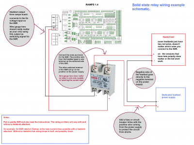

I got an additional power supply but I'm not sure I'm going to wire it correctly, does anyone have a wiring diagram?
Re: Onyx Temp Limit
grimmindustries wrote:I got an additional power supply but I'm not sure I'm going to wire it correctly, does anyone have a wiring diagram?
						Re: Onyx Temp Limit
having an additional power supply isn't going to do much unless its an 18- 24v supply. Just adding another 12v supply (assuming your adding another 12v supply) will net you nothing because its still 12volts. You need more voltage to get more current going through your onyx in order for it to heat up faster.
I run mine with a dedicated 24v power supply and ssr. heats up to over 100c around.. 5min. http://forum.seemecnc.com/viewtopic.php ... =24v#p7627
as far as the wiring goes here's is an example using an additional 24v power supply just for the heated bed.. (the 12volt stock power supply is still used but not for heated bed power) This shows a ramps board but the idea is the same......you use the output for your heated bed on the rambo board to control your solid state relay. The power for the ssr is strictly through your dedicated source to your heat bed.

Thanks, I did get a 24v power supply and when I wired it directly to the Onyx it heated up super quick but then it didn't stop heating up. Do I just add the power supply inline with the existing power supply?

I see what I did wrong. I connected the new power supply through output instead of input.
The new 24v power supply is great, it didn't even take 5 minutes for the Onyx bed to get to 100 degrees C.

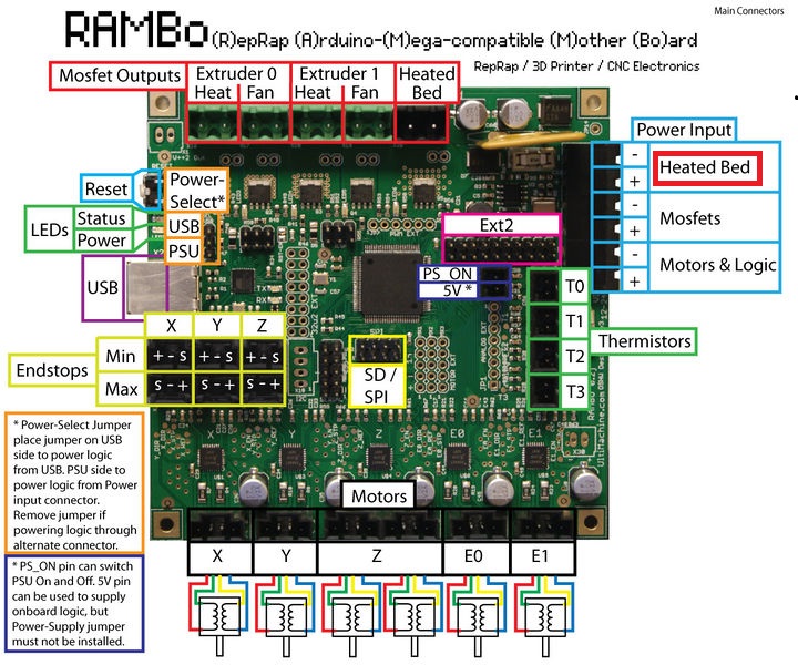

Can you provide some sort of model # or supply house you got that 24v power from?
Also, you brought that through the Rambo without the SS relay, right? That was my thinking to do as well. The Rambo is different that the picture from Eagle, as there is a 15a car fuse in the upper right corner. I had a suspicion that the fuse could handle the 24v supply. Really it's the current that would cause it to blow. And with 24vdc and a fixed resistance value from the plate, the total current would go DOWN.

gajtguy wrote:Can you provide some sort of model # or supply house you got that 24v power from?
Ohms law says that current = voltage / resistance.
If the voltage is 12V and the resistance of the bed is 2 ohms the total current is 6 amps.
If the voltage is 24V and the resistance of the bed is 2 ohms the total current is 12 amps. I don't know how you say the current would go down.
In actual practice, the current to the Onyx with 24V is approximately 17 amps, if you plan on using the Rambo only you would need to increase the fuse value to 20 amps.
I use the DC-DC SSR because I do not want to run that much current through the traces of the Onyx.

						Re: Onyx Temp Limit
Also, in-rush current to the Onyx can be higher than the 17 amp typical value (I think 19 was the reported peak at 24V, which is why some adjust the voltage down to ~19-20v on those supplies). Fuses (unless slow-blow which is NOT what the Rambo uses) care very little if it is just an in-rush or not.
