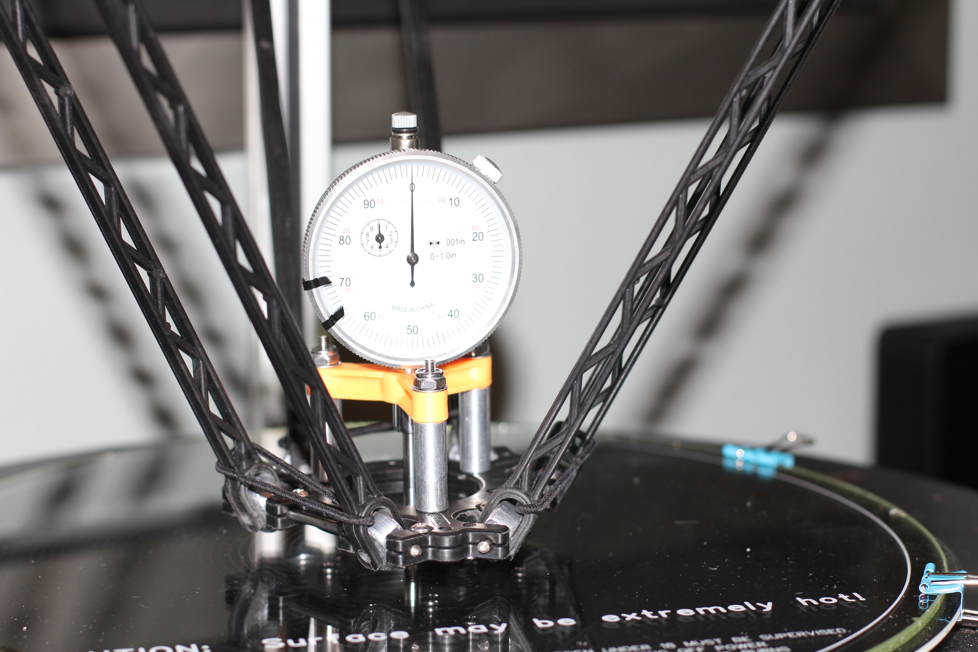

I have a cheap dial indicator. I got it at Horr'ble Fright last year for another project. http://www.harborfreight.com/1-inch-tra ... r-623.html
I designed this nifty little mount for it. I designed and printed it back in June, but didn't get a photo of it on the printer until tonight.
OpenSCAD FTW
OpenSCAD FTW
Here's the real thing.
Not a render.
Not a render.
I made the central hole a little undersized. The three slots around it let the hole stretch to make a nice friction fit around the indicator's shaft. I'm starting to figure out how to design for ABS.
You can also see the hair scrunchies that tension the delta arms. There are three more up by the CheapSkates.
Here is the OpenSCAD source file.
Dial Indicator Mount.scad
Dial Indicator Mount - OpenSCAD
(1.65 KiB) Downloaded 1022 times
My printer is back together now. I aligned the towers using the alignment jigs, I've changed the printer dimensions in the firmware, and yes, I've used this dial indicator to see how well it's aligned. I haven't had a chance to print anything yet.
More on that later; right now I just want to tell you that using a dial indicator to adjust the limit switches is about 20 times faster than sliding a piece of paper under the nozzle.

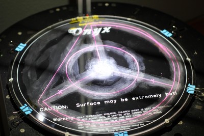

Then I printed a calibration cube. I'd switched to a new color of filament (Neon Purple from Toner), and needed to calibrate the extrusion rate. The second calibration cube is the one that measured 20.00 mm (+/- 0.02 mm) across. The walls are a tad thin on that one: 0.53-0.54 instead of 0.55. (photo)
Next, I printed the Rostock Onyx Bed Leveling Aid. It took a few tries to get a good glue layer on the board, but I eventually got a good print of it. The glass plate seems to be a little low halfway between the Y and Z posts (at 2 o'clock: you can see where the skirt came unstuck). I don't know how a glass plate can sag, nor how to compensate for it. Maybe it means I haven't finished calibrating. Or maybe the bed is cooler on that side. I don't know.
Can you ever really have too much glue stick?
Then I printed another calibration cube -- er, brick. This one was 20 by 150 mm. After the bed cooled, it measured just slightly oversize, 0.3%. (After I peeled it off the bed, it was too flimsy to measure.)

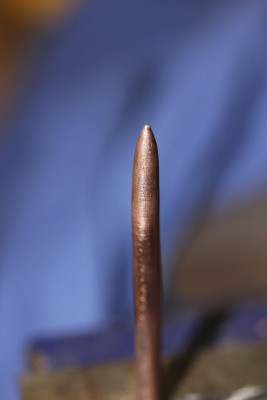

I'll cut to the root cause. I had soldered the hot end thermistor leads to stranded wires and wrapped everything up in heat shrink tubing. But one strand of wire was peeking out from under the heat shrink. When the wires were bent just so, that strand would contact the crimp connector on the resistor, which was uninsulated and short the thermistor to +12V.
Thank you, John Stack, for pointing me in that direction.
The wires did not normally touch. In fact, I used the hot end for six weeks before they did. After the damage was done, all circuits measured fine because the wires were no longer touching.
I can confirm that the USB circuit on the RAMBo is definitely dead. The board does not identify itself as a USB device. The LCD panel and pushbuttons are alive, and I can control the motors and limit switches from the front panel. I don't know whether the thermistor A/D works. There are no visible signs of damage (e.g., burn marks).
It's possible, though I think it's a long shot, that the ATmega 32U2 which handles USB could be reflashed and revived. I haven't tried that, since I replaced the whole RAMBo board. It would be nice to have a spare RAMBo (or to have one to make another printer), but that's not a priority yet.
It might be fun to repair the board while teaching myself to solder SMT, since the upside is big (new RAMBo) and the downside is small (dead board remains dead).
SeeMeCNC had new RAMBos in stock. The new one came with the RostockMAX firmware preloaded and a working bootloader.
I managed to destroy my thermistor shortly after the new RAMBo arrived. Fortunately, a friend here in Eugene had soem spare thermistors in his parts bin. It is not the original part, but it is 100K and its Beta is close enough that I did not have to change the firmware.
I also took the time to get some diamond thermal paste (Antec Nano Diamond Formula 6 from a local Staples store). Now the thermistor is embedded in thermal paste, and the hole is sealed with RTV. I also had some extra PTFE sleeving, though it's bigger than the original.
So the thermistor is installed a little better than before, and the hot end works. I have not yet calibrated the new thermistor against a thermocouple.

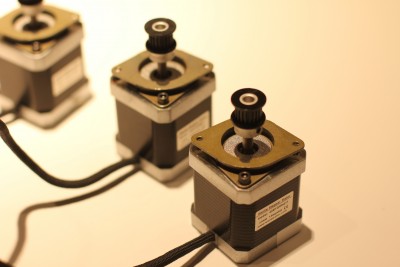

The day before my replacement RAMBo board came in, the motor dampers from astroboy907's group buy came in.
So I installed them. They work great. I'm not sure how much quieter they really are, since the printer was down for three weeks, but they _seem_ quieter.

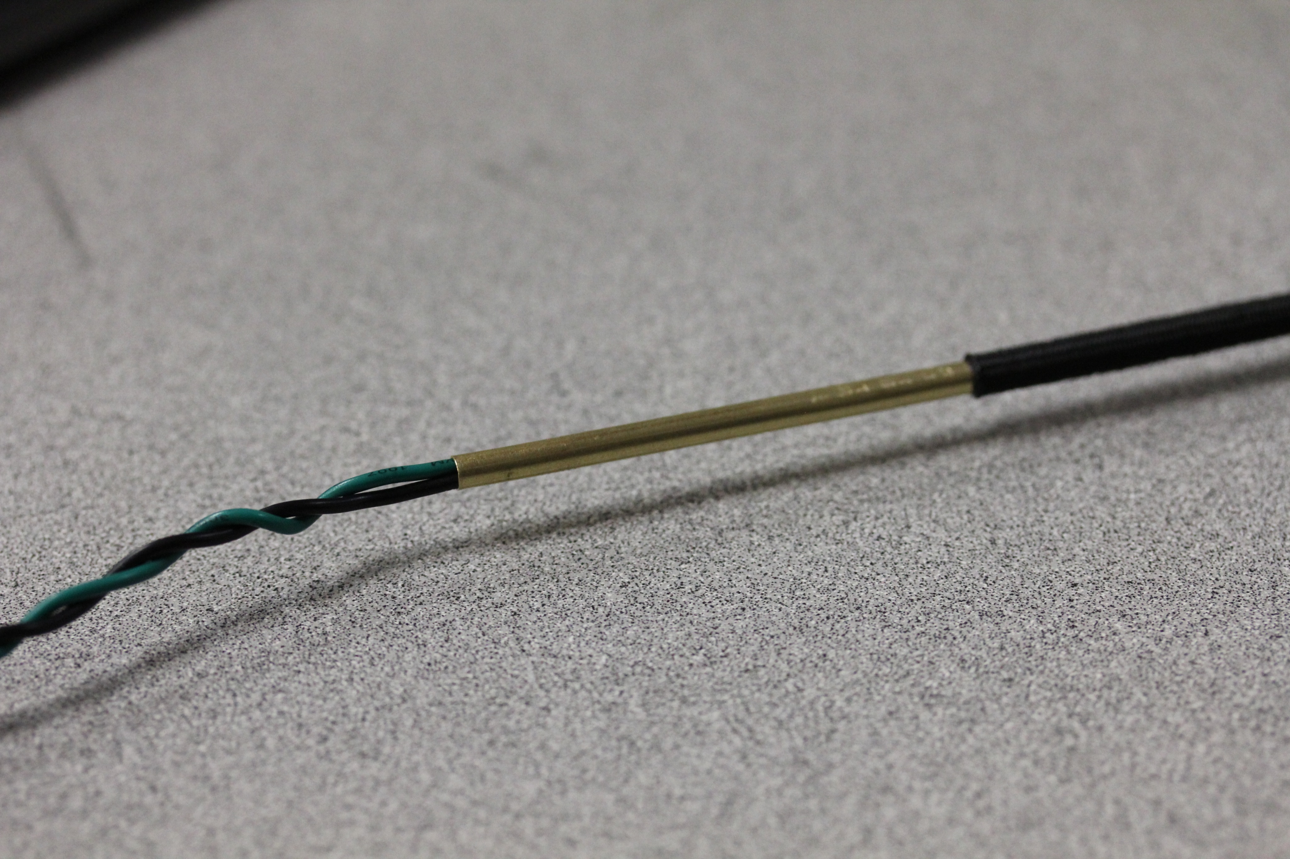

While I had the motors out, I decided to dress the wires. I used the old paracord sheath trick. That, along with some heat shrink tubing and label tape, made decent looking motor wires. In my ever-so-humble opinion. (-:
1 use for a dead RAMBo.
I need to do something with the limit switch wires, too. And then, if I'm going to high-mount my extruder, I'll want to redo the wiring to the extruder and hot end too. In other words, I want to redo all the wiring. (-:

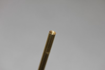

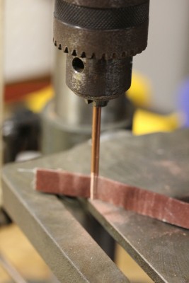

I learned the paracord trick from Bart Dring, who runs buildlog.net. But I can't find a description, nor even any pictures, on that site now.
Parachute cord has a nylon sheath around a bundle of longitudinal fibers (also nylon, I think). You don't need the mil-spec stuff; wire dressing is not life critical. It comes in lots of colors, so you can color code your wiring, but I just used black. Many sporting goods stores sell it. I got mine on Amazon.
Cut a piece of cord about an inch longer than you need. Pull out the inner fibers and discard. Slide the sheath onto a metal tube. (This is the hard part; see below.) Using a soldering iron you don't like very much, melt-cut a ring around each end of the cord. This leaves a fused nylon end that is round, not flattened. Pull off the frayed ends and discard.
I hate you, solder tip!  I coat you with gummy nylon!
Next, stuff the ends of the wires into the tube and slide the sheath off the tube and onto the wires. Slide on a piece of heat shrink tubing.
Note: these wires are too big for paracord.
Attach the connectors to the ends of the wires. Slide the sheath into place, then the heat shrink. Heat it and shrink the shrinkable, being careful not to melt the nylon. El voila!
How do you get the sheath onto a metal tube? I'll tell you how I do it, but I'm sure there's a better way waiting to be discovered.
I got a length of 5/32" OD brass tubing from the hobby shop. First I burnished and rounded the end so that it would slide in a little easier. That sort of worked, but wasn't great -- the tube edges would still catch the nylon fibers and snag.
So I made a needle end. I got some 6awg wire at Lowe's. They sell it, uninsulated, by the foot, and I only needed 6 inches or so. 6awg is just slightly bigger than the 5/32" tubing. This is the wire that grounds your house's fuse box (if your house is wired to US electrical code).
I put the wire in a drill press and used a piece of sandpaper to make a blunt point on one end. On the other end, I turned it down (still using sandpaper on a drill press), then gave it threads using a handheld die.
The pointy bit.
The pointy bit.
Is this the vertical mill?  Why is the cutting tool made of paper?
If they think you're technical, go crude.
I tapped matching threads on the inside of the tube. Now I can screw the two pieces together and use the needle point to thread the paracord sheath onto the tube, then unscrew the needle, insert wires, and slide the sheath off. The threads inside the tube grab the wire insulation and hold it in place.
Someone with actual metalworking skill or even with actual metalworking tools could make a much better version of this tool.

I enjoyed reading that but I have a question about doing it that way or using ordinary wire sheathing.
Is there an advantage to your method?
I know my reaction to an iphone on my shoe would be, *STOMP* followed by, "Eewwww! Scrape it off!" :D
Nice trick kbob. You know they actually make that sleeve material FOR doing wiring harnesses right? I'll have to see if I can find it online.
I like the diy-ness of your method though. Works great if you can't find the "real" wire sleeve material. :)
lordbinky
Posts: 744
Post by lordbinky »
Yeah you can buy braided wire sleeving, but for the impatient DIYer I can think of four brick & motor stores I know off off-hand that carry paracord which is still similarly priced as the cable sleeving, and I live in a tiny town in the middle of nowhere so alternatives to waiting for mail delivery are great.
