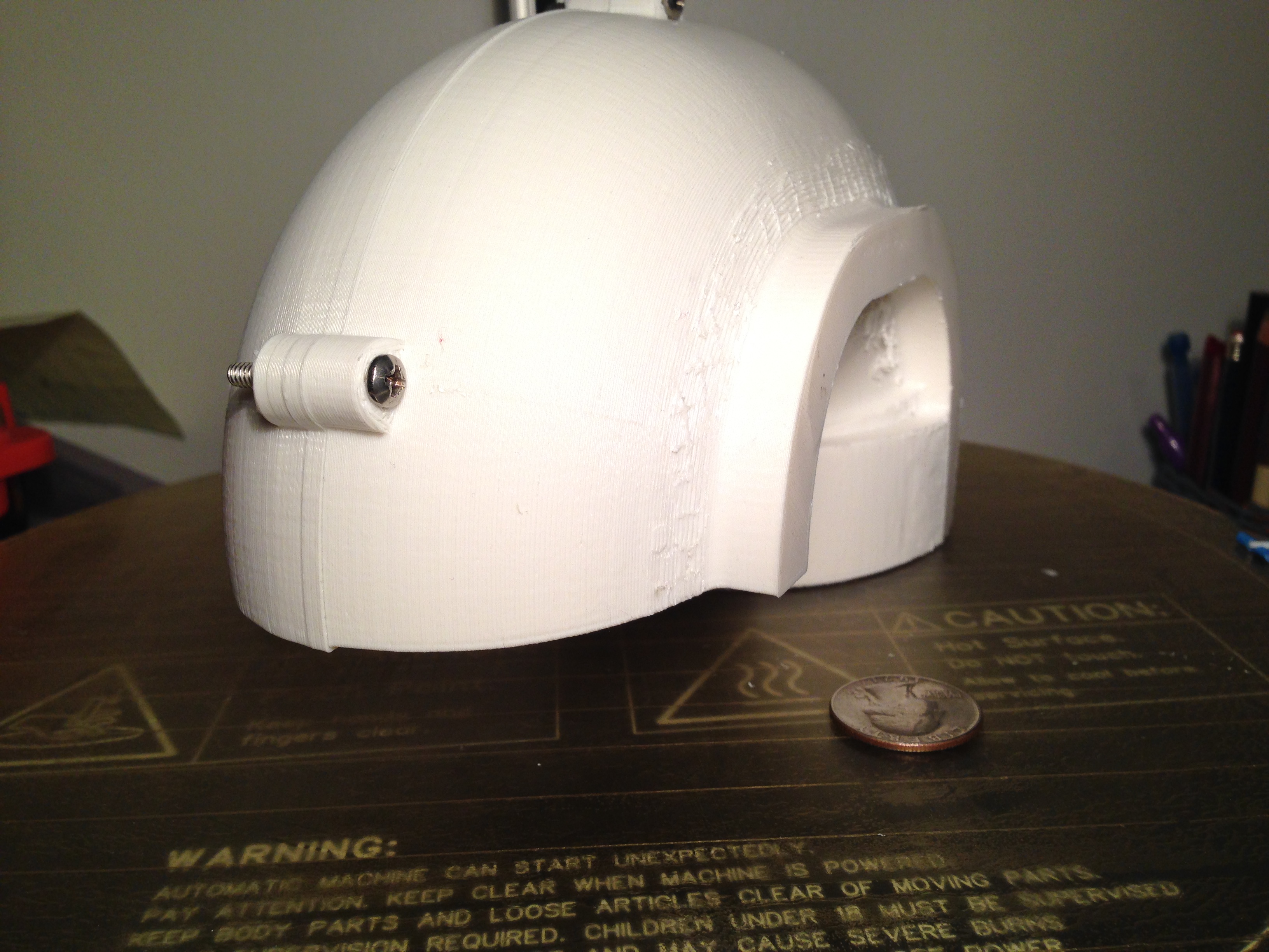

I got my FSR sensors yesterday, but I've been printing things for my robotics team non stop this past week. Wont have time to tinker with them until next week at the earliest.
The TL arms are a really great improvement. Ive bumped up the speed a bit (I could do more, but its okay at this speed) and the quality is still better than the old arms. I'm beginning to think the TL arms are pretty much a necessary upgrade with the Kraken, unless you don't mind printing real slow with 1000 accel.
I printed a tube for our robot thats 3 inches in diameter and couples with a 3 inch PVC pipe (3.5 OD). It turned out BEAUTIFULLY at .25 layers. It really did turn out very well. Layer alignment was great, everything was great.
One half
One half
Layer Alignment aw ye
Assembled both halves
Took around 9 hours per half.
I've been having issues with circles being more ovals than circles. All sizes of circles (I printed an adapter plate to couple a wheel hub with an axle mount, so 10 4mm holes, 1 9mm hole, and the part was a circle, none of the holes were perfectly round, and the circle was slightly off (closer to the edge of the wheel in some points)) I vaguely remember something about what to do about this, but I don't remember where or what. Something with delta correction gone wrong?

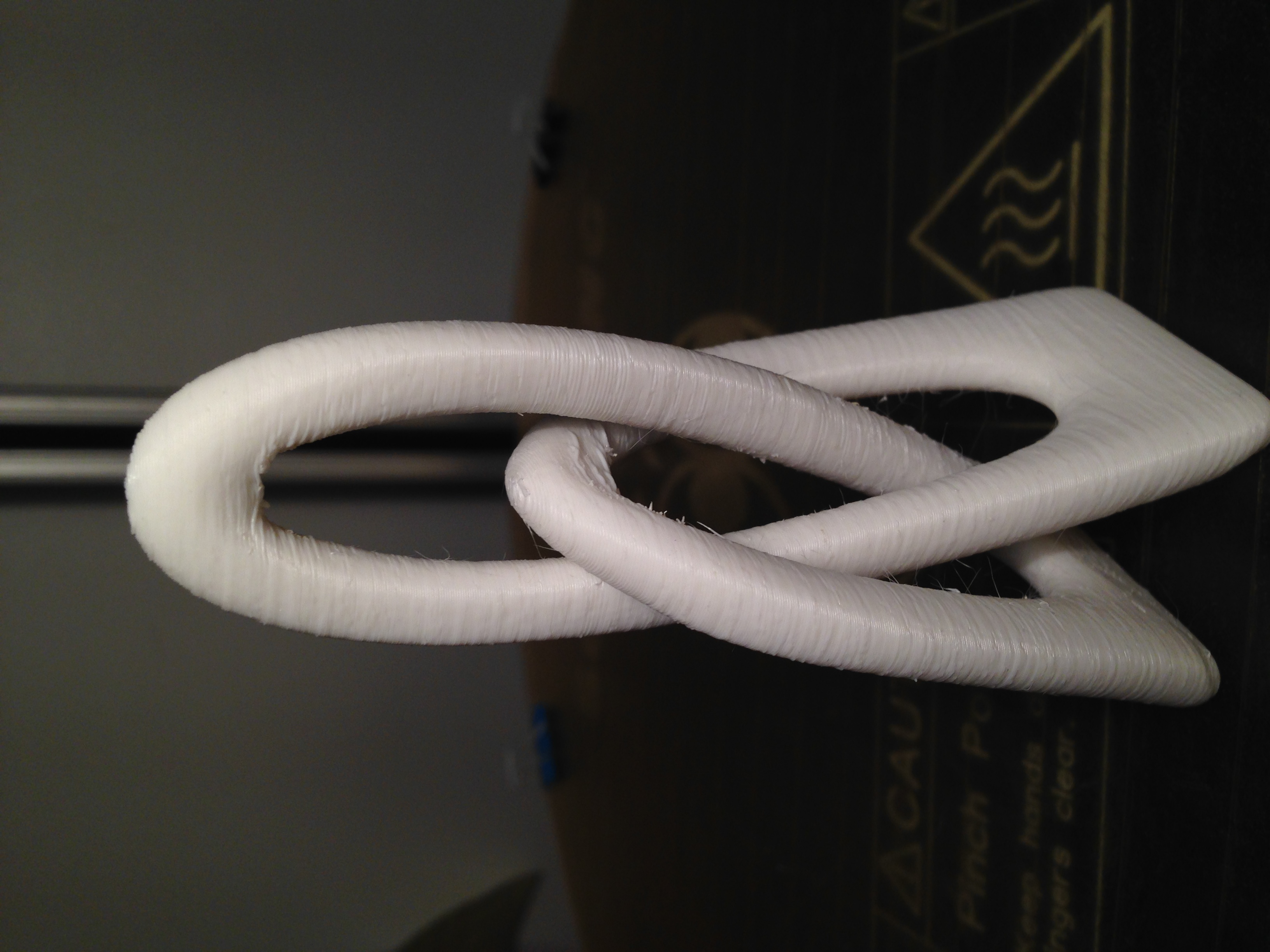

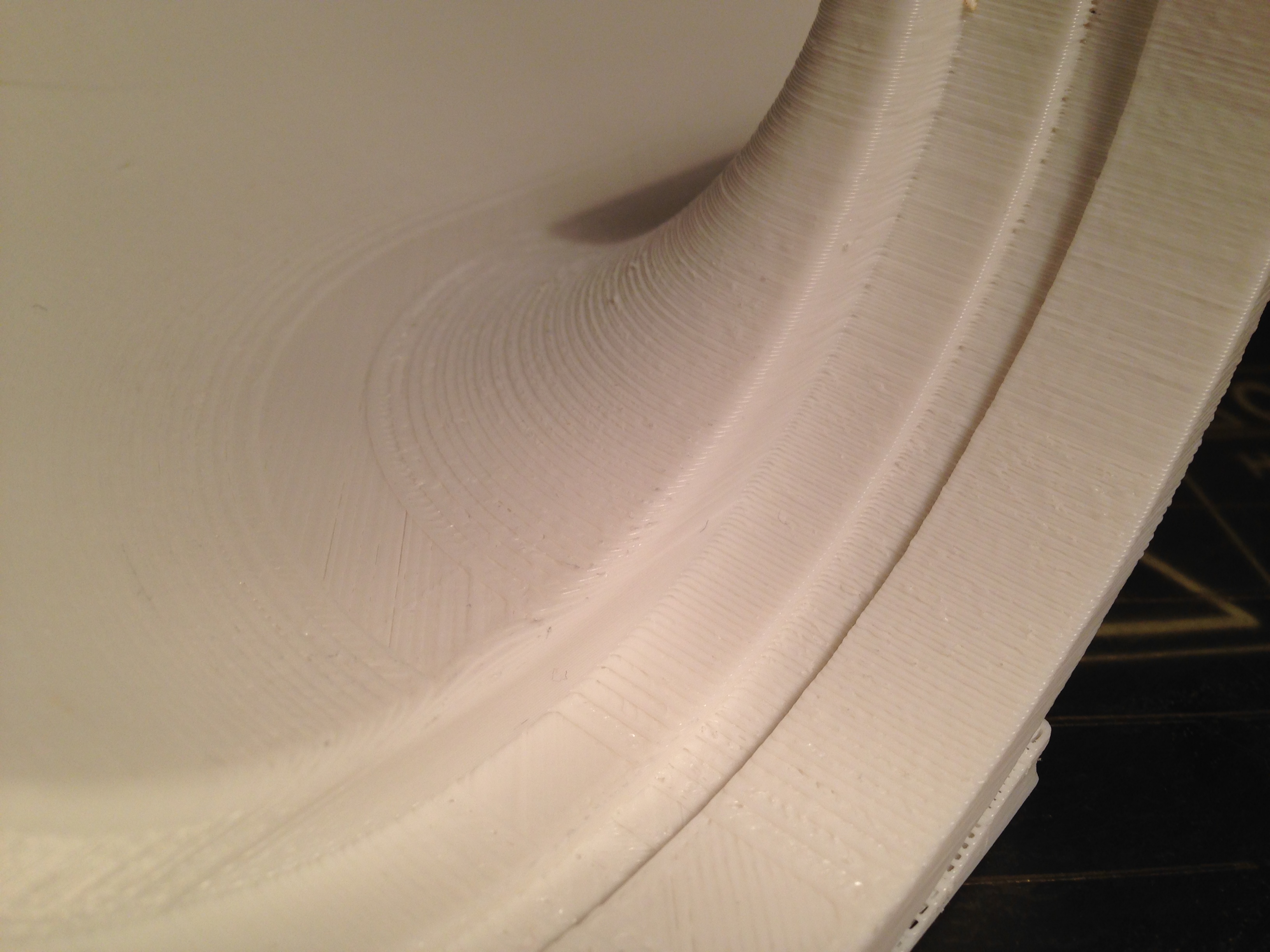

I've been trying to develop a profile with Simplify3D that works just as well as Cura, but I haven't been able to figure it out. I might be under-extruding a tad, but not everything is matching up. In Cura, with 100% flow rate I have to set my filament diameter to around 1.83mm, and it still over extrudes a bit (I am fine with it, because I don't have time to get the steps per mm correct, and I'd rather have it over extruding a bit vs under extruding (you can take off material, but you can't put it back on)). I'm not sure what to attribute these to, and I don't want to bump up the flow rate based on whats going on with Cura (would the flow rates on 2 slicing softwares really differ 10-15%?)
Ive also been getting stringing. I have retraction set to 4 (Cura retraction is at 3) so I'm not sure why?
Weird ridges and strings
Tops not quite solid
In addition, I haven't been able to get any good overhangs with S3D. They all curl up, rather drastically too. I've lowered the print temp to 235 and I can't print the low poly charmander without the belly and the bridging material from the legs to the body curling up a ton. It seems to be keeping a lot more heat for some reason. Speed, temperature (I lowered the hotend temp 5-15 degrees), and cooling settings are similar to Cura, and yet Cura has no cooling or warping issues. In fact, my bridging has seemingly gotten better (with Cura) with the CF arm upgrade (quite an interesting change for something that seems completely unrelated, but I'll take it). I really can't figure it out. There isn't a lot of consistency.
All these prints are in ABS. Normal Cura ABS temps for me are 240-250 at .2mm layers. S3D and Cura settings are nearly identical, albeit a few changes (Cura filament width is 1.81-1.83, S3D is 1.75, Cura min layer time is 10 seconds, S3D is 15 (slightly better bridging/overhangs))
And to make things even more inconsistent, I used the exact same settings on another Rostock MAX (With the hotend set to 250C) and it printed without a hitch. Better than Cura with that machine (it even over extruded a tiny bit, which isn't normal for that machine (with Cura it seems to under extrude if anything, same exact Cura settings and S3D settings as my machine, even the flow rate and filament diameter).
I have a real need to use S3D, the support generation is superb, and I have experienced that (I printed a set of 4 Dice with a 2 (actual number) on the bottom (that was the print on the other machine) and there was a tiny bit of support. I took a small flat head screwdriver and it popped right out with no marring of the printed surface, while if I had gotten support to print for the 2 in Cura, there would be lines left). I have an order for an object with an internal structure that I need support to print, and the only way to get the support out is through a small hole at the top of the object. I know from experience Cura won't be able to make this possible, so I need to have a working S3D profile.
Its a lot of information to digest, but I would really appreciate some help, a lot of these issues are beyond me.

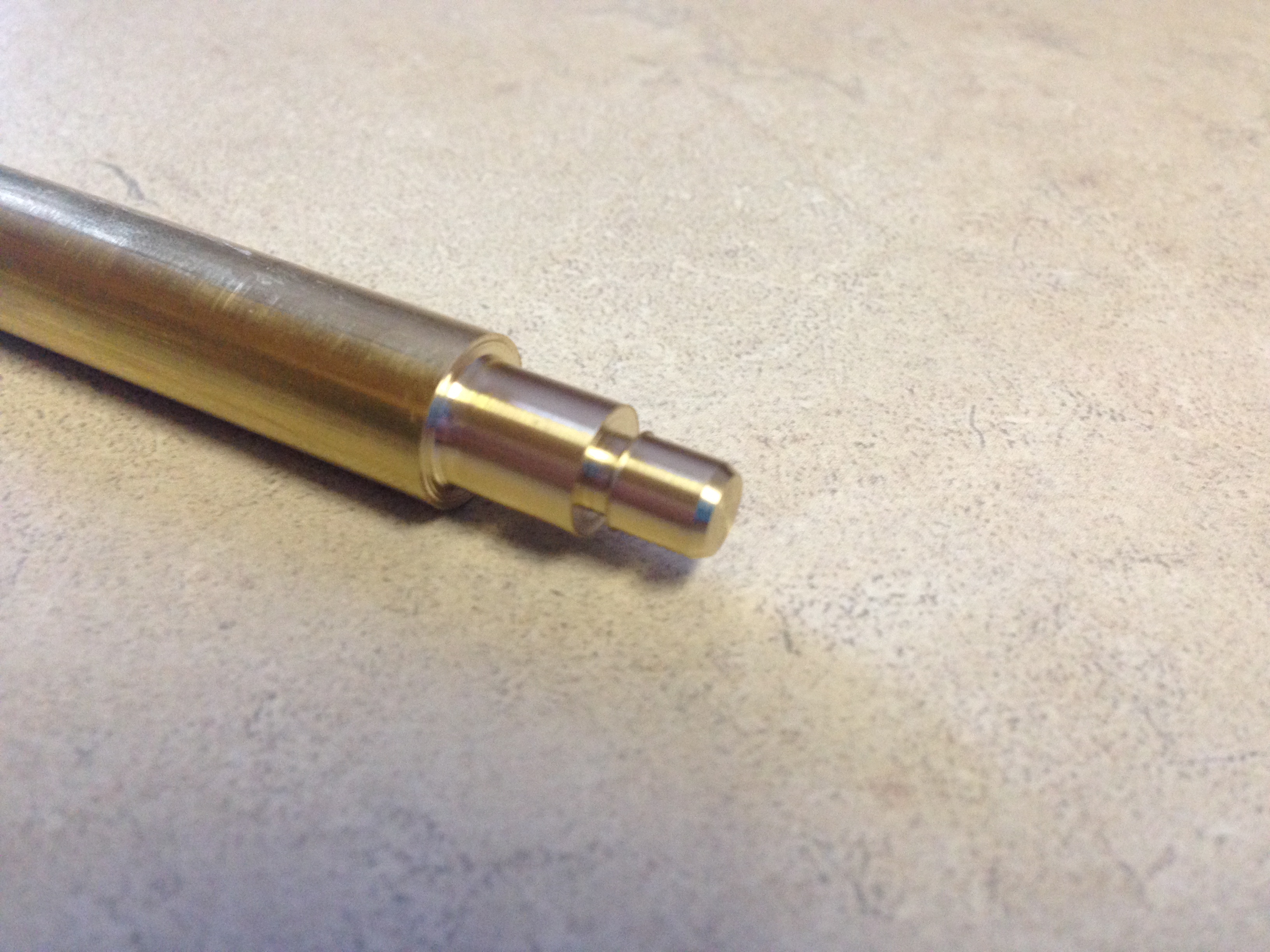

I've started turning my take on a nozzle design for my Kraken. I'm close to being done, all I need to do is drill a 2mm hole, ream it, chamfer the hole with a counter sink, cut M6X1mm threads, cut the nozzle off the rest of the material, cut the angle, and drill a hole for the material to come out. The college I'm taking the lathe class at is woefully under equipped with metric gear, they don't even have metric micrometers.

I don't know the options for Simplify3D, but I found a z hop setting over 0.1mm causes stringing.

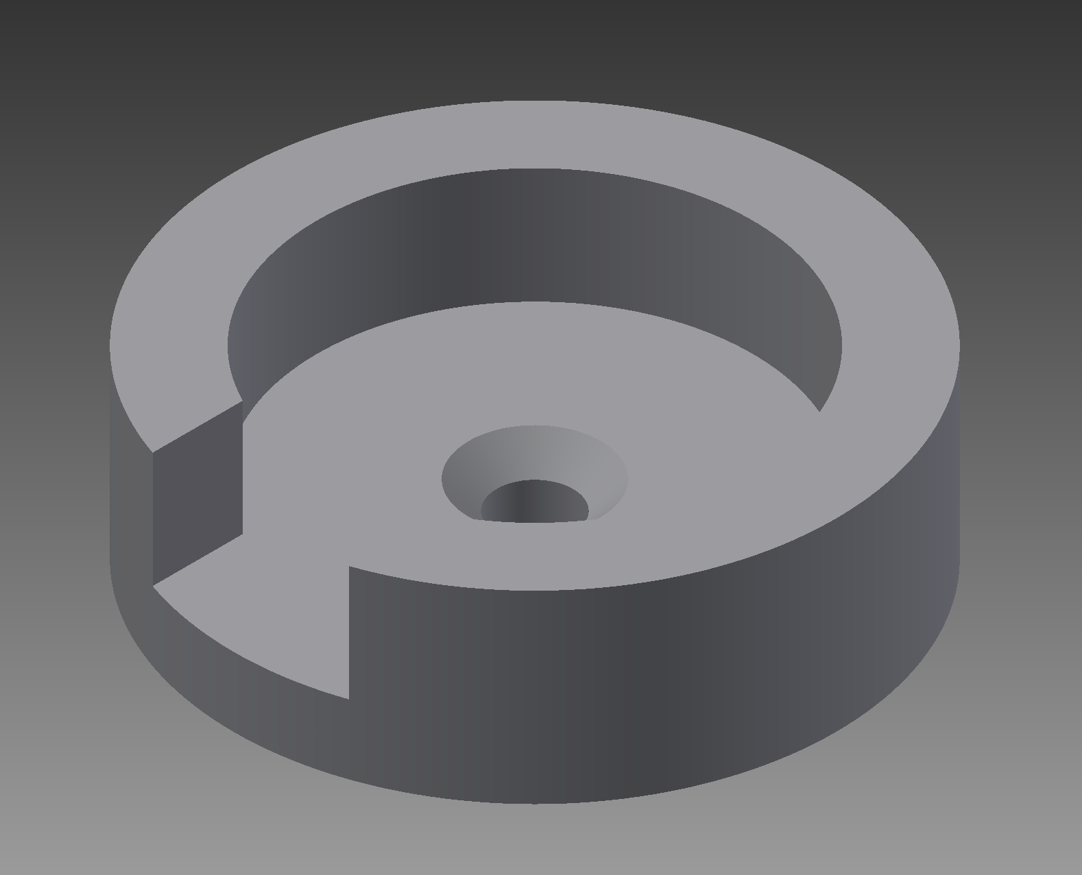

About my FSR mounts, I haven't had a chance to update the drawing. The change is to the puck part, once the O.D. and center hole are machined, I offset the 4-jaw by 0.5mm to make one side smaller. This allows for thermal expansion/contraction, something I noticed now that the garage is getting much colder.

I have 1mm z hop in Cura and I get no strings (except with Nylon but that's what Nylon does when it's dry). I'll continue to try to get it working.

Lowering the z hop had a great effect on stringing for me when printing PLA. For ABS I never had a problem with stringing.

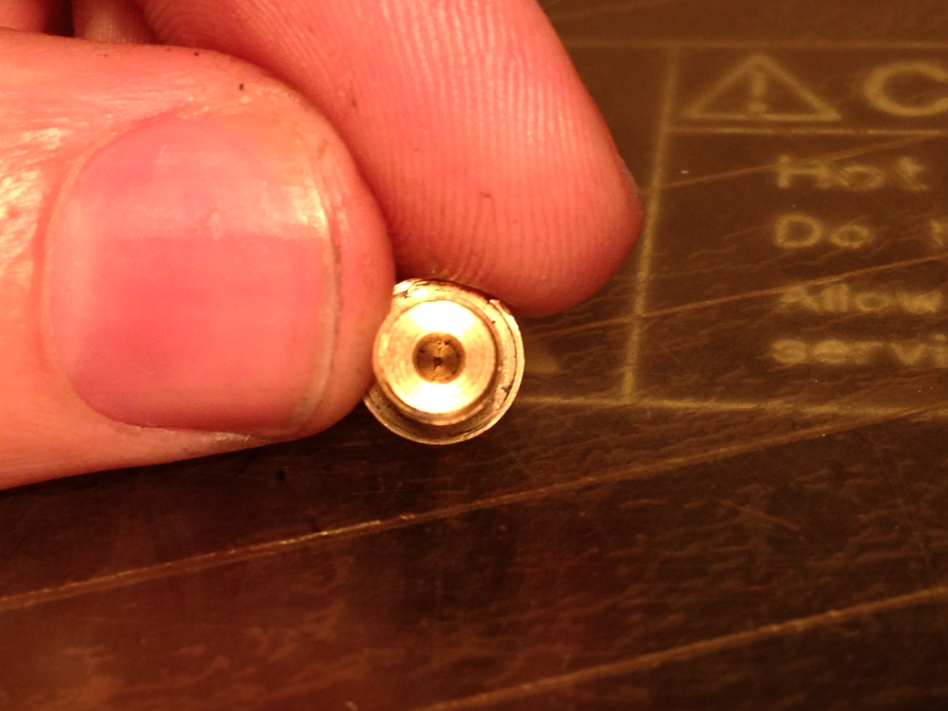

I'm a few steps closer to having my own custom nozzle. Ive drilled all the holes and threaded the M6 thread.
We don't have any 2mm reamers, so I drilled a 1.5mm hole, and then chased it with a 2mm drill bit, hoping that would leave the nozzle smooth enough.
The orfice I drilled with a .0145" bit (about .36mm). Once I machine the angled part I'll (try to) get some pics of the orfice size.

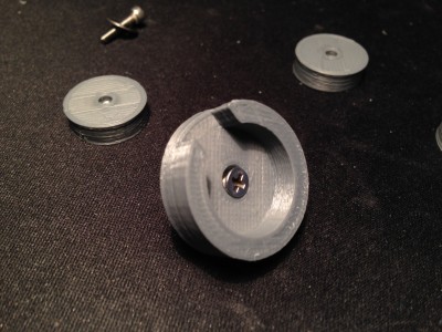

I've started work on a printed version of Rpress's FSR mounts. I'm going to print off V1 tonight and see the fit, etc. I hope to have them done (and maybe the "autolevel" system implemented in repetier). I'll try to make a manual of sorts for setting up an FSR leveling system. Eventually I'll adapt the mounts to be inside the base (for heated build chambers, since this was a concern of Generic Default and others).
FSR mount
FSR mount
Nylocke
Posts: 1418
Location: Iowa
Re: Mike's Birch V2
Post by Nylocke »
I got both halves done. I'll see how things go. I wont be able to print them for another couple hours though
FSR Mounts top and bottom parts

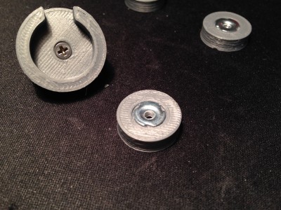

I designed mine for the tee nuts used for the wood parts. I have a ton of them (bulk order from McMaster) and I didn't want to be threading directly into the plastic. They work pretty well. The lower part has a chamfer to fit the countersunk screw without interfering with the FSR. All mine seem to be pretty good, so when I get a chance I'll mount them and test them out.

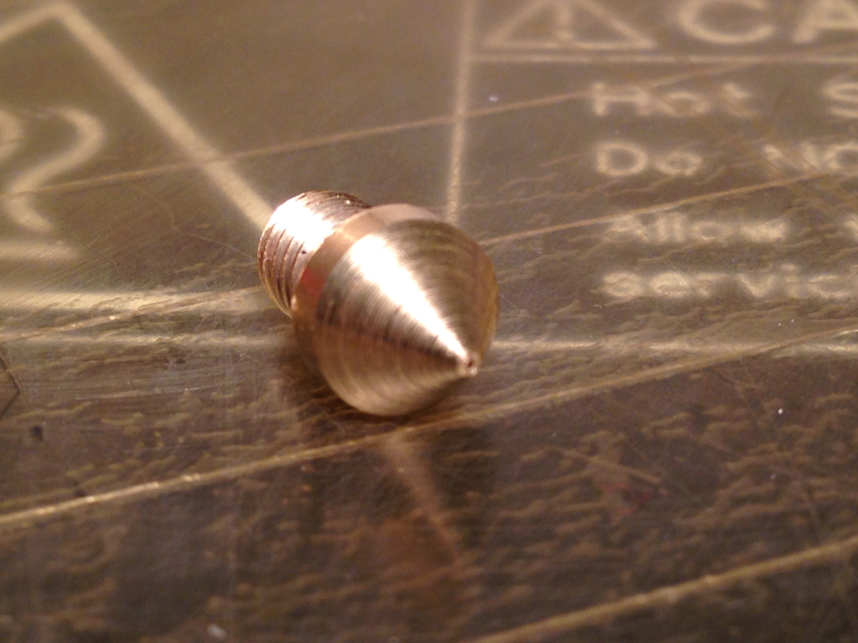

.36mm orfice
.36mm orfice
(The surface finish isn't the best because my tool bit wasn't very sharp, and this one is lacking the wrench flats that I plan to have eventually. The instructor wants me to do all the flats at the same time at a later date)
Side profile (didn't realize how steep it'd be until now)
Down the barrel
Down the barrel
I don't know how well it will work with PLA (the angle of the bit I used to drill it out was a standard 118 degree 2mm bit, so its a pretty sharp transition from 1.75 to .36), or how well it will work in general. I'm hoping I'll get some pretty nice surface finishes out of it, I've said before a little bit about my theories on nozzle design performance and quality (sharper the point the better the finish, but if its taken to extremes (the Merlin hotend) it can impact performance). This is assuming the internal angle (transition angle? I don't know proper terminology) is pretty close (if not) the same as the outer angle. More simply put, the sharper the point of the outside, the better the surface finish, and the sharper the angle on the inside, generally the better performance. This is all by observation of the different hotends I've used, and the different prints I've gotten from them and from what I've seen of other's prints.
Back to my nozzle and my machining class, I found an appropriate test print to bring in tomorrow. I'll post some pictures wether or not it turns out...
