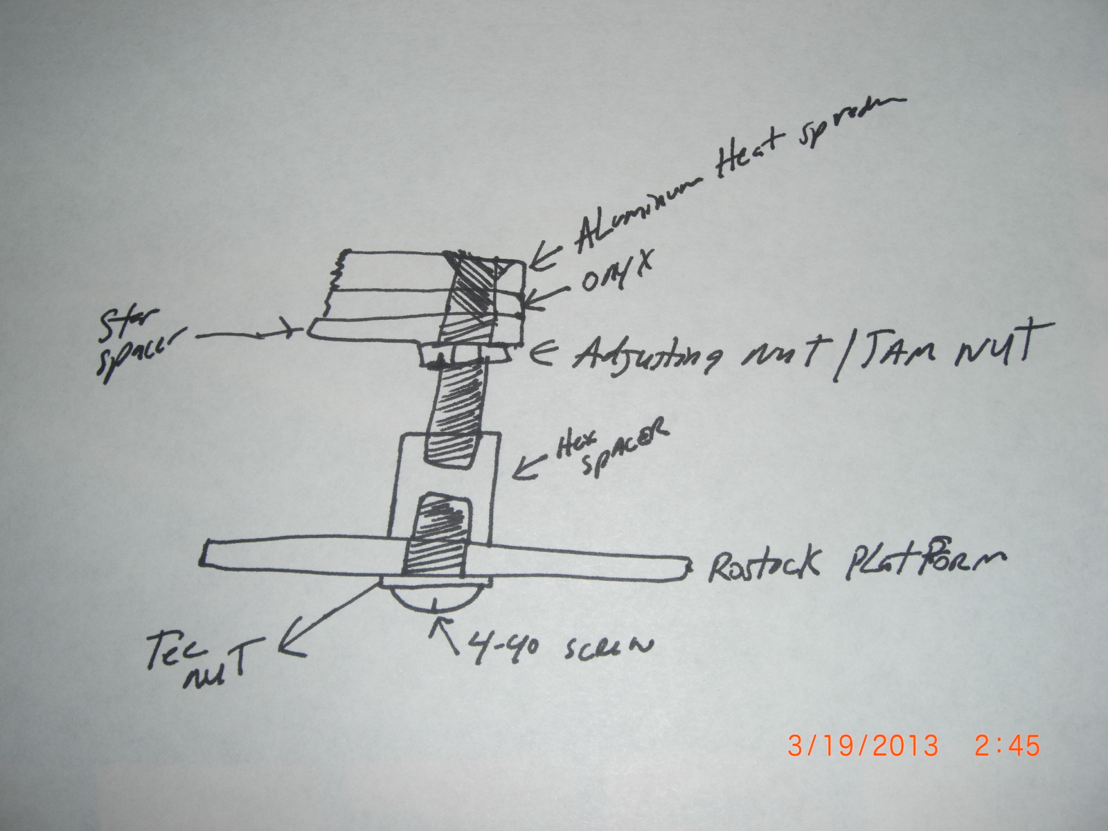

Today I decided to tackle an issue that I put off since i started working on the wiring.
After installing the build surface. It was not flat and seemed to have a bow in the middle. The aluminum that I was using as a heat spreader wasn't completely flat to begin with but I should have been able to flatten it out somewhat once I tightened the screws down but it actually got worse. I took everything off to check tolerances of the spacers they were all between 3.99mm and 3.97mm, I had two that measured over 4mm. To my surprise star spacer was also fairly flat.
This leads me to believe that the actual mounting surface of the rostock was the culprit and I need to solve this. I suspect its lies in how tight I have the frame assembled and the tolerances of laser cut parts.
I've been thinking of implementing some sort of bed leveling device to account for some of the inconsistency of the rostock frame.

Re: Another rostock max build
You could certainly do something like that, I have a similar setup on my MendelMax, if the bed itself isn't flat it won't help though.
If the surface is flat but not horizontal, unless it's miles out all that really matters is the head moves in the same plane as the bed.

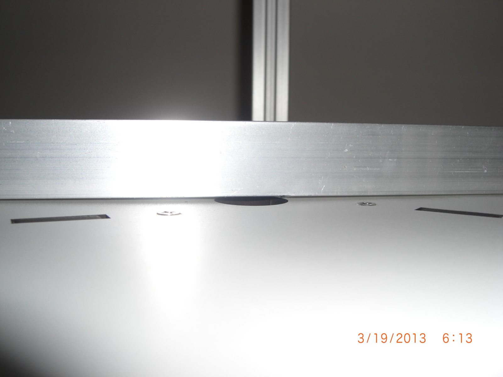

i tried to take photos of what im seeing. this is a straight edge on top of the platform. notice the gaps in the middle versus the outside ends.
edit: discovered later that the laser cut parts were out of alignment. seemecnc sent replacement parts.
That's a bit odd. Mine was dead flat on assembly. I would have thought all of those internal base partitions would prevent it from bowing like that. Are all the screws snugged up? How's the bottom?
everything is snug up even with the partitions which troubles me, because that means the laser cut parts aren't square.mhackney wrote:That's a bit odd. Mine was dead flat on assembly. I would have thought all of those internal base partitions would prevent it from bowing like that. Are all the screws snugged up? How's the bottom?
hmmm..
And what about the bottom, is it flat?
there is one spot that is out of place, shown in the picture, it seems this foot peg isn't touching the table, all the others are. its not the table because to matter where i rotate it. It doesn't touch. there seems to be a slight bow here at this spot. I noticed this before during the assembly but i didn't think this mattered. Everything is snug up to the partitions.mhackney wrote:And what about the bottom, is it flat?

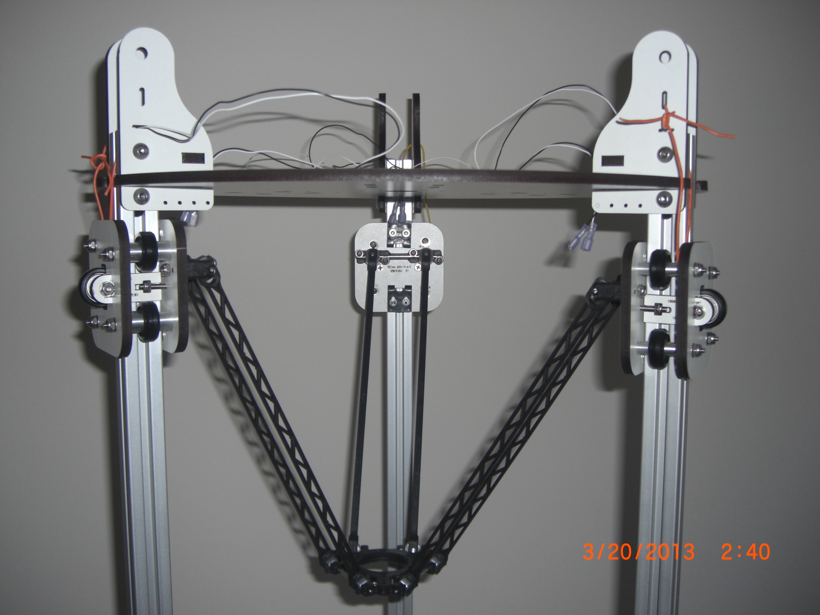

more work done today getting the rostock arms installed. This required an insane amount of sanding for a smooth fit. I can't tell you how many times I had to install, remove, sand and reinstall to check fit. definitely not installer friendly, I got to a point where I said enough was enough and just left them alone, I still think they could use more sanding for better, smoother motion. I started around noon and 3 hours later here's the result.
The hardware for my adjustable bed leveling idea came in today. Its nice to have mcmastercarr close by. I ordered the parts last night and they were here today.
more to come on this implementation, hopefully fixes my uneven rostock frame.
