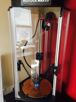

All the pieces are printed and I have finally been able to out it together.  Bought 1/2 longer stainless steel screws and attached the lower brackets.
I joined all the pieces of Lexan plexi-glass together with the flex-joints and then inserted all 5 panels (minus the door) in to the slots of the bottom brackets, then topped off each off with the upper brackets. Putting the top brackets were a bit of manipulation but overall quite easy (easy enought that I added the plexiglass and top pieces during a print and didn't mess it up) .  Now to attach all the upper brackets using the stainless steel screws I removed from the bottom.  Then the door.
 .  Now to attach all the upper brackets using the stainless steel screws I removed from the bottom.  Then the door.My 3D-Printing learning curve is asymptotic to a Delta's X, Y and Z-axes

Looks very nice! Just have to print the last pieces to hold the door shut

Ooooh I like that little copper bit there.

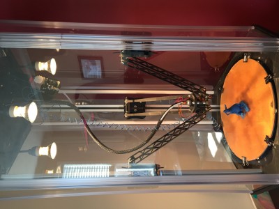

The printer is not as loud with the enclosure. As well, even though not closed up completely (need to finish the door as noted above) was 105 degree F. Will see how warm it gets after finishing the door.
I did also buy some GU-10 fixtures for some 50W halogens (http://www.amazon.com/gp/product/B00DPC ... UTF8&psc=1). I am planning to hang the halogens from the top for light and heat for the chamber. Have a dimmer for the halogens to control the amount of temp/light. As shown below I put the dimmer switch wired on the left side panel and will run and additional 110V cord to power the lights.
With the enclosure, I placed a conduit alone the back of the enclosure to run the power up from the dimmer to the halogen lights. Will also ultimately run wires up a second conduit I placed for a second extruder stepper....... if /when I set up a Cyclops or other.
Will attach some pic's in a bit.

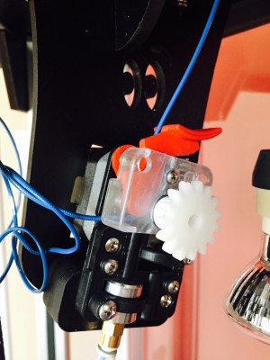

I found some 36 gauge copper on Amazon (http://www.amazon.com/gp/product/B0042S ... UTF8&psc=1). I cut this and use this between the heat bed and glass as a Heat dissipator. Also adding to the copper color is the PEI on the glass as my print surface. As most know this has been detailed awesomely by mhackney (http://forum.seemecnc.com/viewtopic.php?f=36&t=7452).drunkenmugsy wrote:Ooooh I like that little copper bit there.
I bought my PEI from amazon (http://www.amazon.com/gp/product/B0013H ... UTF8&psc=1). I love the PEI.
It all works awesome.

One step closer to finishing the enclosure.  Hooked up the Halogen bulbs which I essentually drop hung from the top.  Works awesome and I like the ability to dim the bulbs as in the attached pictures.  I do worry that one bulb is close to my extruder stepper.  Will need to watch and make sure it doesn't get too hot.   I will also need to watch the Lexan plexiglass but suspect it will be OK since Lexican is quite resilisnt.
Still need to finish the door with an "edge" to close the door against such that I have contact closure and thus "seal" the chamber a bit more tight. Then to print the handle, and black enamel paint the dimmer knob.

Looks very nice.

Let me know how the halogen bulbs work! That was one of my ideas for heat, it only takes about 100-200w to keep the enclosure warm.

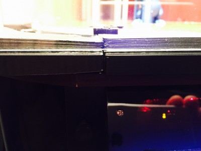

I did print them in ABS. As you mentioned many pieces printed over many hours. I printed the thicker bottom pieces over night and then started another when I went to work. Then printed the upper pieces after getting home from work. Took about 10 days since I was out of town for a couple of days.mvansomeren wrote:Looks very nice.
I was getting ready to print the enclosure supports as well and it looks like the larger pieces have a print time of over 3 hrs. each. How much time did you spend printing them - did you do it all in one shot or over a number of days (weeks)? Did you experience any problem with warping with the parts being so large? (I assume you're printing in ABS).
They were wide and there was a few pieces that warped a bit especially when the room was cold. Did reprint a couple and learned a brim helped hold them down as well as I set the bed with PEI at 100 degrees. A couple which did warp slightly did not effect alignment since that was at the overlap region as designed.
You can see the piece that is warped and with printing it upright the warp does not impact it much. I am curious if with the heated enclosure if there is as much warping.

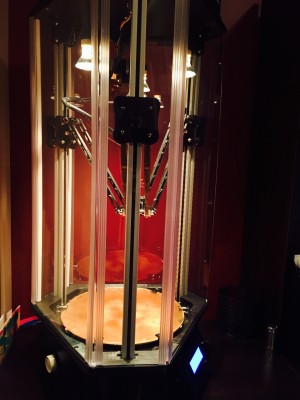

Sealed up the door edge and it is now 54 degrees C. Next to seal up all the holes in the top.

Wow that is really good! Have you compared temps near the build plate, top, and everything between?
To seal up holes, I temporarily used masking tape... Haven't changed it yet

I taped off all of the holes in the top with Kapton tape. I also taped off the X, Y and Z towers.  Thus, the chamber is fairly tight.
Started a print and waited for 30 minutes for the temps to stabilize. I had the Halogen lights at full power, the print bed was at 100 degrees C and the ambient room temperature was 25 degrees C.
Temps:
At the very top: 62 degrees C
At the level of the extruder stepper: 59 degrees C
16 inches above the print bed: 57 degrees C
12 inches above the print bed: 55 degrees C
2 inches above the print bed: 53 degrees C
Of note, the print I ran was a small "footprint/area." I could tell the the ABS was soft and with each layer was flexible. As the print area enlarged the ABS hardened.
I turned off the lights and will recheck temps again later.

Alright after the temps settled down here is the results with the halogen lights off.
Temps:
At the very top: 46 degrees C
At the level of the extruder stepper: 45 degrees C
16 inches above the print bed: 43 degrees C
12 inches above the print bed: 42 degrees C
2 inches above the print bed: 41 degrees C
Effectively was 12 degrees C cooler.
