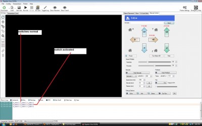

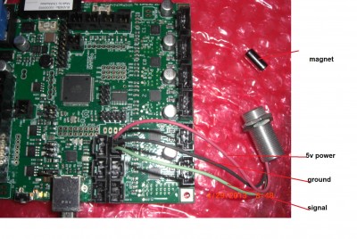

hall effect endstop/home switch testing success
Post by cambo3d »
this is really easy to set up, just change some values in firmware and its ready to go.
testing on the bench
proof

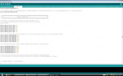

firmware setup

Cambo3D, you told me how to get the nylon lock nuts on backwards and by golly it worked! Thank you.
I would like to see how you mount those hall effect sensors, those little micro-switches are a real pain to line
up with the screw head, the holes for the screws seem to be in the wrong place. We really need an alternative
and I think your idea will be great. I am looking forward to seeing some pictures on what you came up with for
the mounting of those hall effects. You are always coming up with great ideas and I love to steal em. :P
Re: Another rostock max build
I have searched Ebay looking for those Hall Effect sensors you purchased. Would you mind posting your source for those?
cambo3d
Posts: 1057
Location: Florida
Post by cambo3d »
I got them from ebay awhile ago because they were selling them at a discounted price for this particular model. Ive had them in my electronics pile for quite sometime. here is the part number for it. 103sr13a-10.
note though: you can use almost any type hall affect switch, mine just has this fancy metal casing around it.
I am going to check out using the hall effect sensors that are about the size of a transistor. I think they would be easier to mount
and would fit the scale of the Rostock better. Place the hall effect sensor where the microswitch is now and maybe a small magnet on
the end of the screw. Just thinking out loud, if I come up with something I'll post it.

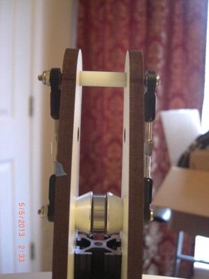

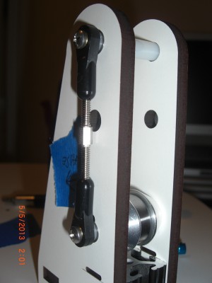

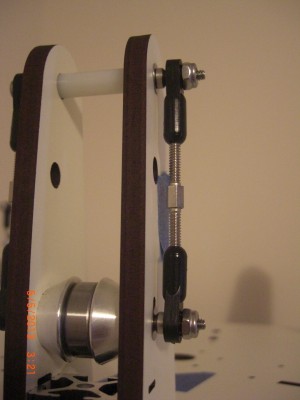

turnbuckle idea
Post by cambo3d »
so i finally found some heavy duty turnbuckles and ball ends that fit the stock screw sizes, here are the pics in comparison.
installed

Eaglezsoar wrote:I am going to check out using the hall effect sensors that are about the size of a transistor. I think they would be easier to mount
FWIW I think using a hall effects the magnet must pass by the sensor not move directly towards it.
You should read the datasheet for the sensor and look at how they recommend using it.
you can use it either way,

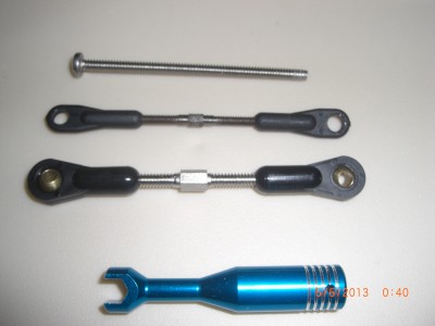

Where did you get you hands on those, hobby store? What's the blue one at the bottom?
cambo3d
Posts: 1057
Location: Florida
Post by cambo3d »
Flateric wrote:Where did you get you hands on those, hobby store? What's the blue one at the bottom?
that's my bling bling 5mm adjustment wrench :mrgreen:
im gonna gather up all the part numbers to the parts I used and post them up for you guys. along with the dxf file for the longer top support plates.
