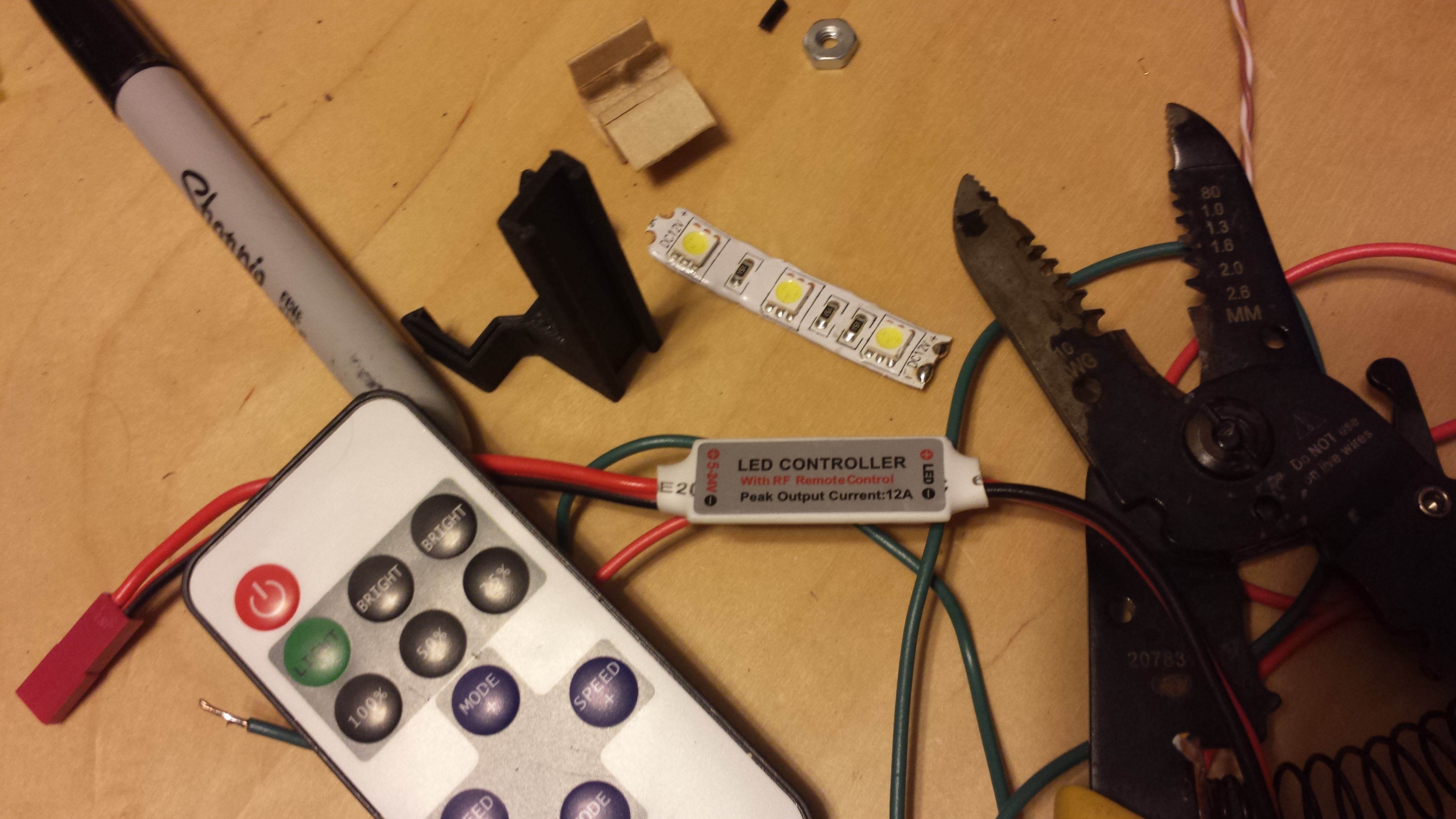

The LED controller and some 5050 LEDs. In the end I went with some 5730 LEDs instead. More light for the buck.
I used some CAT5 cabling to wire up the light on the X and Y towers. Both are connected to the RF LED PWM remote controller..

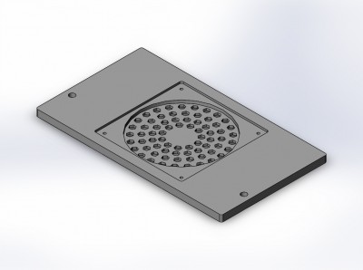

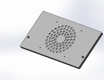

Knocked out the replacement side panel with fan mount in CAD tonight. Waiting for a 9 hour print to finish so I can give this a try and see if I can mount the new fans tomorrow night.

OK here are the files. I only have red PLA on hand and this is also my first ever print in PLA. But the panel looks great and everything lines up the way I wanted. This file is for adding 92mm fans in the Max V2 lower side panels. One file has the fan guard and one does not. I will post a few render images also so everyone know what it looks like. The fan mount screws are for a 6-32 screw.
This is my first print in PLA so be kind!  But here is the panel at about 47% or so.
Here are the files for the panel with a guard:

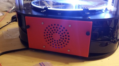

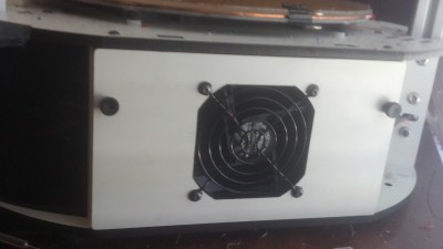

So my fan panel printed out great today. It was my first tall and thin print so I was excited to see it come out perfectly. I installed the fan at first pulling air into the base. I then noticed that my bed had a hard time getting to temp for nylon... I turned the fan around to pull air out of the base and the bed heated right up as before. Guessing the fan was blowing cold air up the hole in the middle of the base plate and cooling the bed too much. It is now pulling out nice warm air and keeping things nice and cool inside.
Nice print overall for a first ever PLA
Back side
Back side
Front side
Front side
All mounted. Thinking of doing other side in Nylon and trying a black die on it.
Tonight is the printout of the new LED holders... I did not like the ones I found so I redid them in Solidworks today and will print them out tonight while I work on the enclosure setup in CAD tonight. Also tomorrow the first LED idea for the print plate will arrive... My 5730 LEDs will arrive shortly so i will mbe knocking out the PCB ring for that this weekend I think. I think I have a thing for LEDs and lots of light where I work from being around my reef tank LEDs and being a photographer.. We tend to like light I guess.
Let me know if anyone needs a different size fan for panel, finds an issue or wants a tweak to the design. Always glad to help out where I can.

Those fan guard holes look much too small to allow free airflow. Unless you're running the fan at low voltage to slow it way down, you might want to make them larger, or switch to a lattice pattern. Otherwise you're likely to get more air noise and less airflow than you'd like.
Dan
Re: Rostock Max V2 build with a few upgrades from the start.
After looking at it mounted I have to agree with Dan, the holes are too small. The lattice would probably work best to have more open area rather than solid plastic.
The idea is to open it up as much as possible yet a small amount of lattice only to protect from youngsters from sticking their fingers in.

Yeah after seeing it in person I also can see that the holes might be a bit small. It is moving a good bit of air but I can see that larger holes or long slots would give more flow. Also working on an intake for the other side which is a little more low key. If it pans out I will post it for you guys to look at. I should have the new panel up by lunch time in Texas.

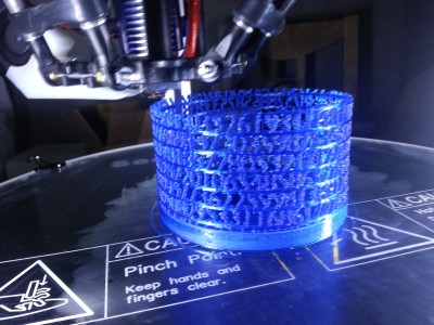

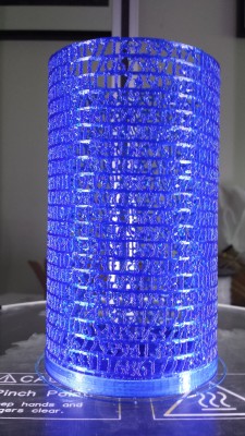

Tower of Pi start in T glase
The five hour print is going well for first T glase object.
All done. Not a huge fan of the way the T Glase came out on the numbers. But I know it is a settings / filament issue AND calibration I later found out.

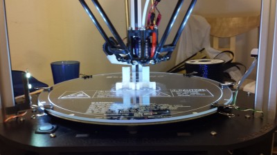

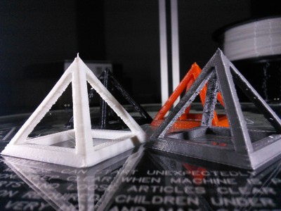

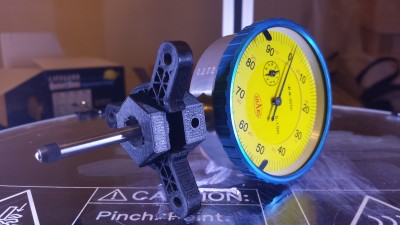

So when the hot end decided to flake out on me I decided to go ahead and re-calibrate the whole thing and this time try to do it right.
So this is my new BEST friend! I printed up the mount with the stock hotend in ABS and got to work.
All four spots were within a HAIR of of this so I called it good. When I first threw the dial on it was not fun seeing how far off the "paper method" had me. Which was my own fault I know.
Asdie from a TINY bit of stringing on a few parts, these are far better results than I was seeing before I used the dial.

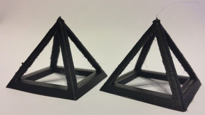

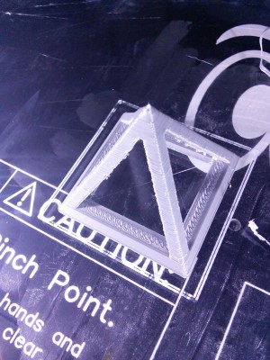

I have noticed a slight issue in my last two PLA test prints. The back left ( between X and Z towers) seems to bend in a bit. My other test print after hot end and calibrations changes looks fine, while these two have this same issue. Ideas of what I need to correct?
Front two have the issue. The back left leg bends a bit.  The red was down with V6 head. but the black on in the background is stock head after re calibration as are the foreground test and only the front two have the issue.

OK a few updates...
I threw together a nice new home for my new best friend in CAD the other night.
Box and insert for calibration dial.
All nice and happy in a safe new home. That old cardboard box HAD to go.
Beta panels for full build area enclosure fit check are all printed and everything fits perfectly!
I am now working on the upper fixture for the enclosure and the locking system to keep it all together without adding holes to the MAX. I should have more done shortly. Though I do have a few photo shoots to knock out in the next couple of days and also need to get hopping on my filament extruder this weekend. At the rate I am going through filament I am REALLY looking forward to getting that puppy up and running.
