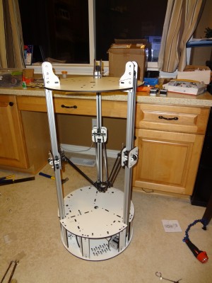

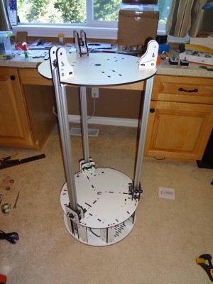

Finally got a chance to do some more building today! My son and I got the cheapskates installed. Fortunately for me, as I was scratching my head trying to figure out why we only had one 1.75" #6 screw left for the axel supports, he put it through one of the supports and realized that 1.75" was too short. So typo in the instruction manual (Gene B, if you're reading this, it's on page 66 -- the screw for the axels should be 2").
Cheapskates installed
Once we got those on and were pretty comfortable that they were moving smoothly, my son had to go to bed :-(
So I installed the belts:
Belt's installed
Belt's installed
And then I installed the arms and the effector platform. Yes, I cheated from having to do all that sanding by using the Trick Laser arms I ordered :-) I was actually planning on using the SeeMeCNC arms initially and then upgrading at a later date. I had even sanded the U-joints on the Cheapskates to have the universal joints spin freely. But when it was time to do the effector platform and I realized how much sanding I'd have to do (plus it was already late ;-)), I just decided to go straight to the Trick Laser arms. Man, they're nice! Installation was a breeze (I had bought the pre-assembled arms).
Here's where I'm at today:
Arms and effector platform installed
One more note on the assembly manual (I'll write these up for Gene separately when I'm finished in case he's not reading here): the manual on pages 79 and 80 refer to the sheet metal screws for assembling the platform as being 1/2". I'm 99% certain they're 1/4" -- at least that's what came in my kit and what I used :D
Hopefully we'll get the extruder (and more!) assembled tomorrow!

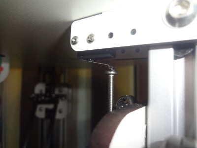

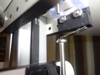

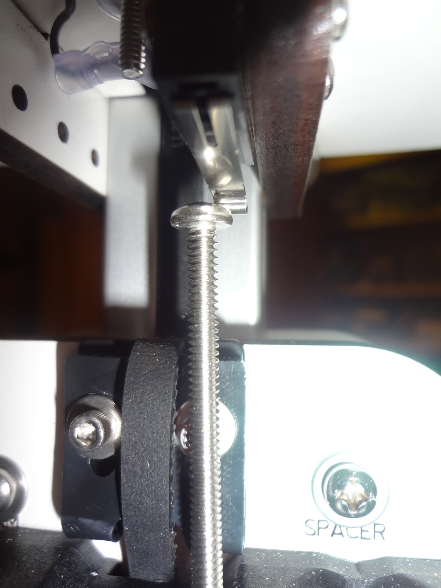

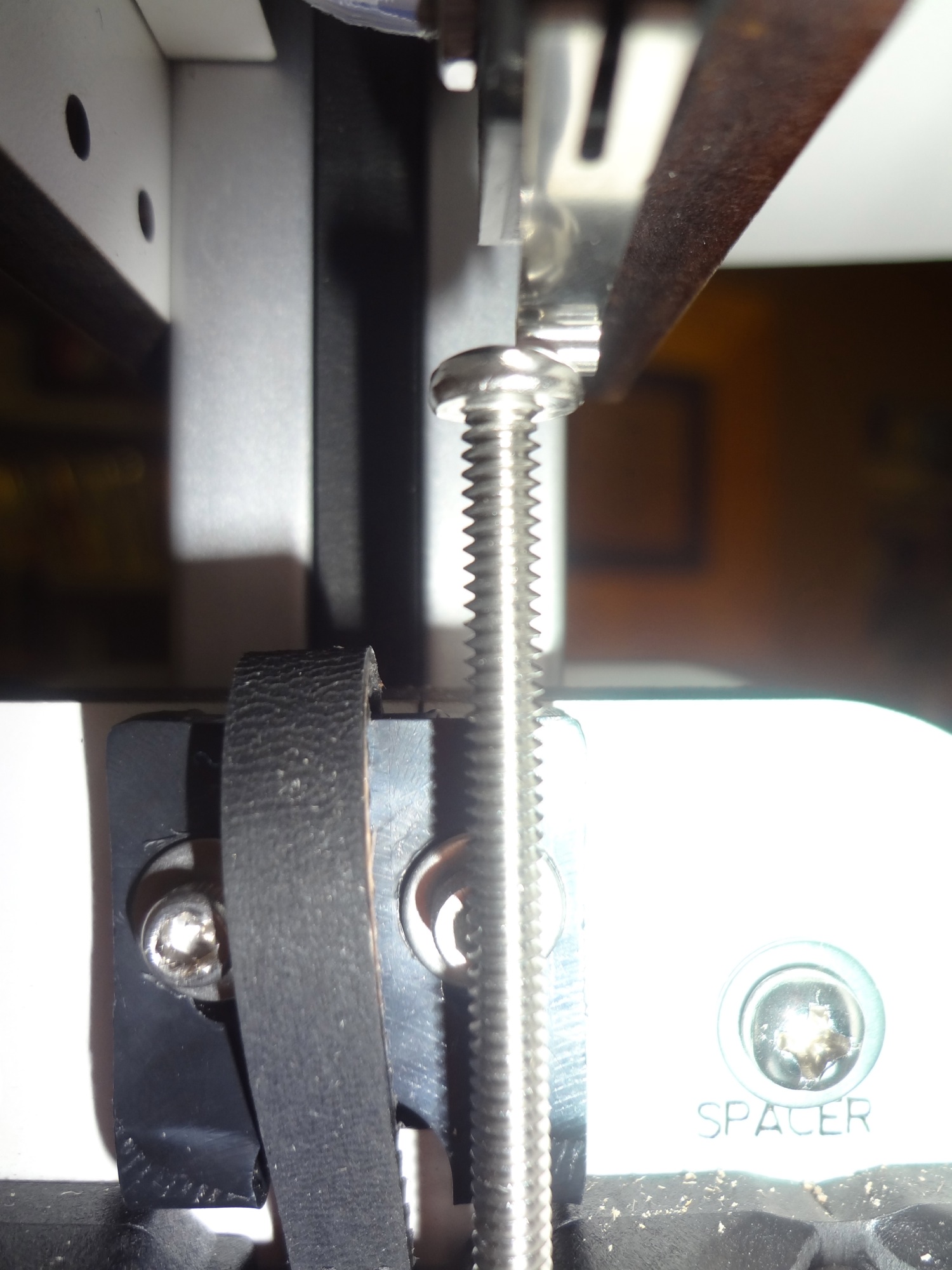

What should they look like? Here are pictures (sorry the Z is blurry -- hard to take these closeups :P).
X-axis end stop
X-axis end stop
X-axis end stop, side view
Y-axis end stop
Y-axis end stop
Y-axis end stop, side view
Z-axis end stop
Z-axis end stop
Z-axis end stop, side view
dpmacri
Posts: 314
Location: Beaverton, OR, USA
Re: dpmacri's Rostock Build
Post by dpmacri »
I went ahead and moved my end stop switches to the middle 2 screws where they mount. Now the end stop screws hit the switches right where the actual button is rather than out on the end of the lever. Now my height calibration seems to have stayed correct even after a cooling/reheating cycle.
I think I may have also made a mistake the first time around. Last time, I had issued G28 *before* I changed the EEPROM/Printer Settings values. I think that may have caused the printer to think it was at a different height.
Anyway, I'll report back if I still have height problems, but thanks for the help!
