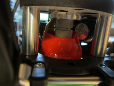

I discovered that I broke my extruder head. The (ceramic?) tube in the middle of it cracked and I suspect it was from one of the time the head was grinding into the platform.
When I went to put together my new extruder head, I decided not to use the RTV silicone this time. I just used silicone tape for everything and it came out great. One benefit is that you don't have to wait for it to cure and can put it straight into use. I even wrapped the resistors in a little bit of the silicone instead of using Aluminum foil. The tape seems to also deflect the 25mm fan's output away from the end of the head and onto the part that needs to be cooled. I should have taken pictures of it as I was putting it together but here is the final product.
