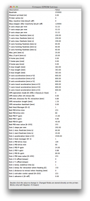

Repetier Firmware
Ok, I grabbed the Repetier firmware that Halopend posted. Fired up the Arduino 1.0.3 on my Mac, loaded it, turned off using the EEPROM (so I can tweak/control completely from the code for now), compiled and uploaded.
Then I connected in Repetier host and the 3 axis work properly! I can jog around and home. However, Z axis jogging is painfully slow. I looked through the Configuration.h file and all 3 axis have the same MAX feedrate. I presume that applies to the individual axes motor - which are labeled X, Y and Z but are not actually cartesian coordinates. Is conversion from delta to cartesian lowering the federate? I have no experience with delta printers but I'll browse around in the code and see what I can see.
The heated bed is still not working. However, I do not have my hotend or hotend thermistor hooked up so maybe that fault is preventing the heated bed control from working.

All axes are moving 1/2 as far
Well, I actually measured a 10mm movement in X and Y and it appears that they are only moving 1/2 the distance too (about 5mm).
So, the issue seems to be on all 3 axes. I enabled eeprom so I could verify settings. I've attached a screenshot here. Does anyone notice anything odd? It looks fine to me.
Problem solved!
Turns out that the 1.1 Rev of the RAMBo is 16 micro steps. I don't know how long this version has been out but it is what came with my kit. Simply changing:
#define MICRO_STEPS 16
in configuration.h solved the problem and I am now working on calibration.

Z Calibration
These delta printers are a LOT easier to calibrate in Z and level than a cartesian printer.
First I set the Z height at 0,0,0. I moved the head using G0 X0 Y0 Z10 to make sure I didn't crash into the glass. Then with a sheet of paper (I use cigarette rolling paper - an old machinist trick, it is about .001" thick) under the nozzle I click down 1 mm at a time. In my case, I hit Z=0 before the nozzle touch the paper. So, I increased my X, Y and Z max lengths to 370 mm (a guess but I wanted them to be longer than the actual tower travel) in the Repetier firmware's configuration.h
#define X_MAX_LENGTH 370.0
#define Y_MAX_LENGTH 370.0
#define Z_MAX_LENGTH 370.0
Then I ran down to z=10mm again and clicked down 1 mm at a time until I was within a mm and switched to .1mm clicks. As I moved the paper back and forth under the nozzle, I clicked the .1mm button until the nozzle just touched the paper - you can feel it snag slightly. I looked at the Z display and it read 5.4mm. This means that the printer thinks the nozzle is 5.4 mm above the table glass but it is actually at 0. So, I simply subtract 5.4 mm from 370 in the config file:
#define X_MAX_LENGTH 370.0 - 5.4
#define Y_MAX_LENGTH 370.0 - 5.4
#define Z_MAX_LENGTH 370.0 - 5.4
This gives me Z=0 at the center of the table. I homed and went to Z=0 (G0 Z0) several times and checked with the paper to make sure it was correct and repeatable.

Auto Tuning the Hot End and Heated Bed
The Repetier firmware has an auto tuning command for determining the values (Kp, Ki and Kd) for the PID algorithm. The PID algorithm (proportional integral derivative) is a control mechanism with a feedback look that can manage the heating elements very effectively.
In Repetier, the M303 command starts the auto tune. Here is the command syntax:
- M303 P<extruder/bed> S<drucktermeratur> Autodetect pid values. Use P<NUM_EXTRUDER> for heated bed.
If P is left off, P=0 is assumed - which is normally the hot end. S is the target temperature and should be the temp you would normally want to maintain. So for ABS, 200°C on the hot end is a good target. For the heated bed, 100°C is good. Make sure the device is at room temperature before running the auto tuner.
I ran: M303 S200
After running the auto tune on my hot end, the last set of K values were used to replace the defaults in configuration.h:
/** P-gain. Overridden if EEPROM activated. */
//#define EXT0_PID_P 24
#define EXT0_PID_P 14.91
/** I-gain. Overridden if EEPROM activated.*/
//#define EXT0_PID_I 0.88
#define EXT0_PID_I 0.59
/** Dgain. Overridden if EEPROM activated.*/
//#define EXT0_PID_D 80
#define EXT0_PID_D 93.85
(when I change values in configuration.h I like to comment out the original default and create a new line for my value. That way I can always go back to a known state).
To calibrate the PID for the heated bed, I ran: M303 P1 S100
I also realized that my extruder steps per mm were off by a factor of about 2 (againd due to 16 microsteps for the version 1.1 RAMBo.) So I changed it in the configuration.h:
//#define EXT0_STEPS_PER_MM 292
#define EXT0_STEPS_PER_MM 584
