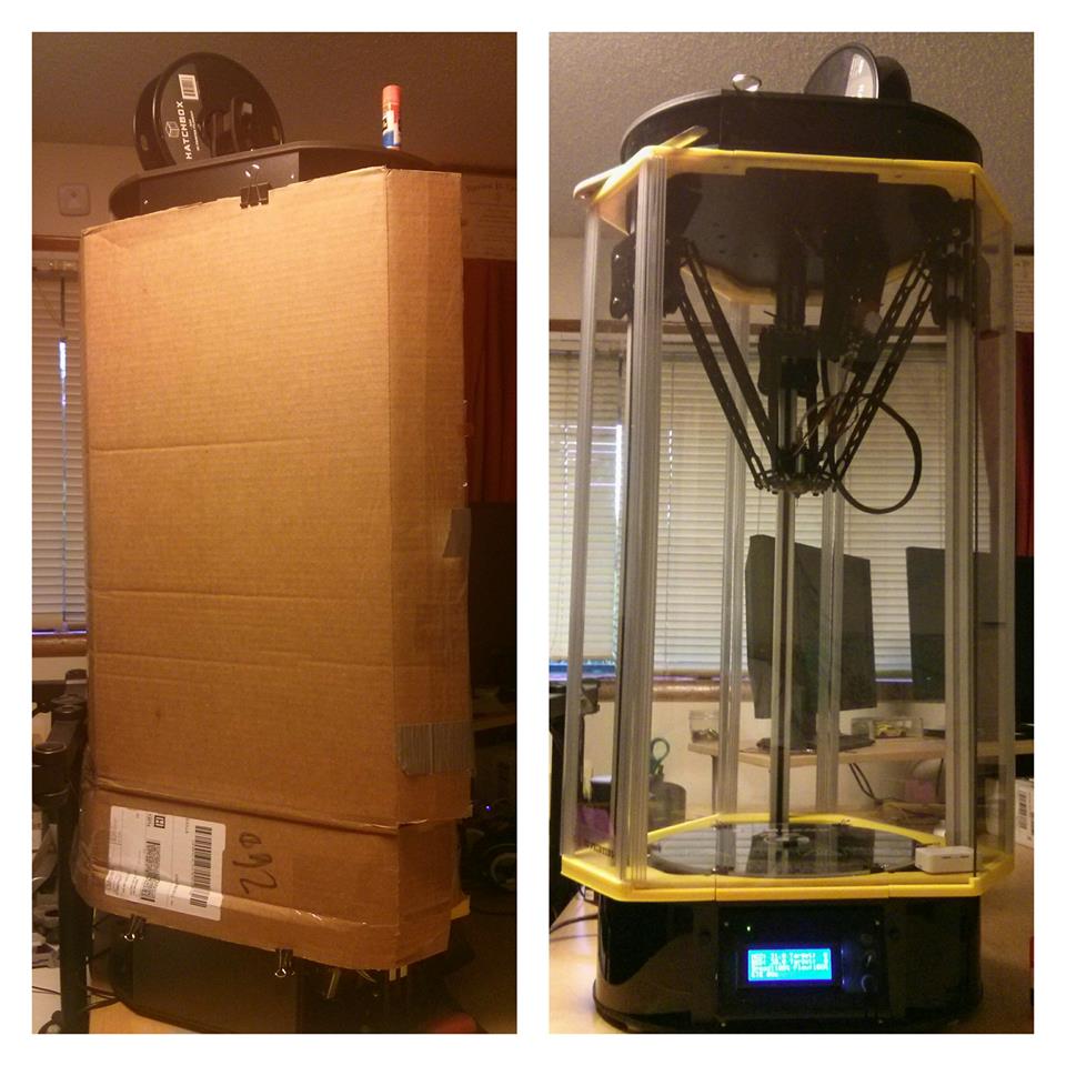

I would suggest a few things as this happened to me on a few of the test pieces that I made. First make sure you can a calibration print satisfactorily. I have attached the circle test that I use.
Second because this is a big heavy print you want to more grip on the ABS. Heavy parts will have a higher tendency to curl as they cool. The short reason is the rate of cooling, too fast it will break in order to cool evenly. Thus the need for an enclosure.
I did two things to combat these issues. First, I used an acetone slurry (always over polyimide/kapton tape, if you break your glass you will be sad
) Second, I created a make shift "enclosure" in the interim to keep the parts warmer longer as they cooled.
My first enclosure vs my second enclosure.
