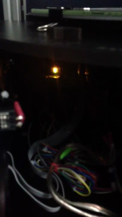

Were you able to get the board to turn on by plugging it into the USB port? Were you able to get Repetier-Host program to make a serial connection to the RAMBo board?
It's possible to plug motors and heaters into the RAMBo one-at-a-time to test things out.

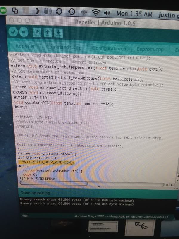

Are you sure that your firmware downloaded correctly? Did you upload to the Rambo with the Windows version of Arduino and with Repetier host disconnected? I'd be somewhat concerned with how well the USB driver would work on a Mac through a Windows 7 VM. It sounds like the firmware was correctly loaded beforehand or else I would say that may be the cause of the LCD issue. The LCD starts up with just the blocks on a couple of the rows before the firmware accesses them.
I've used a Mac for Repetier Host and you don't need to install a USB driver for the Mac version. I found it fairly easy to set up, although the UI isn't the same as the Windows version. If you want I can send you screen shots of the printer settings on my machine.

Yes I uploaded the all windows versions of repetier host and arduino into the W7virtual machine. I also downloaded the zip file for the repieter max firmware.

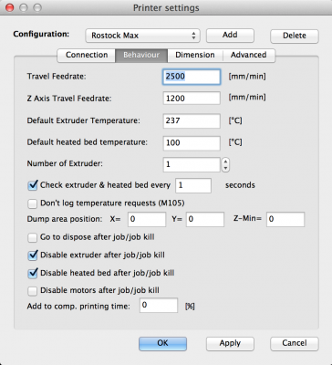

That would be awesome I'd love to see those settings one thing I noticed that was immediately different with the Mac UI was that the Mac UI when I'm connected does not show the manual directional arrows what would cause that?

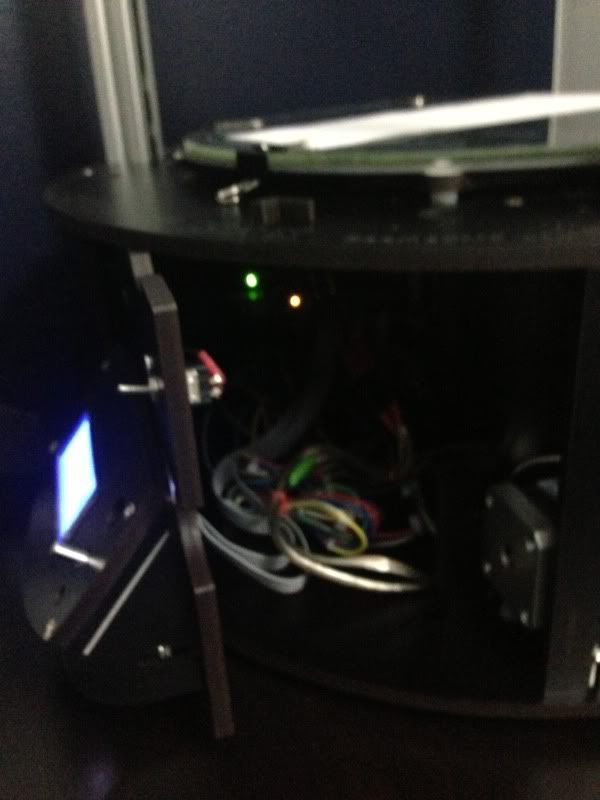

As for my LCD it hasn't worked since I finished hooking everything up. It's showed the the blocks consistently. Even when I was controlling the printer with computer the LCD never worked

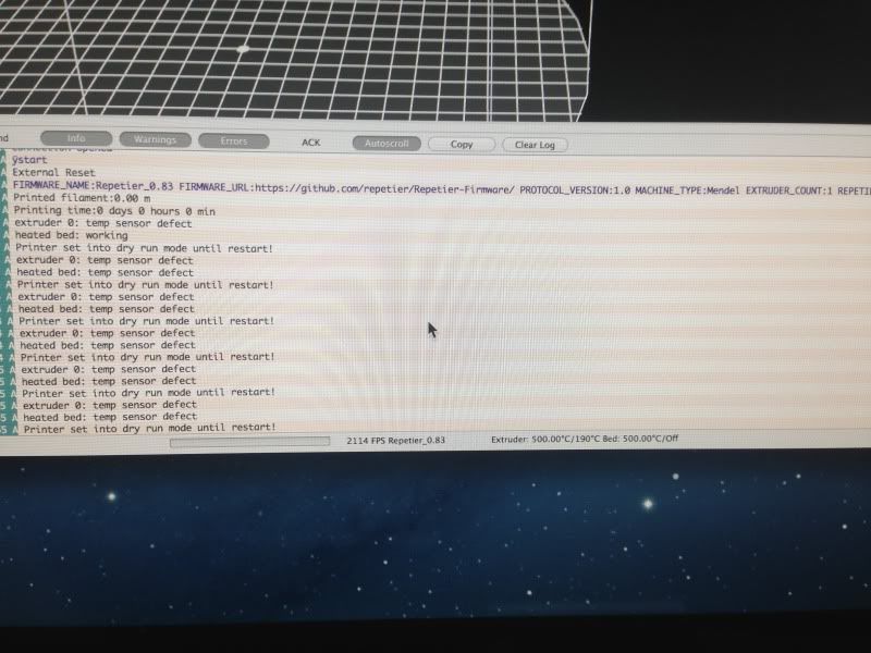

Some photos of what I'm looking at if it helps. ill also put up a vid of when I connect to the printer
Video
http://i292.photobucket.com/albums/mm22 ... 25327a.mp4
[img]http://i292.photobucket.com/albums/mm22 ... af7e35.jpg[/img]
[img]http://i292.photobucket.com/albums/mm22 ... 1cffaf.jpg[/img]
As you see here if I click on heat bed or hotend it automatically reads the max temp we set

The other thing I would check is to make sure the cables aren't upside down when plugged into the Rambo. I understand some of the newer LCD kits don't have keyed sockets and you have to make sure the key on the cable connector matches the marking on the PC board.tc3jg wrote:

I meant incorrectly uploaded to the Rambo using the Arduino development environment. I noticed your Arduino IDE displays "Done Uploading" which is what you would see after a successful upload. I wonder if its an incompatibility between the newly uploaded firmware baudrate and the Repetier Host baudrate. I haven't had an issue with that but I've seen other posts about that issue. Can you view the EEProm through Repetier Host once connected?

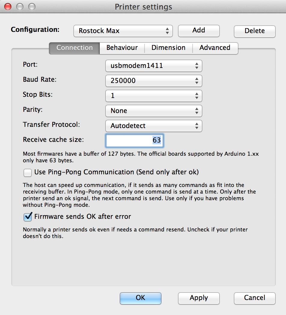

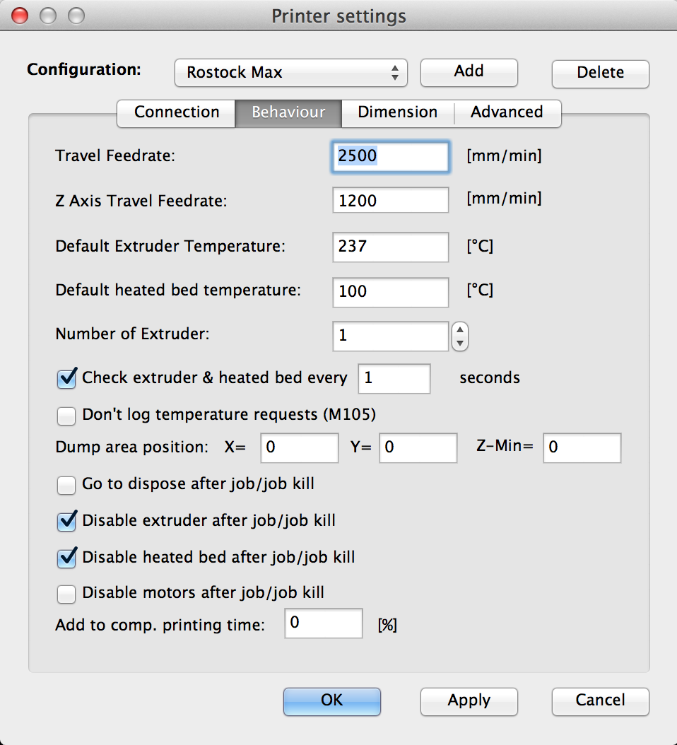

Here are my settings. You probably want a lower default extruder temp if you are using the stock hotend (I am using an E3d all-metal hotend):

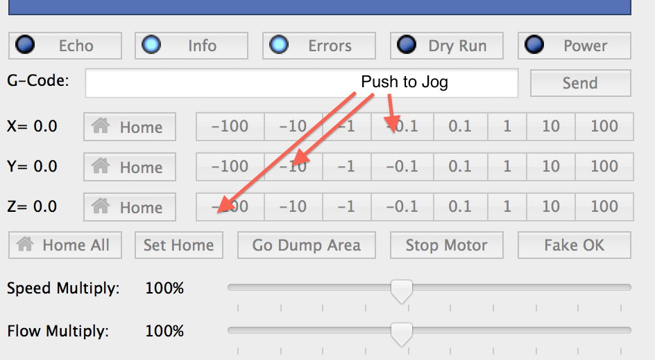

The Mac version does not have directional arrows- you push on the buttons on the print panel to jog in each axis As for my LCD it hasn't worked since I finished hooking everything up. It's showed the the blocks consistently. Even when I was controlling the printer with computer the LCD never worked

PS LCD is still out I tried to reverse the ribbon cables plugged into the adapter which connects to the Rambo. No dice.

Glad you got it working again. No, uploading while open to the configuration.h tab should work fine.tc3jg wrote: Now perhaps this is where I was messing up. I made the changes in the configuration.h tab and then uploaded while still viewing that tab could that have been the problem?

With the LCD I was asking you to check the way each cable plugs into the Rambo to make sure the keys on the connectors line up with the markings on the PC board if you don't have shrouded connectors on the PC board. Were you able to do that? Here is a thread where this was discussed: http://forum.seemecnc.com/viewtopic.php ... 47&p=14920

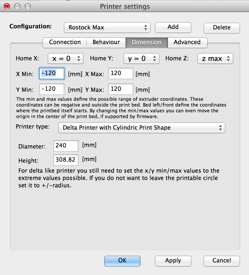

Well if its not one thing its another. started to try and fine tune my distance from the heat bead when my hot end on one of my tests started slamming into the bed. then I check my eeprom settings and I find this
[img]http://i292.photobucket.com/albums/mm22/tc3jg/ScreenShot2013-07-17at124858AM_zpsc6ae4c52.png[/img]
WTH happend to my max values? it appears my Z doesnt even exist!

I'd reflash the firmware and bump the value that enables the EEPROM in configuration.h.tc3jg wrote:Well if its not one thing its another. started to try and fine tune my distance from the heat bead when my hot end on one of my tests started slamming into the bed. then I check my eeprom settings and I find this
The odds are you have bad values in the EEPROM.

Which value enables eeprom?
not Printer radius is it ? because ive changed that to a large number to try and stop the burring in my heat bed to no avail
#define EEPROM_MODE 1
I think Polygonhell was saying make it 2 or another non-zero number besides 1 and it will reinitialize EEPROM when you upload the firmware.

1. My LCD is still bad I resoldered the connections. I really think its me that I messed it up. How doi check it with the volt meter?

As far as the LCD is concerned, I would look at the connectors that plug into the Rambo and cables and make sure none of the pins are shorted to
other pins. Also make sure all pins are soldered, beyond that ensure the cables are plugged in correctly by referring to the assembly manual. This
is one of the areas that has caused users the most problems and there is no easy solution. Do you have a friend who is good with electronics and
soldering? Have them take a look at the connectors and they could possibly spot a problem that has been eluding you. Good luck and you will
eventually get it working!
