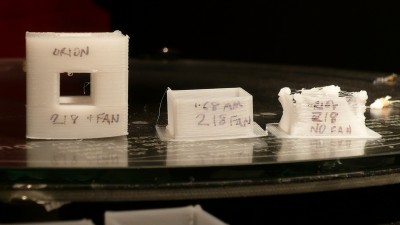

I have printed a couple of boxes and 1/8th of an owl.
Corners look slightly better, but the raised, blobby corner issue is still there.
The nozzle grates over the raised blobs of corners or tight curves.
this compounds into artefacts that spread upwards into the print.
Thanks to everyone for help getting Repetier firmware running!

On GeneB's Advice I have done some test prints with the orion quickstart slic3r ABS settings here:
http://download.seemecnc.com/orion/quickstart/#/23
This is a vast improvement.
For a successful print I find that the print cooling fan MUST be on...
Without it I get the usual mush.
It's interesting to see that the "official" Orion ABS settings use a print cooling fan.
I have been told many times to never use a print cooling fan for ABS - but it still seems to be essential to me.
And maybe it is OK if SeemeCNC are issuing settings that use a cooling fan for ABS?
Thanks again to everyone. I'm seeing progress..
