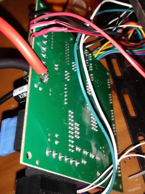

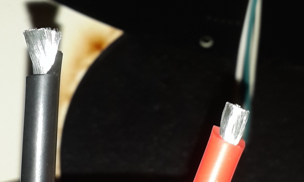

I had some noodle wire that I had bought for various projects including this one. Noodle wire is silicone coated and has many strands so it is very very flexible. You can wrap it around a pen with ease.

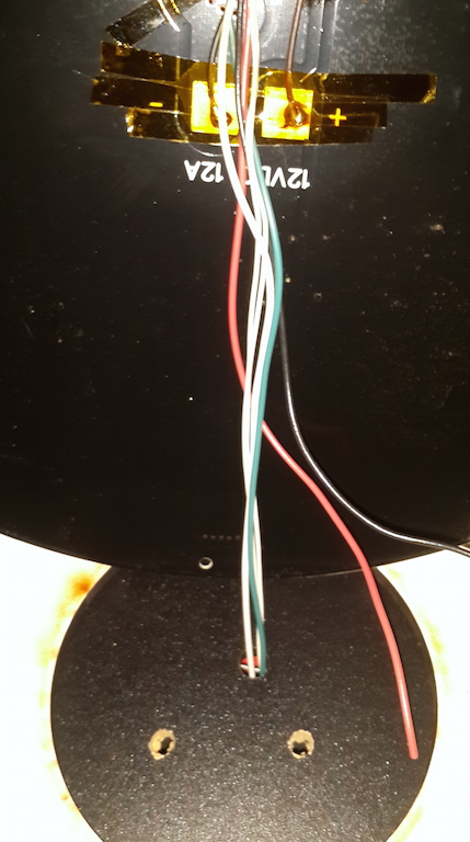

This wire is fairly thick (it is 10AWG) so you need to drill 2 more holes (or one big hole) to fit them through. The holes look bad, but after i vacuumed the holes, it took away all the debris and they became pretty presentable holes. :)

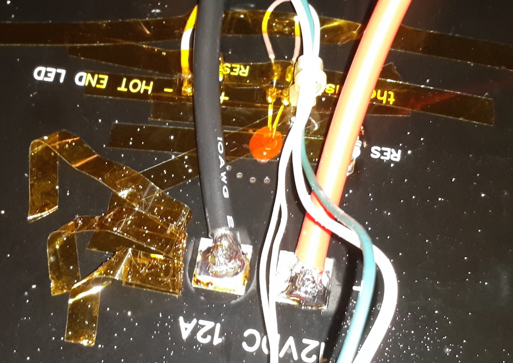

Then I removed the old wire (that had become fairly brittle) and I soldered on the 10AWG wire.
The wire is too thick to fit inside the rambo connectors, but with a pair of small scissors I trimmed some of the strands and made it fit the connector on the rambo.

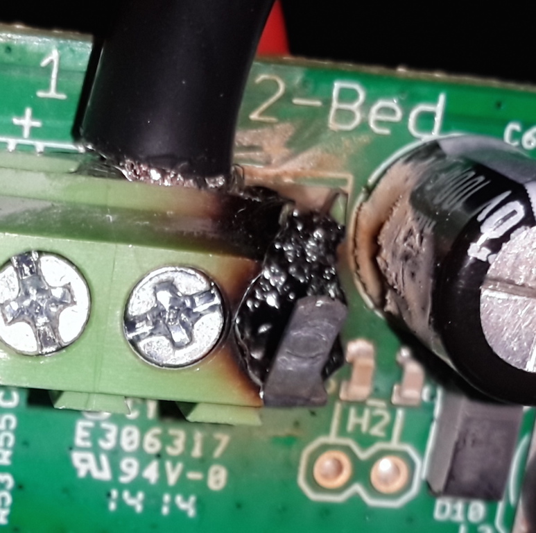

My other connector was fried because of what i suspect was a loose connection. I had to solder the wire to the back of the board.

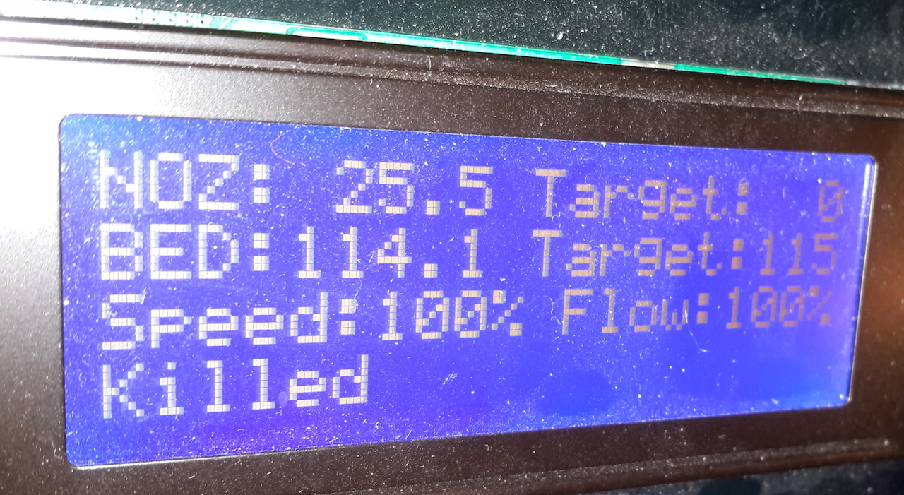

Now the bed heats up nicely. The performance is not quite the same as the 24V supply, but it is much faster. With my tshirt on the bed i was able to reach 115 degs in about 10 minutes.
The with the stock psu , I was measuring 11.38V at the input of the rambo board. And 11.07V at the output to the bed. Without the glass as an insulator on the bed the max temp i got was 87 degs.
The resistance of the bed was about 1.5 Ohms at 100 degs and 1.3 Ohms measured at room temp.

Yes it is overkill.
10 Awg can handle 35 amps.
12 awg, 25.
I would have used 12awg but i did not have any at hand. If one was using a 24v power supply, 12 awg would be good to have on there.
being thicker is not a problem, but if the wire was 12 awg, i believe i would not have had to trim a few of the strands off.
